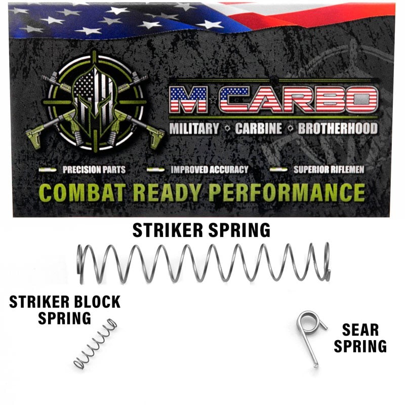

WHAT'S IN THE KIT:
  • 1 - Custom Lighter P365 Sear Spring
  • 1 - Custom Lighter P365 Striker Spring
  • 1 - Custom Lighter P365 Striker Block Spring
