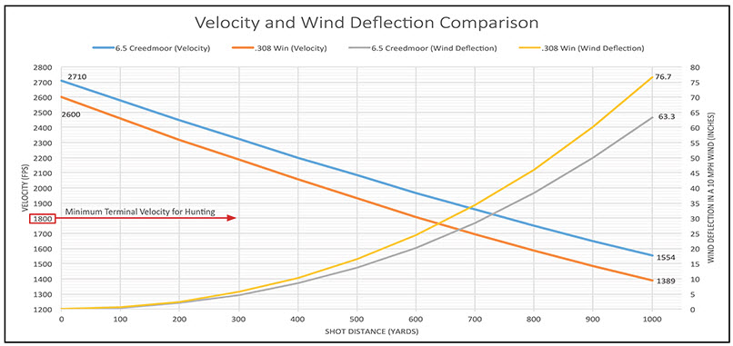

Comparing the 6.5 Creedmoor and the .308 over 1,000 yards:
The 6.5 Creedmoor was designed to challenge the .308 Winchester in long-range shooting. Given the .308's popularity, it's intriguing to see how the 6.5 Creedmoor measures up to this renowned military round at 1,000 yards.
Due to the 6.5 Creedmoor's Higher Ballistic Coefficient is has way less wind deflection when compared to the .308 Winchester at 1,000 yards.
At 1,000 yards, it's evident that the 6.5 Creedmoor has significantly less bullet drop than the .308 Winchester. Moreover, due to its higher ballistic coefficient, the 6.5 Creedmoor has much less wind deflection compared to the .308 Winchester at this distance. The Hornady 6.5 Creedmoor 140 grain A-MAX, for instance, has a ballistic coefficient of .585 and a muzzle velocity of 2710 FPS.
For those who grew up believing that velocity is paramount, these numbers might not seem remarkable. However, in the era of laser rangefinders and advanced drop compensation, ballistic coefficient becomes crucial for hitting distant targets.
In comparison, the Hornady .308 Win 178 grain BTHP comes with a G1 Ballistic Coefficient of .530 and a muzzle velocity of 2600 FPS. At 1,000 yards, the 6.5 Creedmoor displays 110 inches (about 9 feet) less drop. In a 10 MPH crosswind, the 6.5 CM also experiences about 13 inches less wind drift than the .308. So, not only is the 6.5 CM more accurate, but it also provides a more comfortable shooting experience due to its lesser recoil.
