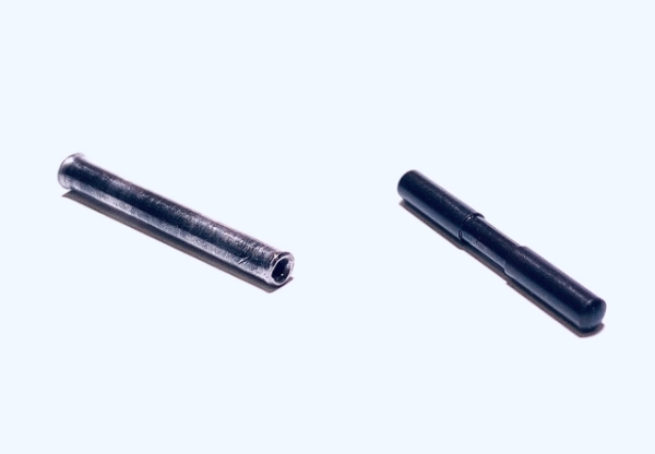

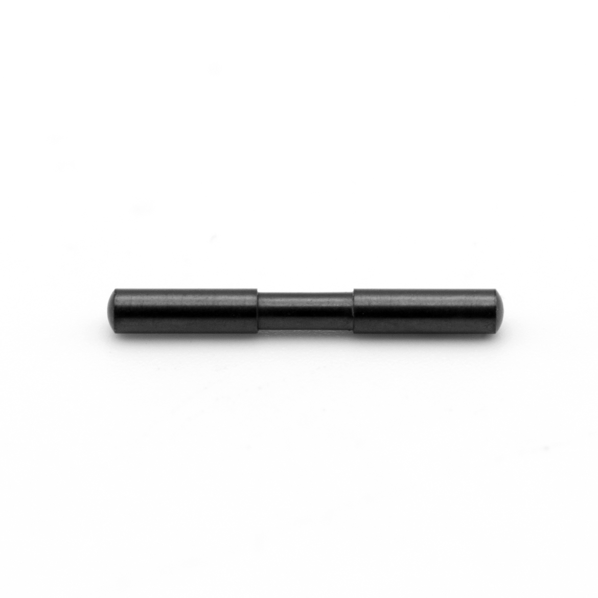

  • Experience a lifetime improvement with the CZ 75 Floating Trigger Pin, a superior alternative to the hollow factory pin.
  • Precision CNC machined from S-7 Tool Steel and hardened to RC-50 for enhanced durability.
  • Features a premium black oxide finish.
  • Unlike the factory pin, this trigger pin can be removed and reused an unlimited number of times, ensuring longevity.
  • Acts as insurance against malfunctions that can be caused by the factory hollow pin.
  • Compatible with all metal framed CZ 75 models, including 75B and BD, Shadow 1 & 2, all SP-01’s, P-01, PCR, CZ-97B, and BD.
    • *Does not fit Omega Series, Tactical Sport Series, or RAMI.
Upgrade your CZ 75 with M*CARBO’s Floating Trigger Pin and enjoy a lifetime improvement over the standard hollow factory pin. This custom trigger pin is precision CNC machined from S-7 Tool Steel and hardened to RC-50, ensuring ultimate reliability and a design that withstands the test of time.
Boasting a premium black oxide finish, the M*CARBO CZ 75 Floating Trigger Pin stands out with the ability to be removed and reused an unlimited number of times, a feature not available with the standard factory pin. Consider this upgrade as an insurance policy against potential major malfunctions caused by factory hollow pins.
This versatile pin is compatible with all metal-framed CZ 75 models, including various clones such as CZ 75B, 75B Compact, 75BD, 75 B/SA, 75D PCR, 75 pre-B, 85B, 85C, 97B, 97BD, Shadow 1 & 2, all SP-01’s, P-01, 40B, and 40P.
*Please note, it does not fit Omega Series, Tactical Sport Series, or RAMI.
Elevate your CZ 75 with peace of mind, knowing that this meticulously machined trigger pin is crafted to last a lifetime. Whether you’re looking for a CZ 75 SP-01 Upgrade or a versatile accessory, the MCARBO CZ 75 Trigger Pin is a testament to enhanced reliability and performance. MCARBO specializes in custom CZ 75 Parts, offering you top-notch accessories designed for a lifetime of dependable use.
This upgrade replaces factory part number 6.  See CZ 75 Exploded View Here.

Nice upgrade
Easy to install, looks sturdy compared with the hollow pin. It just float in its place which it seems weird at first glance. But it works fine.
Thanks a lot
Great part. Much better than the factory roll pin. Makes it much easier to remove the trigger or change the trigger spring. And I bet I don't get my punch stuck in the frame ever again.
