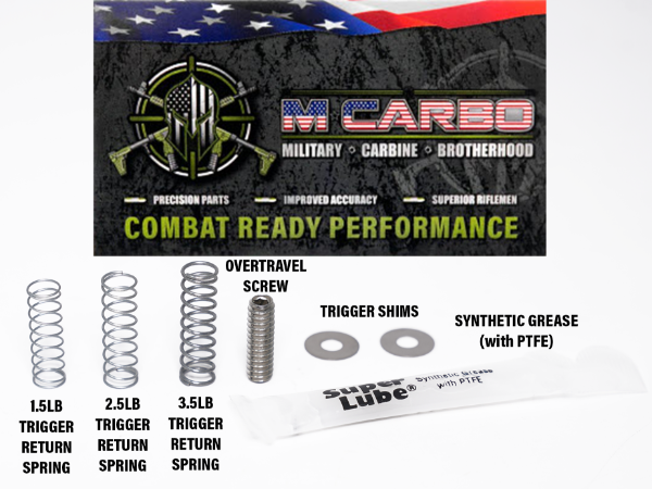

WHAT'S IN THE KIT:
  • 1 - 1.5lb Trigger Return Spring
  • 1 - 2.5lb Trigger Return Spring
  • 1 - 3.5lb Trigger Return Spring
  • 1 - Stainless Steel Overtravel Screw
  • 2 - Stainless Steel Trigger Shims
  • 1 - Synthetic Grease w/ PTFE

  • Some triggers were made without a thread in the trigger return spring hole (hole furthest rearwards on trigger)
  • If your trigger is not threaded this kit will not work
  • Reduce your trigger pull from an average of ~6lbs to your choice of ~1.5 lbs, ~2.5lbs or ~3.5lbs (Average results can vary +/- 1lb)
  • Enhance both accuracy and overall performance for your Savage AXIS
  • Achieve a 40% reduction in trigger pull
  • The Pro Kit includes a Savage AXIS Trigger Spring Kit along with all stainless steel hardware
  • Compatible with Accutrigger models. Not compatible with the Savage EDGE model.
  • Comprehensive aftermarket trigger upgrade for your Savage AXIS rifle
WHAT'S IN THE KIT:
Savage AXIS Pro Trigger Kit
Enhance your Savage AXIS rifle with the best aftermarket trigger upgrade! Our comprehensive Pro Trigger Kit includes a Savage AXIS Trigger Spring Kit along with all required stainless steel hardware. It also comes with synthetic grease infused with PTFE for smooth operation.
Achieve a significant reduction in trigger pull, lowering it from an average of ~6lbs to your choice of ~1.5lbs, ~2.5lbs or ~3.5lbs. Up to a 40% reduction in trigger pull!
The kit offers three options for trigger return springs, allowing you to tailor the level of trigger pull reduction and drop test ratings:
  • 1.5lb or 2.5lb Trigger Return Spring: Ideal for benchrest shooting, these springs provide the maximum trigger pull reduction. Note that they have limited drop test rating (3", 6", and 9" only).
  • 3.5lb Trigger Return Spring: Suited for hunting, this spring offers a substantial yet safe reduction in trigger pull and has an unlimited drop test rating (3", 6", 12"+).
The Pro Trigger Kit is compatible with aftermarket Boyd's Stocks or any other aftermarket stocks for your Savage AXIS rifle. It also works with the factory stock, offering additional clearance in the trigger assembly due to a specialized overtravel screw. (Compatible with Savage AXIS models equipped with an AccuTrigger. Not compatible with the Savage EDGE model.)
Additional features include custom 300-series stainless steel shims that eliminate side-to-side play in the trigger housing. The included synthetic grease with PTFE not only aids in shim installation but also ensures a smoother trigger pull.
Savage AXIS Resources:
If you're getting the Savage AXIS Pro Trigger Kit, then you might find the following Savage AXIS Resources useful in further enhancing your firearm. Download the Savage AXIS Owners Manual or use the Exploded View of the Savage AXIS Parts Diagram.
Savage AXIS Owner's Manual
Savage AXIS Exploded View
The Savage AXIS Pro Trigger Kit is protected by the M*CARBO No Hassle 100% Lifetime Guarantee.
Drop Tested and Approved:
Savage AXIS Pro Trigger Kit is drop Tested according to SAAMI Standard Z299.5 rating (12" & 48").
The Savage AXIS Pro Trigger Kit has been tested repeatedly to ensure reliable operation and safety.
American made Savage AXIS Pro Trigger Kit is designed and manufactured by Combat Veterans. We will donate a portion of your purchase to the Military Foundations we humbly support.
