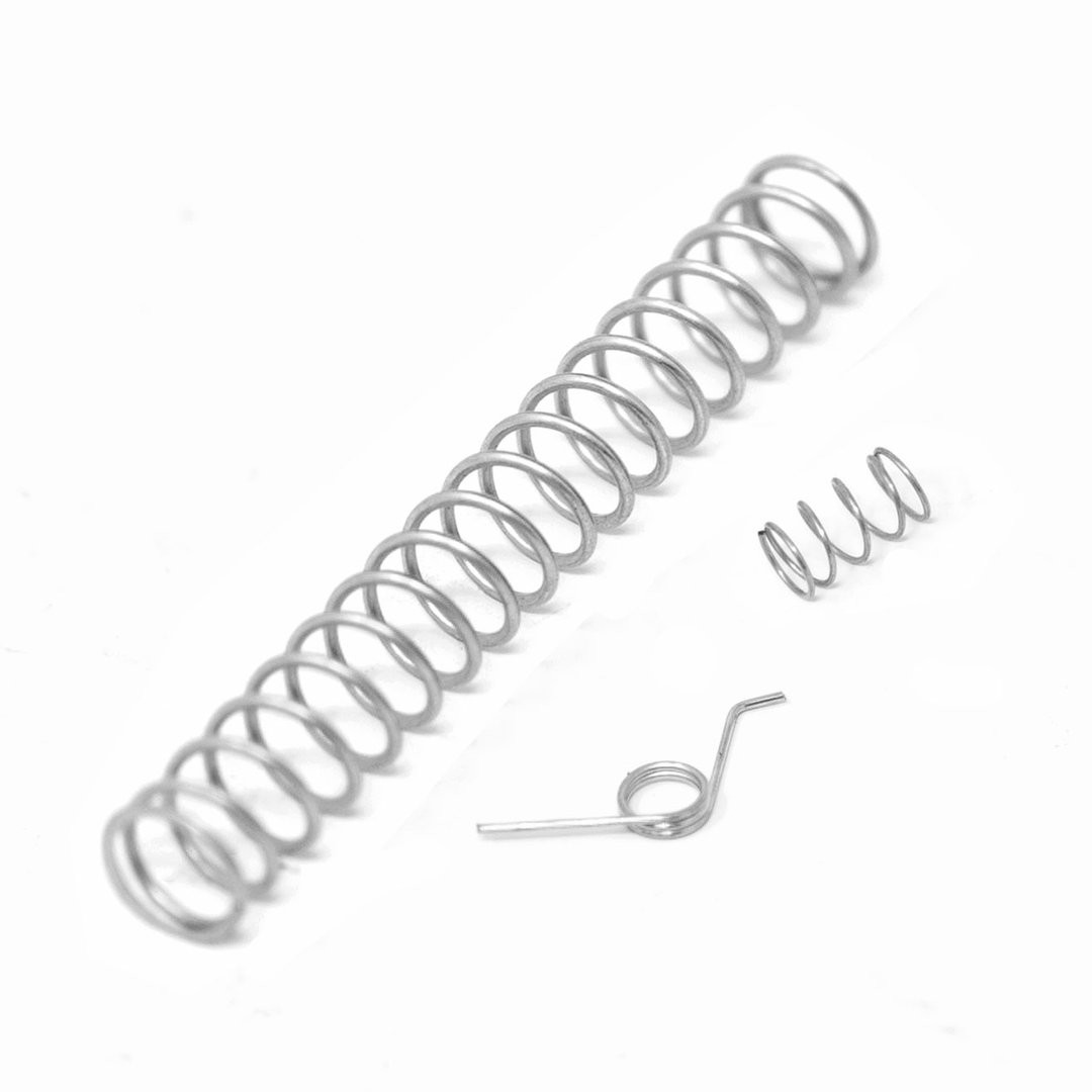

- 1 - Custom Lighter Sear Spring
- 1 - Custom Lighter Firing Pin Spring
- 1 - Custom Lighter Firing Pin Block Spring
