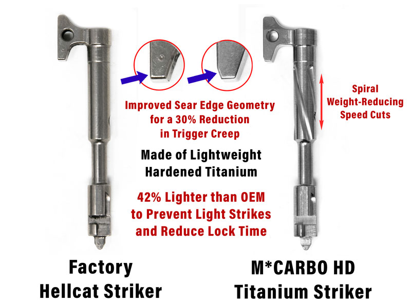

  • Precision CNC machined Titanium Striker for Springfield Hellcat, designed to reduce lock time.
    • Addresses and prevents light strikes and primer drag often experienced with the OEM Striker.
  • The ONLY fully assembled Striker Assembly Upgrade available for immediate performance improvement!
  • Our Titanium Striker is 42% lighter than the Factory OEM Striker, enhancing responsiveness.
  • Improved Striker Lug Geometry reduces Trigger Creep by 30% for a smoother experience.

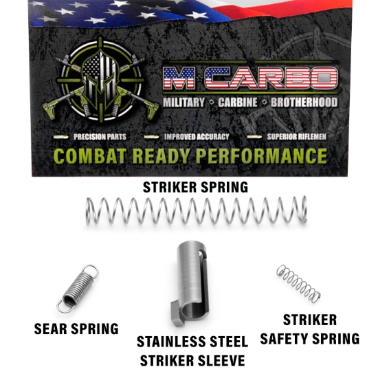

  • Package includes our Springfield Hellcat Trigger Spring Kit!
    • Replaces the Plastic OEM Striker Sleeve with a more durable 17-4 Hardened Stainless Steel.
    • Custom Lighter Firing Pin Spring
    • Custom Lighter Sear Spring
    • Custom Lighter Striker Safety Spring

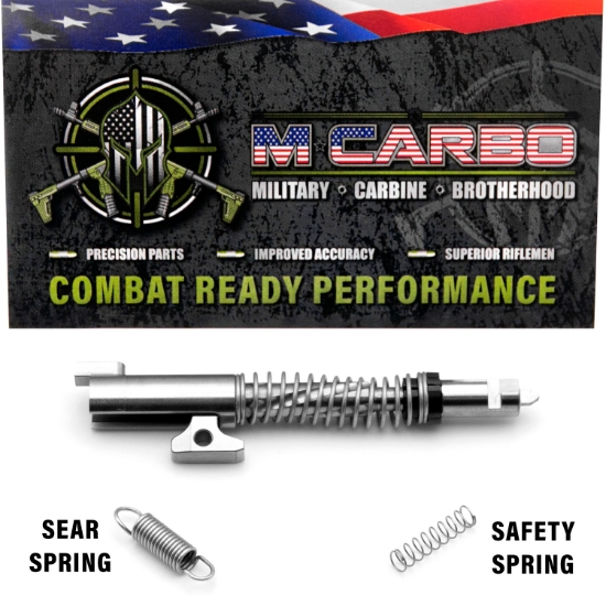

    • The sear spring has to be installed when assembling the MCARBO Hellcat striker assembly to obtain a functional firearm.

WHAT'S IN THE KIT
  • 1 - Precision CNC Machined Springfield Hellcat Titanium Striker Upgrade (compatible with 9mm and Hellcat 380 / .380 ACP variants)
  • 1 - Complete Springfield Hellcat Trigger Spring Kit (includes sear spring — required for proper function)
  • 1 - Precision CNC Machined 17-4 Hardened Stainless Steel Striker Sleeve
  • 2 - Hydrodynamic Hellcat Striker Assembly Cups
Installation reminder: both the sear spring and firing pin/striker spring in the kit must be installed to achieve a functional firearm. After installation on a Hellcat 380/.380 ACP, conduct a complete function check including safety checks, trigger pull measurement, and live-fire verification if applicable and legal in your jurisdiction.

Experience a notable 30% reduction in trigger creep with the improved striker lug geometry of our Springfield Hellcat Titanium Performance Striker Assembly.
Compatible with Springfield Hellcat Micro-Compact models, including Hellcat 380 / .380 ACP variants.
Springfield Hellcat Titanium Performance Striker Assembly Labeled Graphic - compatible with Hellcat 380
While the sear engagement remains more than that of a Glock, our assembly is drop-safe and has undergone rigorous drop-testing to a modified version of SAAMI Z299.5-2016, ensuring reliability and safety.
M*CARBO Springfield Hellcat Striker Upgrade - Factory Comparison - compatible with Hellcat 380
M*CARBO’s lightweight Titanium Striker for Springfield Hellcat is your optimal solution to mitigate the common primer drag associated with the OEM Striker.

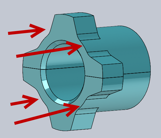

Our custom striker spring cups feature enhanced hydrodynamics. This design allows water, if entered into the striker channel, to flow past the striker spring cups, ensuring smooth functionality even in damp conditions.
Springfield Hellcat Hydrodynamic Striker Assembly Cups - compatible with Hellcat 380
For those who engage in extensive dry-firing, the use of a Snap Cap is recommended. Additionally, we advise including your dry-firing in your live fire count to ensure all springs and pins maintain top condition.
