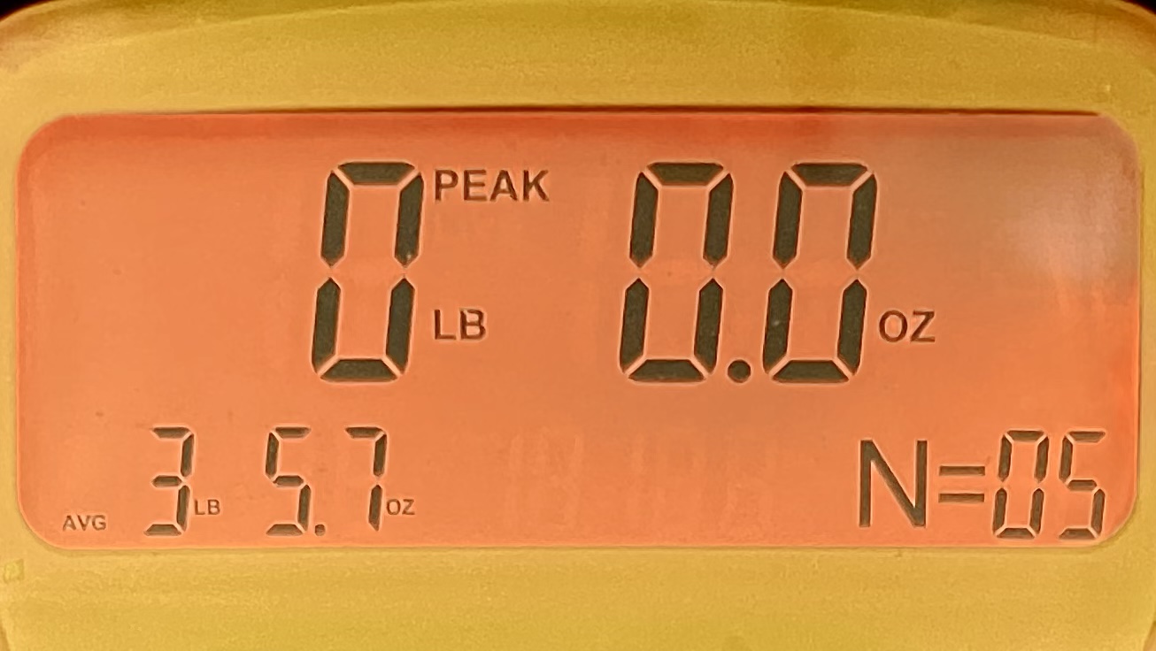

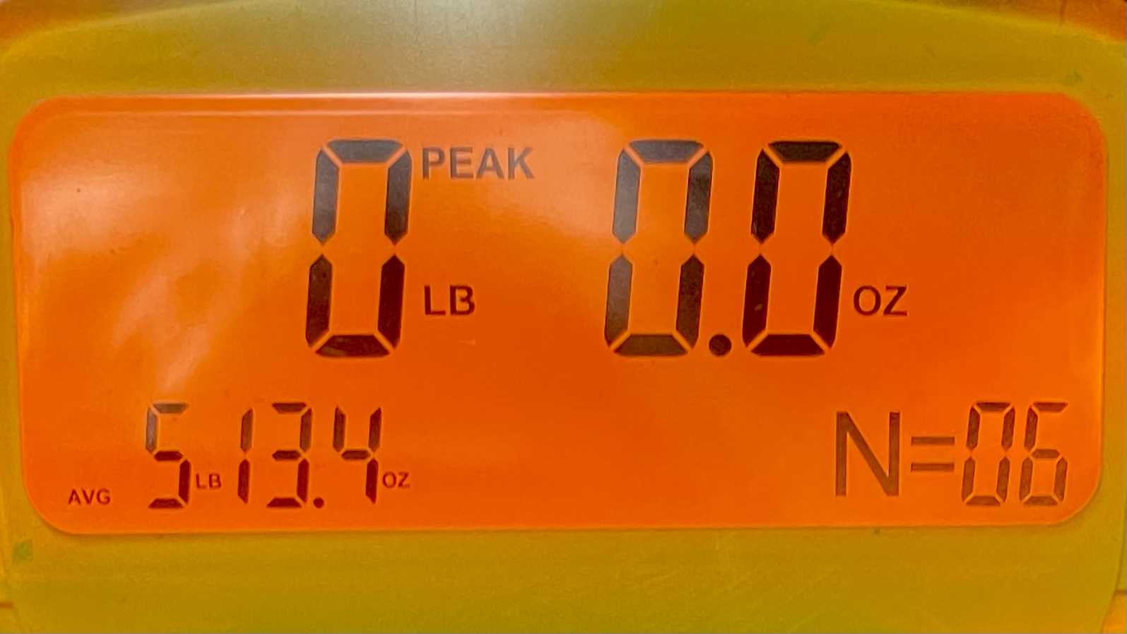

Before installing these new springs and trigger, my trigger weight average after 5 pulls was 5lbs. 13.4oz. Now it’s 3lbs. 5.7oz. … and I haven’t even taken it to the range to break in the springs yet!
