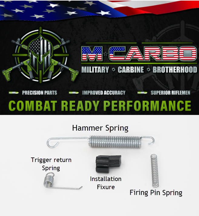

Ruger LCP MAX Trigger Spring Kit Maximize your shooting performance with our Ruger LCP MAX Trigger Spring Kit. This ultimate accessory can significantly reduce your trigger pull from an average of ~7.0lbs to around ~5.75lb (results can vary up to...

With all the upgrades, it significantly improved the pistol. IMO use the 12lb spring, the 10lb one is too light for carry and doesn't feed all types of ammo. The 12lb spring gave me an average trigger pull in the mid-4lb range. The upgraded trigger can be set to have almost no travel, which was my issue with the stock gun. It also has a more noticeable reset than the stock trigger. It eliminates the annoying metallic "ping" sound when dry firing as well. From a non-gunsmith (but someone who tinkers) the video provided by this company is easy to follow. Make sure you buy the correct loctite and punches before disassembling the gun though. Just spend the extra money and get everything, feels like a pro tuned performance center gun now. Also, if you are replacing the recoil spring, make sure to put the original INNER spring back into the gun. The stock gun uses 2 recoil springs and the upgrade is only the outer spring.

Excellent product. Made a significant improvement in trigger pull (much lighter and smoother). The 12 lb. hammer spring also eliminated the pronounced "clink" from the stock spring when dry firing. I am inexperienced at gunsmithing work, so it took me considerably longer (1 hour) than the video to make the upgrade. The only difficulty I had was reinstalling the chassis in the frame. Inserting the trigger end first wouldn't allow the rear of the chassis to seat. After numerous tries, inserting the rear of the chassis first, then the trigger end did the trick. Haven't tested the firearm at the range yet. But based on my positive experience with M*Carbo thus far, I don't expect any problems.

I've bought a LOT of MCarbo parts over the years and have never been disappointed. They know what they are doing and as an example, including the 10# AND 12# spring set is a great idea. In my case I tried the 10# and found it wouldn't ignite the hard S&B primers. The 10# spring worked with other brands with softer primers but I swapped the 10# for the 12# spring.
MCarbo tech support confirmed this and told me the factory hammer spring is 15#.

Easy to install. The 10lb hammer spring yielded many light primer strikes… installed 12 lb hammer spring and no more light primer strikes. Did reduce trigger pull enough to be noticeable with 12lb spring. Did reach out to MCarbo support and they responded promptly. Overall very satisfied with this purchase.

My pistol went from almost a 7 lb. trigger pull to 4 1/2 with a smooth take up and minimal reset, or as little as an LCP can get. I used the 12 lb. hammer spring after reading about light strike issues with the 10 plus a 2 1/2 lb. trigger is too lite for pocket carry. Overall I couldn’t be happier with the setup.

As others have said, I suggest using the 12lb hammer spring. The 10lb spring makes for a lighter a trigger pull than I like to have for a pocket pistol, and rarely caused a light strike (only on loads with particularly hard primers - the majority of loads I tested worked 100% of the time). The 12lb spring is right on the money - smooth every time and no issues, ever. Another great set of offerings from M-Carbo.
