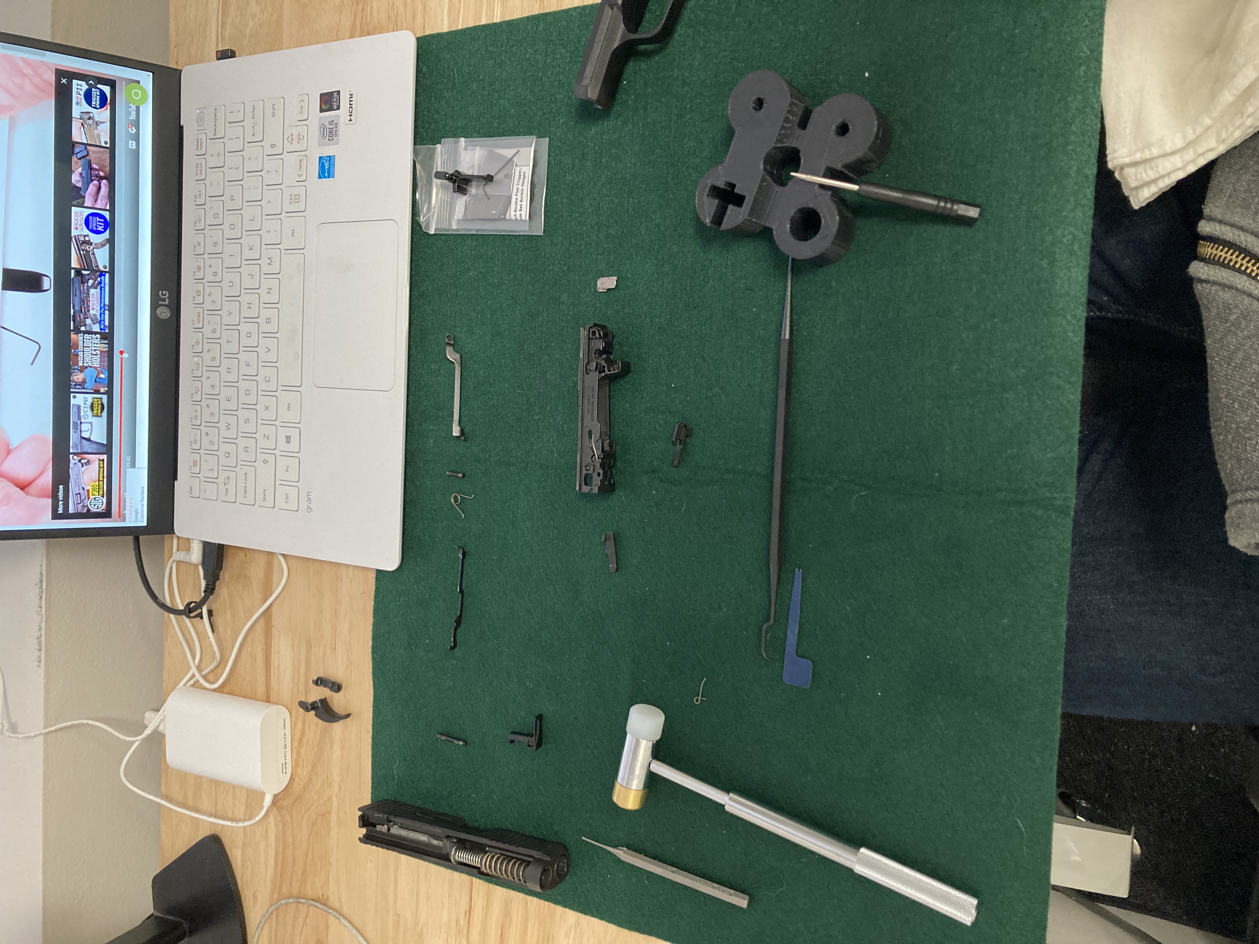

I purchased the trigger and spring kit for my Sig Sauer P365X. It took about an hour and a half to install since I had never disassembled and reassembled the fire control unit. There are many helpful videos online. Take it step by step and listen to the tips and tricks offered by the instructors. I like the solid machined trigger better than the stock metal injectection molded trigger. I am pleased with the upgrade and saw positive results at the range. Less lower left of bullseye patterns.

No experience with any gunsmith type work in the past. Purchased a few tools from this site to assist with the process. Took me awhile but I was also replacing the SAS controls with standard Sig slide stop and take down lever.
