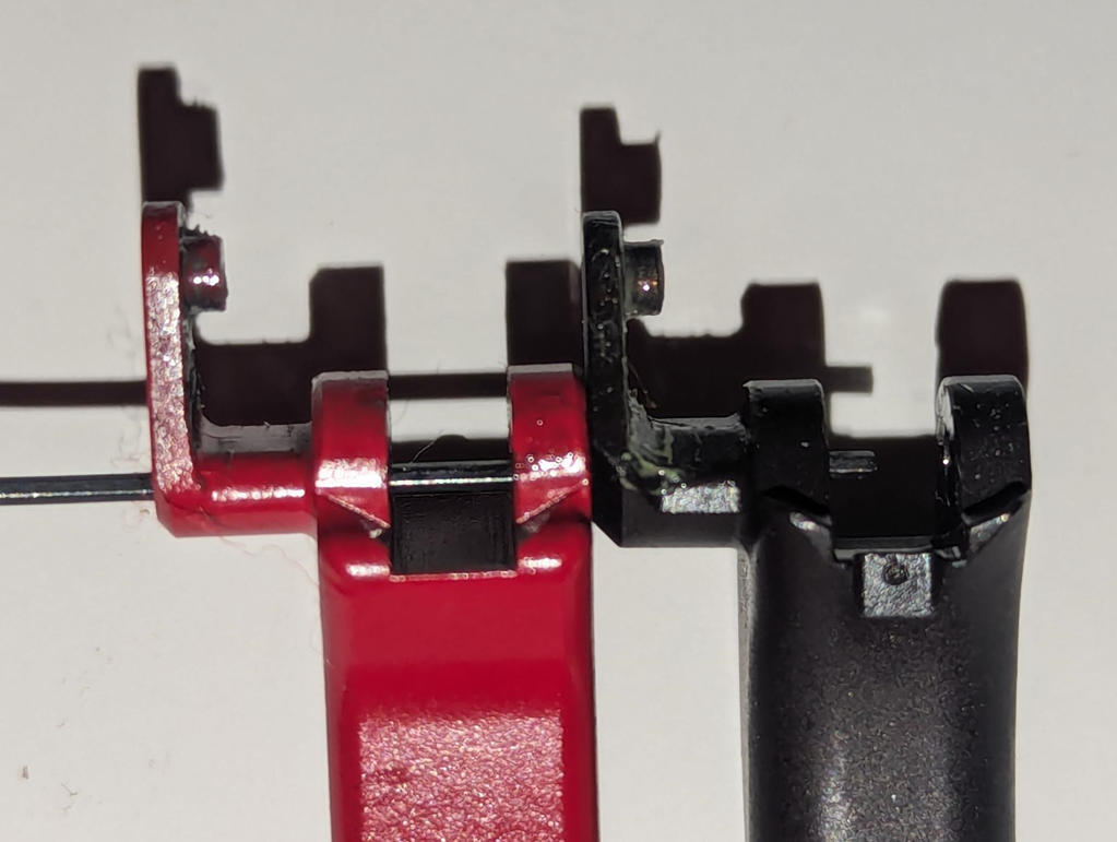

This is "0" stars until the milling is finished. Once corrected, I anticipate a 5 star review. It has taken a bit of troubleshooting to identify the issue with my P365 flat trigger. As you can see from the image of the stock P365 trigger and the M*CARBO trigger, "this" M*CARBO trigger is missing the notch that allows the trigger to move all the way forward. If the trigger cannot go all the way forward, the safety lever sits "proud" blocking the slide during re-assembly. I am looking forward to M*CARBO honoring their warranty.
