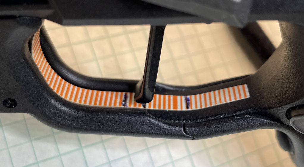

I have been looking for my P365 trigger that would accommodate my hand. The factory curved trigger had good pull length but only when the finger was in the middle of the curvature pushing my finger up during the pull and pinching it on reset. The toe of the trigger was too far forward for me to place my finger lower.
I compared my curved trigger to SIG flat one and found that toes of the both triggers are in the same forward resting position but flat one is 2mm forward at the finger position compared to the curved. That was no go for me due to my shorter fingers.
I watched the trigger installation video by MC*CARBO and found comparison of relative positions of both SIG flat and MC*CARBO triggers-BINGO!
According to the video the MC*CARBO trigger is aft from the SIG flat in resting position and matching the face of my curved trigger at finger position with additional bonus that toe of the flat trigger is over 3mm aft form the curved allowing me to place the finger even lower.
Photo: the millimeter graduated sticky tape shows the following trigger positions front to back:
Toe of curved-resting.
Toe of MC*CARBO-resting.
Toe of MC*CARBO-back.
These dimensions are illustration only and true on the trigger guard but not at finger position.
