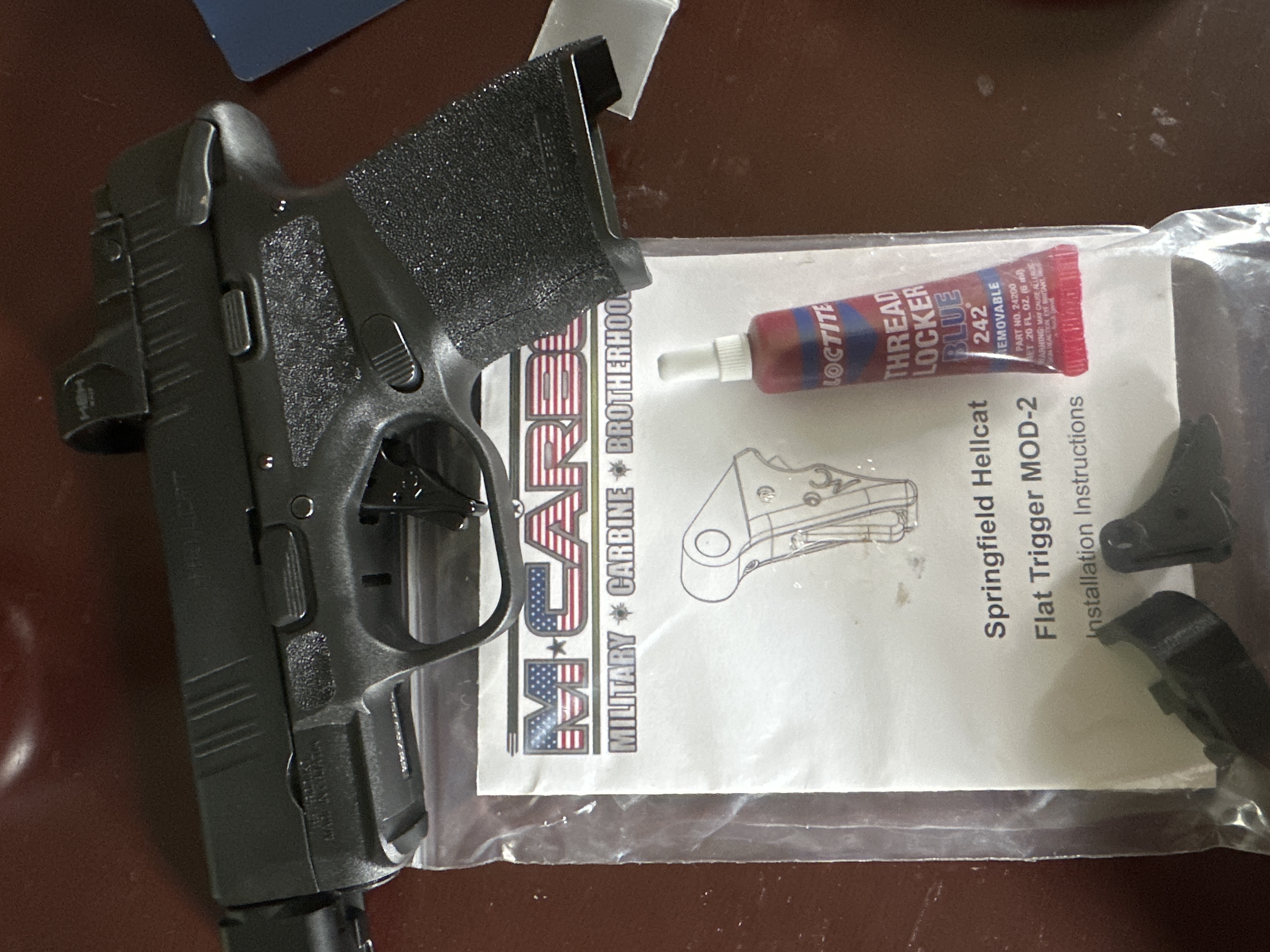

Bought the flat trigger for the Hellcat, even though I couldn’t review installation video (because there wasn’t one) ahead of time. Figured I’d get a paper addendum or something … but NADA. It cam with a jig, presumable to set the travel, but no instructions on how to use or set the travel. Then, I tried to put in the super small hex screw and discovered I didn’t have an Allen wrench that small. So, I called and was told use the jig to put in set screw .. bottom out and back out 3-4 threads. When I asked what the Allen wrench size was, gunsmith said 1/16”, but there was no way! Even a .05” was too big, so called again and they said .035mm, of which they meant inches, but they swear it was mm. When I asked why they didn’t include the micro-allen wrench they apologized and said they would send one. So, trigger has been sitting on my bench for 3 days and will be there another couple min. What happened to the old MCARBO where everything was thought out and any/all tools provided in the kit. Seems like they are shooting from the hip on this one.
Works as expected but no instructions but able to install the pre-travel screw (0.9mm hex key)
same as Bipster and Ricky Bobby but luckily I have a micro set for cellphones and was able to use a 0.9mm hex key.
