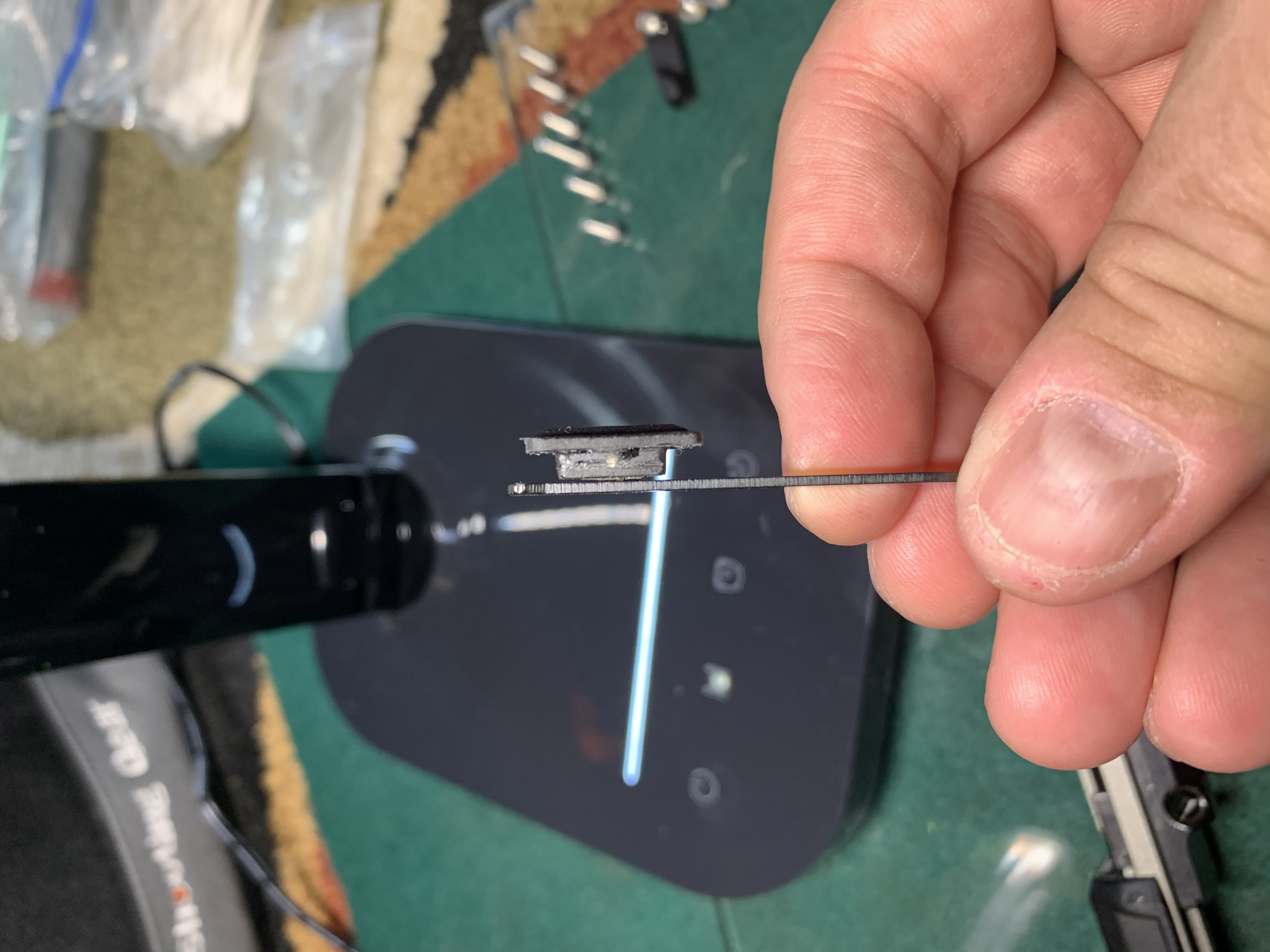

My wife got the All in One Bundle for me for Christmas. I watched the video and decided to install myself. The trigger and feed ramp were fine. Follow the video closely and you will not have trouble with them. The Mag Catch was so tight on the Mag Catch Axis that it would stick in whatever position it was moved to. when I released a mag it would not catch the next mag. It would have to be manually pushed back into position. The spring simply could not overcome the tight fit. I'm sure it was installed correctly because I had just finished installing one on my CMR30 and it works fine. The recoil spring is a real challenge. I would definitely recommend removing your OEM spring assembly from the slide and sending it to MCARBO or KEL-TEC to install. The video does a good job of showing the process but removal of the Recoil Spring Guide Lock Ring will drive you mad. I succeeded but only after losing the original Ring and almost losing the Recoil Spring Catch. Luckily they included a new replacement for the Lock Ring or I would failed. A recommendation for MCARBO to try: Use a small clamp or vise-grip pliers on the Recoil Spring Guide to hold the compressed springs in place while working to remove the Lock Ring and when replacing the Lock Ring after installing and compressing the springs. (Naturally I did not think of this until I finished.) If MCARBO can validate this then I recommend adding it to the video.
