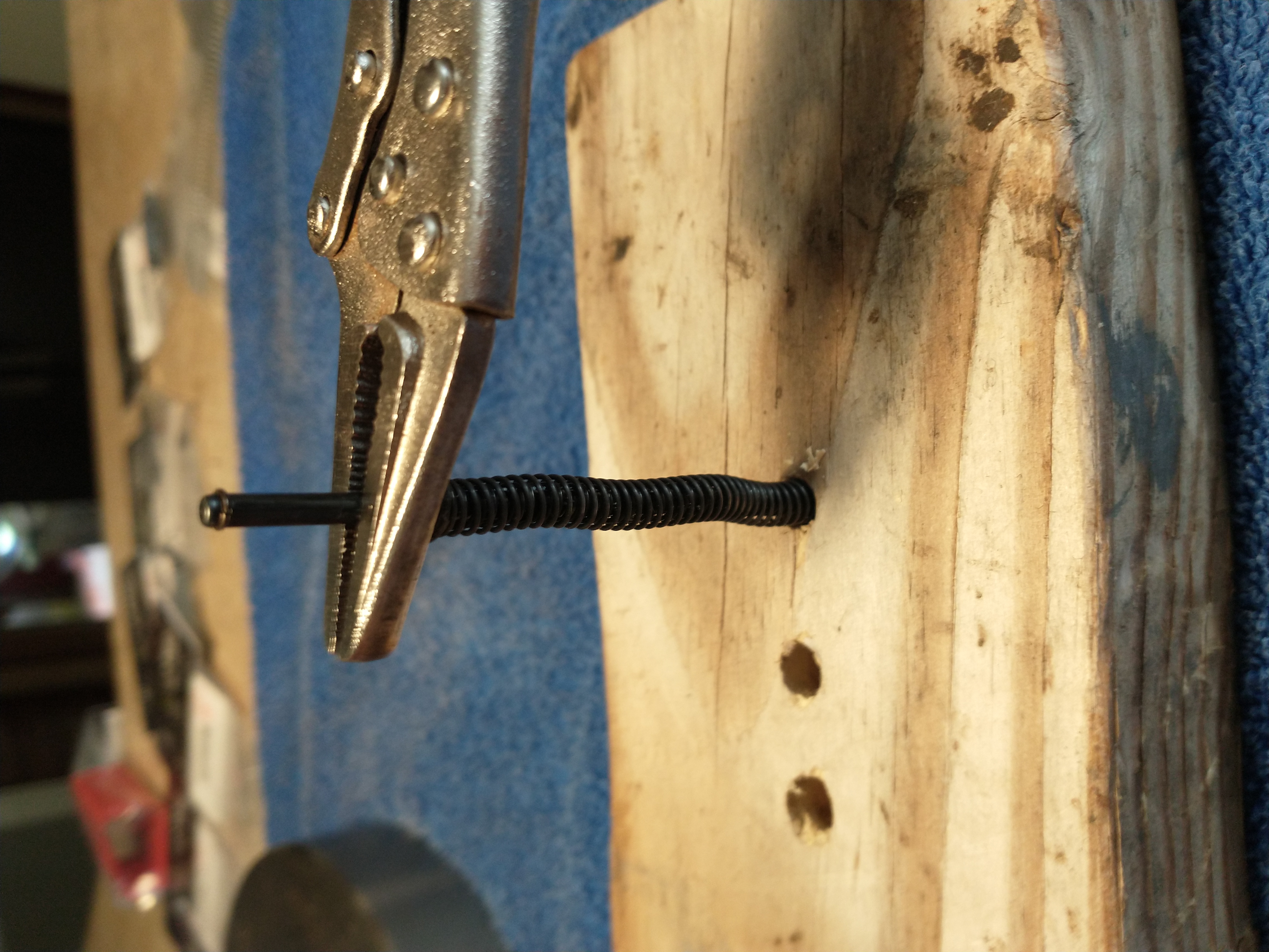

Helpful hint #1, first thing right off the bat swap out the left safety lever. This will hold the receiver in place, and hopefully the hammer spring too. I learned that the hard way. Tip #2, run the trigger set screws in most of the was, cut off most of one of the allen wrenches, adjust the front screw first with the trigger in the pulled position, then adjust the back set screw. You won't have to take it apart to adjust the trigger this way. I took my time, buffed the feed ramp, double checked everything before I started putting the halves together. I still had to reset it a couple of times before everything stayed in place. This firearm fires flawlessly now. Even old Winchesters that I've had since the first ammunition scare. I think it's worth the money, but maybe it's something that KelTec should be doing. Oh yeah, if you have a pair, use needle nost vise-grips to hold the spring down on the guide rod. I had to cut about 2mm off of the new ring. I thought I had it on, but it came off when I shot it. The I saw where the ring was over lapping. I would buy the set put together by M~Carbo as soon as possible. Please! 😉

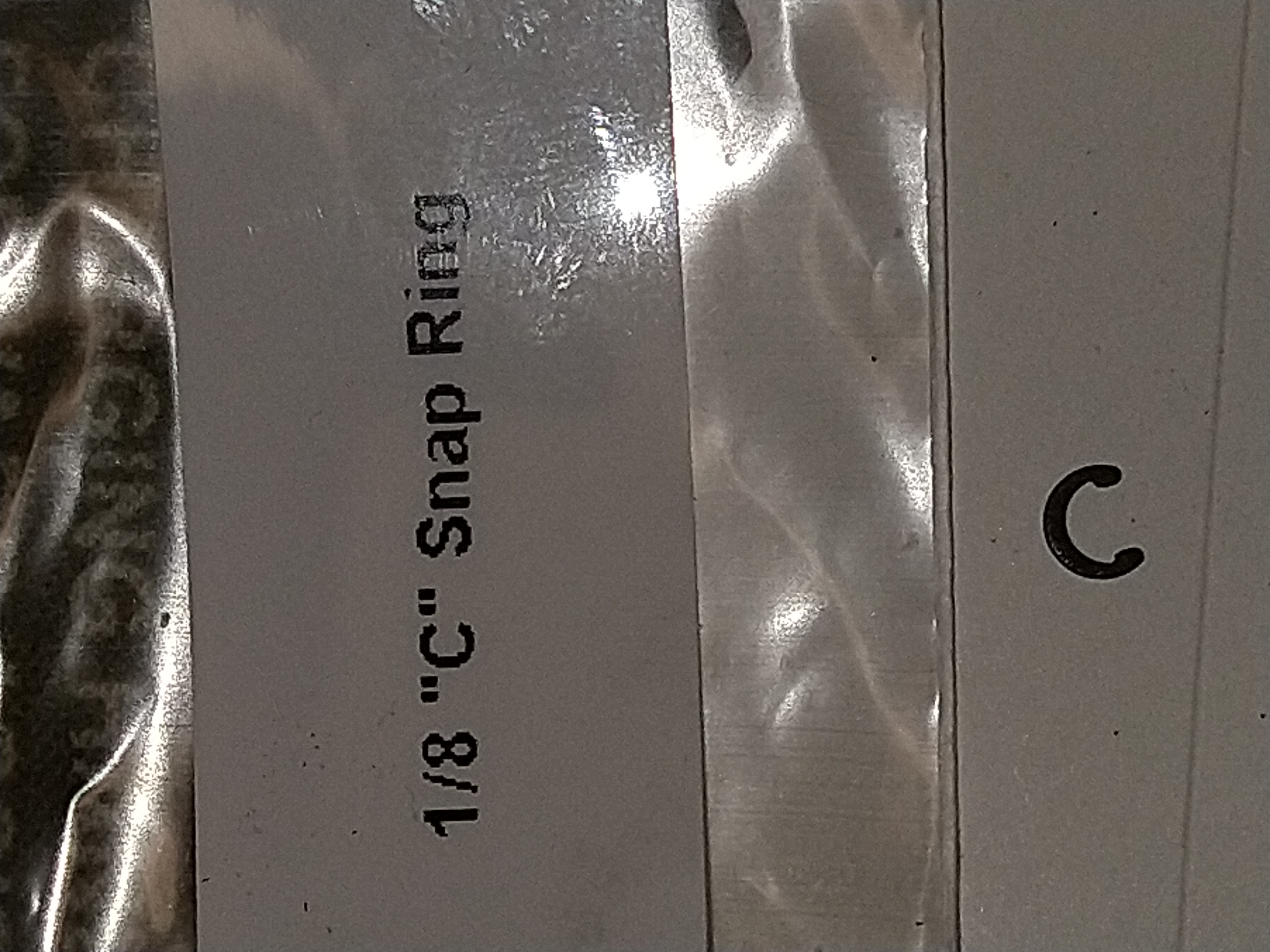

The PMR 30 All in one kit is Great and the installation video was perfect. I did fine a substitute for the wire ring on the recoil spring guide rod. Ace Hardware has tiny "C" rings they fit the rod AND the retaining washer. Keep up the great work.
