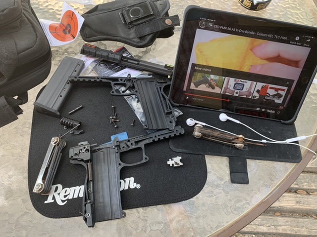

PMR FEED RAMP
Received quickly, watched the install video. Tried several times(45 minutes) to get the spring in, used the tool. Could not get the spring in the little hole.
I finally made a plastic shim and inserted behind the feed ramp and again using the tool, this time on the second try bingo spring went in.
My PMR30 did not go together that easy unlike the one Chris did in his video.
Just took a little time and some effort and finally came together.
When I get a chance to go to the range will check it out.
Things here in Texas with virus has made it rough to get out.
Overall it was a great experience doing this upgrade.
