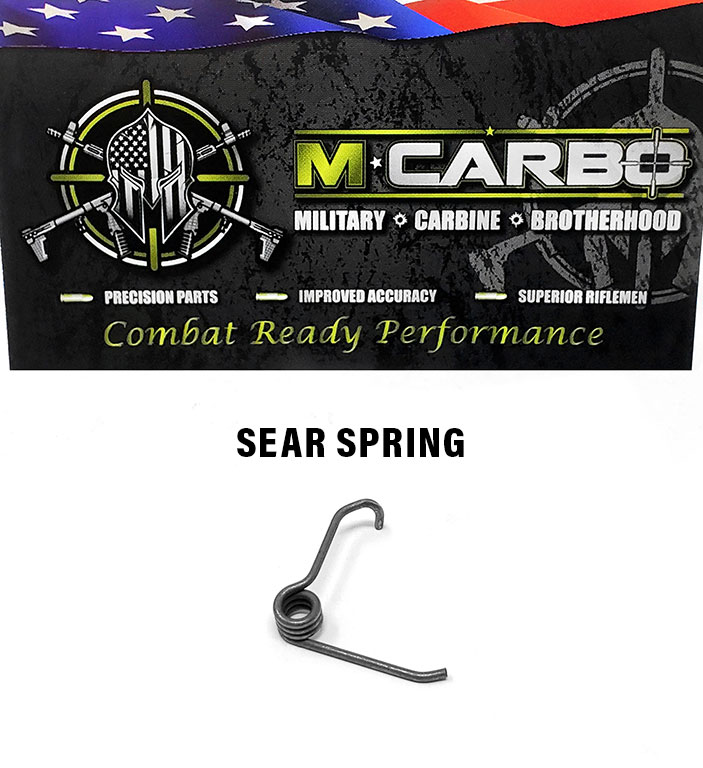

Rossi RS22 Trigger Spring Kit Custom Rossi RS22 Trigger Spring Kit will reduce your trigger pull from a factory 5.75lbs to a crisp 3.5lb trigger pull. Rossi RS22 trigger upgrade will improve your accuracy and tighten up shot groups!...
Install was tricky but not that difficult. The spring greatly reduced the heavy trigger pull and now it's much more manageable.
Shipping was quick and customer service was top notch. Highly recommended company and products!
Greatly improved trigger pull. A bit of a pain to install but worth it.
This spring is an improvement over the factory spring and reduced the trigger pull over 1 lb. I don’t have a gauge but can definitely feel the difference.
I did have a problem though…the spring was bent out of shape enough it rubbed causing trigger pull issues. I had to Ben the end to correct shape and lightly file the end. Worked perfect after that.

After good experience with some there Mcarbo items I figured this was a no-brainer. I was disappointed to find that there is no noticeable difference at all. I know this because my sister has a Rossi RS22 as well so I was able to compare the factory original trigger spring with this Mcarbo upgrade side-by-side at the range. I was disappointed to find that I could to tell a difference between the factory original and this one. In addition, I had a heck of a time with this replacement. While the video instructions are clear, it missed a step that caused me to really try my patience: when you have the trigger assembly out to install this spring...make sure the safety is OFF! It was a royal pain until I did that. Combine the frustration that I had with the installation with the fact that both my sister and I found no difference between the factory trigger and the trigger after this install and I can only report disappointment. At least it works, so I have the factory original as a backup.

I've got two RS22 bought within 6 month of each other. The tock trigger pull measures almost 4.25 lbs, the MCARBO spring kit reduced the other one to right at 4lbs. When I bought mine it was $12.95, it's currently $7.28 at the price it's a fun learning experience in how to disassemble your rifle, just don't expect much reduction in trigger pull.
