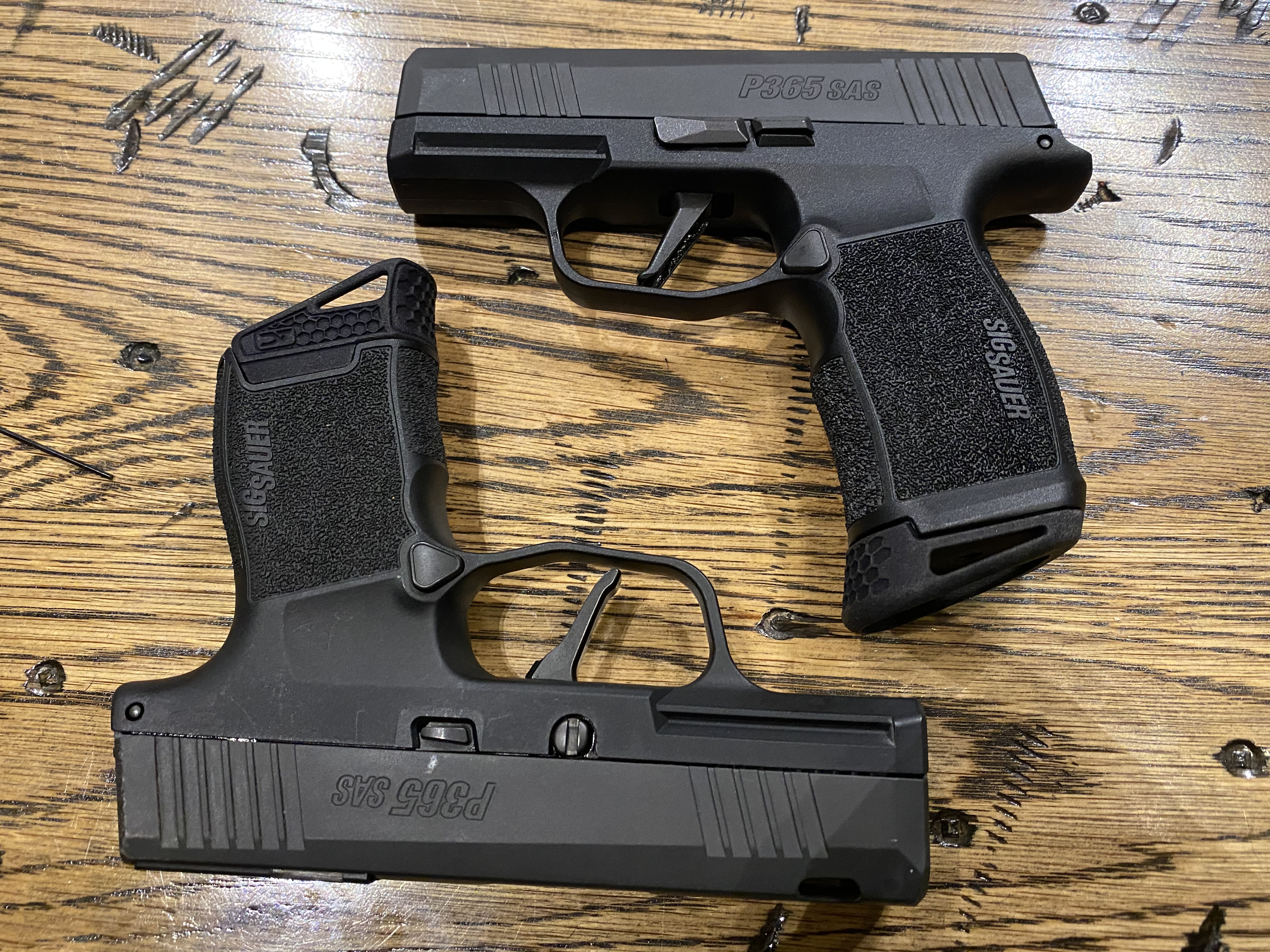

Working on my P365
I bought the trigger spring kit, PTFE grease and small Notch-Cut Tip flat blade tool. They all worked great. The initial trigger pull on my pistol was ~4lb 8oz and after installing the spring kit it's down to 3lb 8 oz and nice and smooth with a short reset.
The Sig P365's FCU is a complicated little bugger so watching M*Carbo's video was invaluable. I brought it up on my tablet and would watch a section and pause the video while duplicating what I'd just seen. The Notch-cut Tip Flathead tool works well for removing the slide end cap and when removing and installing the trigger return spring. You can use a right angle dental pick but this tool makes it much easier. The PTFE Synthetic grease really does hold the sear spring in position while you insert the pin.

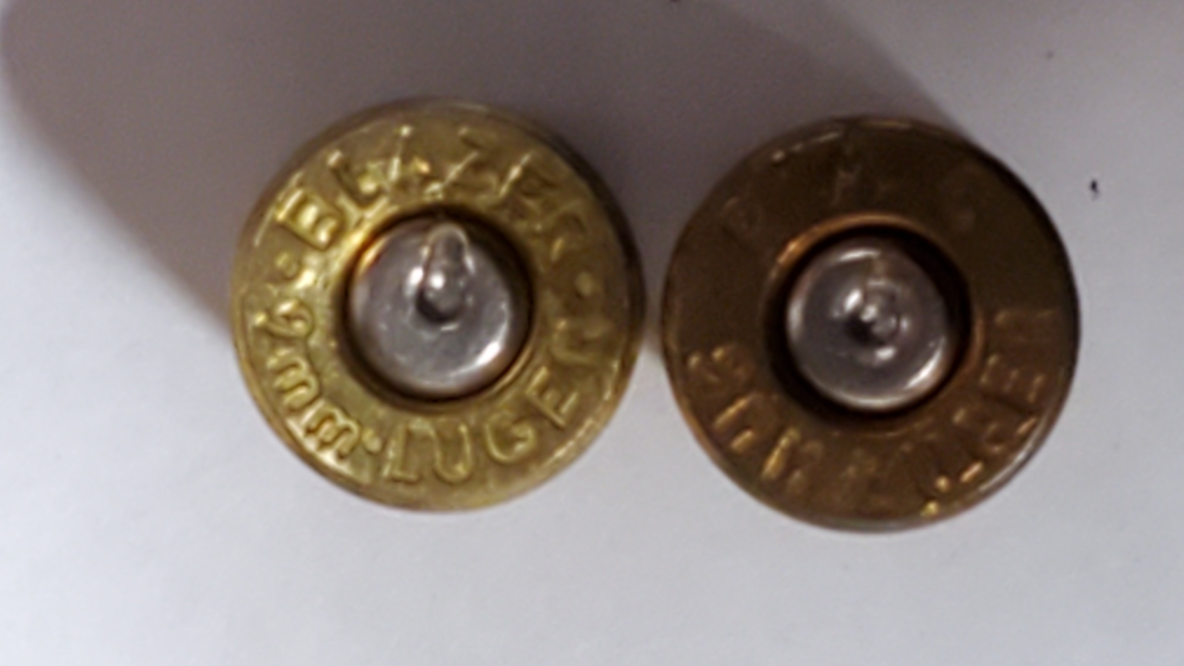

Shipped out quickly. Easy to install, tiny bit lighter pull with smoother action. Annnndddd less primer drag? Well that is what I noticed. Especially after I just replaced the striker. Now I read the casings after each shoot day.A noticeable smaller striker swipe. Makes my favorite carry even better. So far so good.
