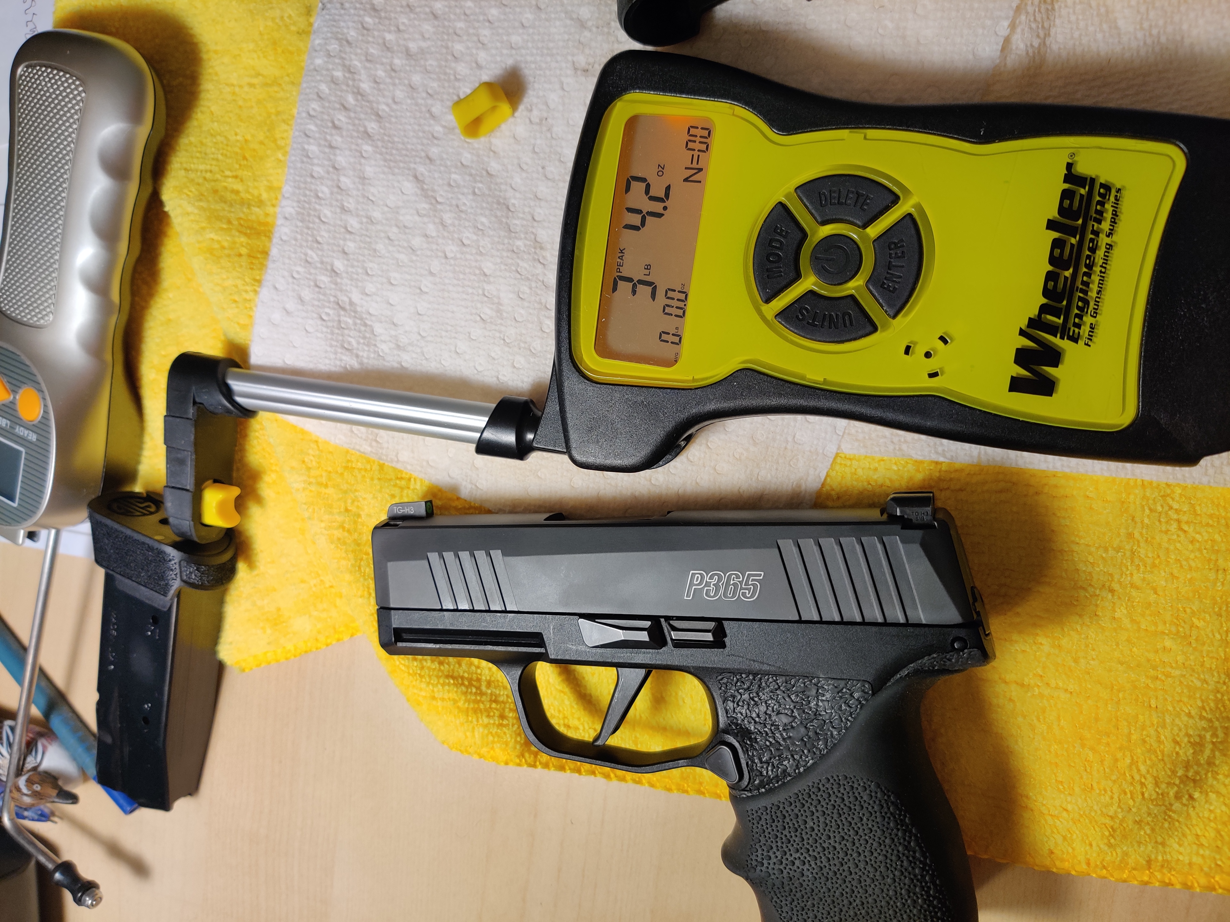

Installed the kit in my P365 Custom Works FCU. All I can say is WOW!!!! What a difference. I was skeptical having to reuse the trigger spring but I was wrong. The improvement in the trigger is very nice. Not too light for EDC but still much lighter than factory. Installation instructions were very detailed and accurate.

Nice spring set. Not difficult to install. If you have the Manual Safety, you will need to know how to remove the manual safety in order to install the spring kit. I am getting a 25% reduction in trigger pull weight, however, I had previously polished all mating surfaces.

I purchased both the mcarbo and the AC spring kit for the p365. With the AC kit installed, was still getting a small amount of extra hold on the sear / striker engagement causing a bit more creep after the wall. Mcarbo sear spring is slightly lighter than the AC. With some more polishing, used a combo of mcarbo and factory springs.

After changed springs kit, flat trigger and polish job. My p365 trigger pull is around 3 and half lbs. I love it. My friend test my p365 and they like it They like it so much they wants me to do it to their p365. It take about 15 - 20 mis. Very easy for springs kit.

My installation went very smoothly thanks to the excellent quality video. The trigger pull was only reduced 11% (8.95 to 7.9 Lbs.). The explanation I was given was that this was a never-fired firearm. During the break-in period these figures should decrease significantly. If not I have confidence that M Carbo will help in a resolution.
