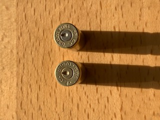

It appears the replacement striker spring has made a condition that the 365 is noted for much worse. I have uploaded a picture. In one case the primer was pulled part way out of the case. The ammo was factory browning 9mm

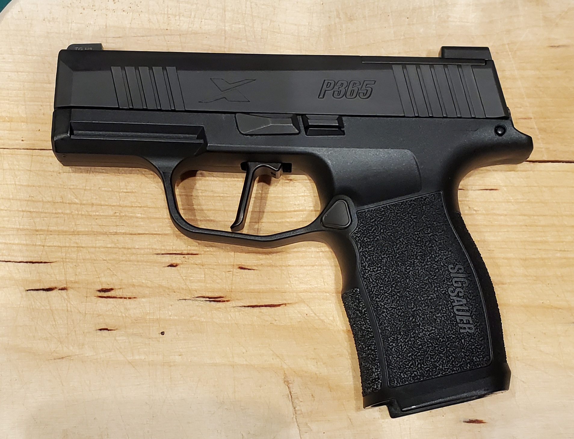

I'm updating my p365 to a P365XL, Romeo Zero. This spring set makes all the difference in this sweet little pistol. The installation was mostly simple, had some problems getting the spring above the sear pin. Additionally I added a Sig Flat Trigger, What a great update! I have ordered spring kits for all my "J Frame Smiths and my SCCY CPX-2.

Coupled with an outstanding instruction video, this kit is great! Fairly easy to install by following along even for someone that's not a gunsmith. I did a flat trigger change over at the same time. All told I got it down to a much more reasonable 4.2 lbs on the pull.
