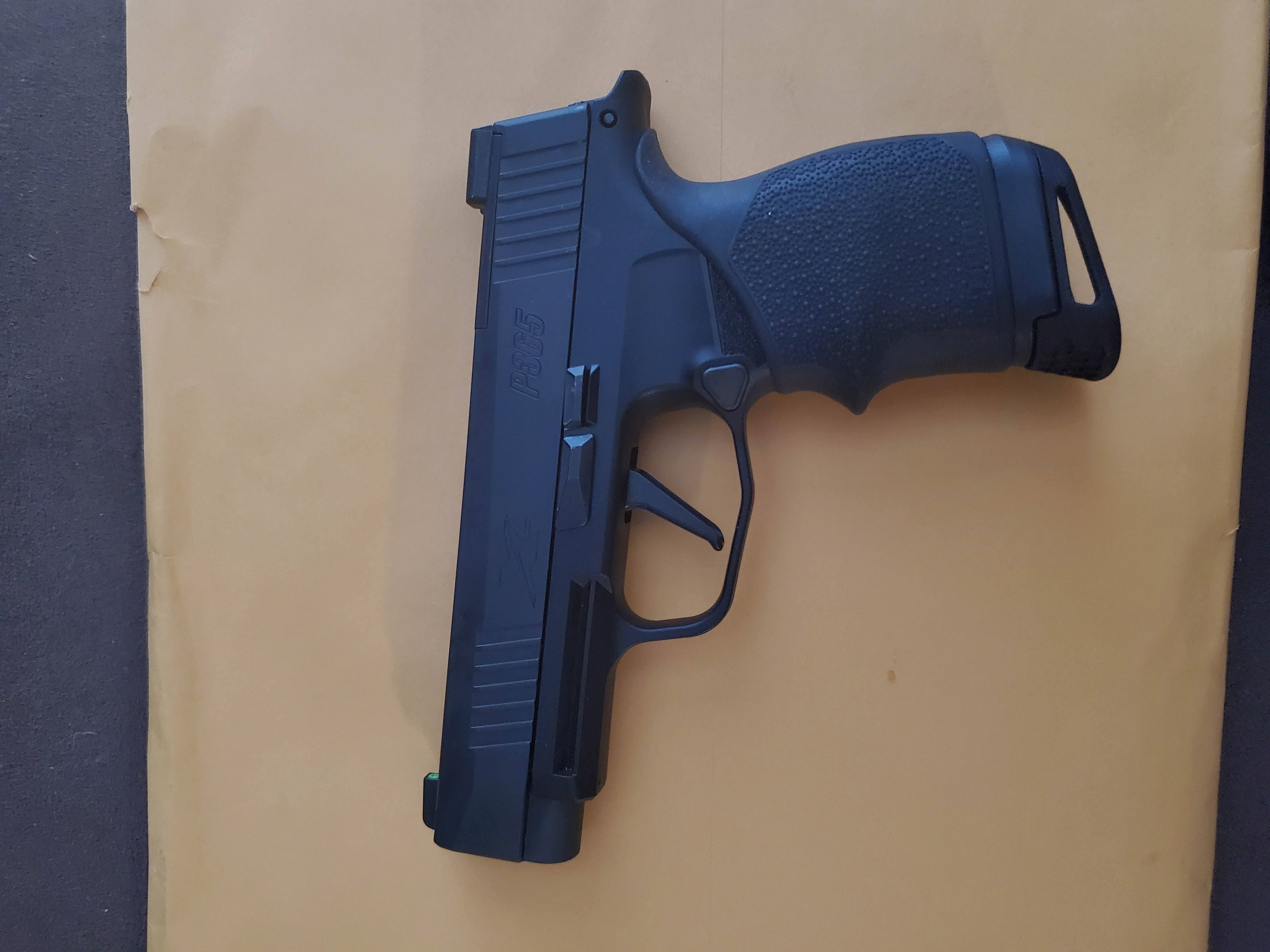

Had the spring kit along with a Grayguns adjustable trigger and with that setup it made a good gun better. Also added a Hogue grips and pinky extensions to the magazines
