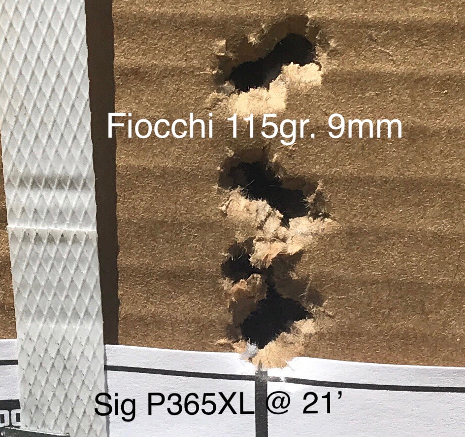

Finally installed the spring kit in my P365XL-9mm. The Trigger pull was reduced to 4.5 from 5.8lbs.
First 8-shot group afterwards was amazing!
