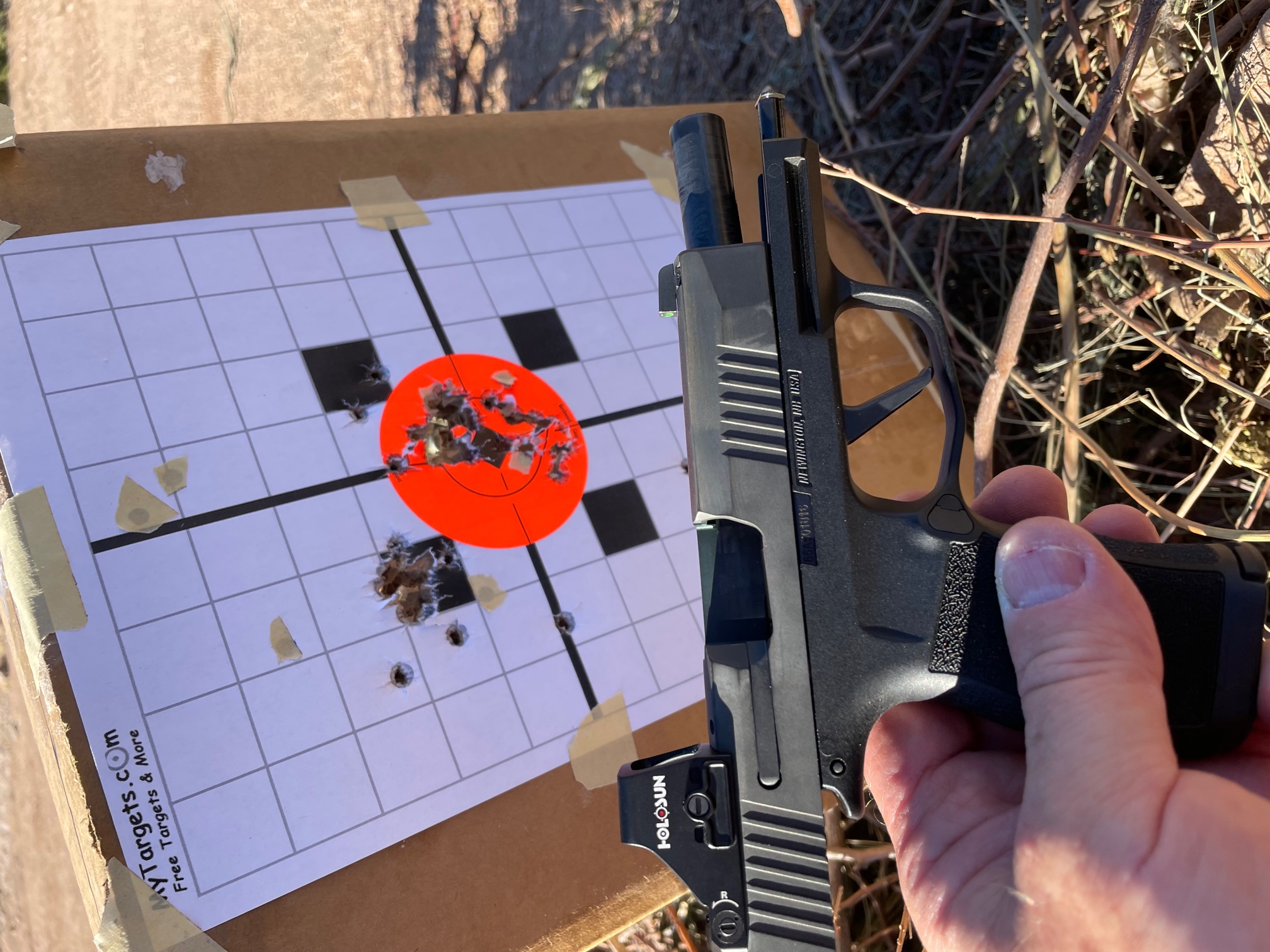

As a result of having a strong preference for lighter and smooth triggers, I recently purchased and installed this kit after review of video. Results were as advertised, testing with Wheeler gauge over 5 pull averages. Pre-work yielded an average of 5lbs 13oz followed by 4lbs 11oz upon completion. I did polish sear to further smooth action while apart. I would point out in the video, if installing into a P365 XL, to move the striker sleeve/housing toward the left to aid in slide disassembly. I did see a very brief video of this on You Tube if interested. I did field test and groups improved using my target practice reloaded 9’s. I recently added a Holoson 507K X2 optic prior to this spring replacement which required additional adjusting during testing. I would certainly recommend this kit if a fella is a trigger snob like myself, because it certainly improves pull and isn’t too light, which I believe one should be careful with a semi-auto piece.
The attached photo depicts groups shot at 10yds using my reloads of 4.6g Bullseye with 115g Berry and Extreme copper plated bullets over a rest. Shot close to 50 rounds total with final adjustments made on top left black square. The other scattered rounds were from much greater distance playing around before adjustments without changing to a fresh target. M Carbo did a great job with video and has it right! Am pleased to support brother veterans!

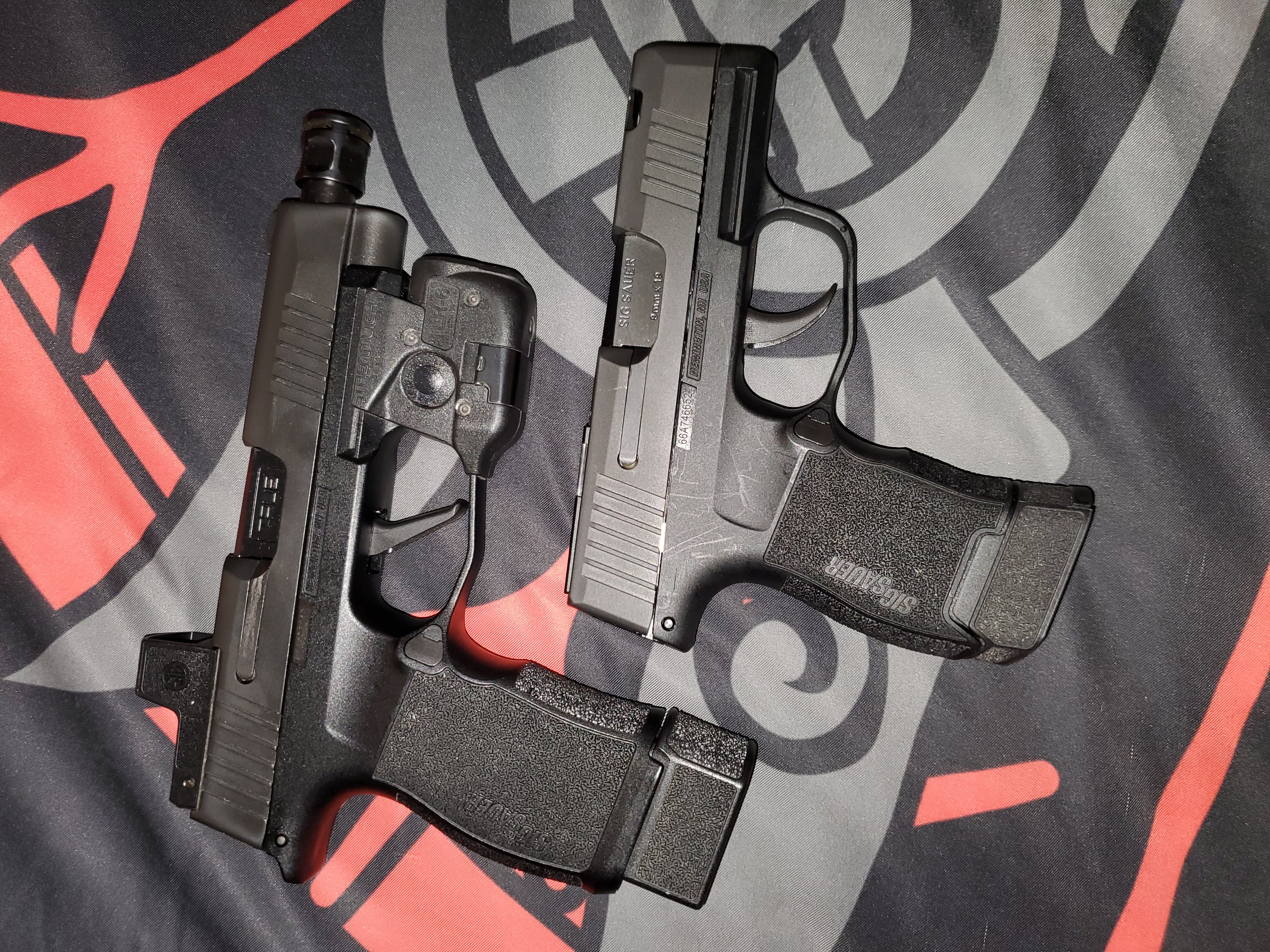

I've put these in both my sas and XL they make a world of difference
P365springs
Fast shipping great price bought two sets installed them on my P365 XL and SAS great quality parts and the results were amazing much smoother pull at least 40% reduction and better reset also noticed a much cleaner break would highly recommend these for anyone with a P365
