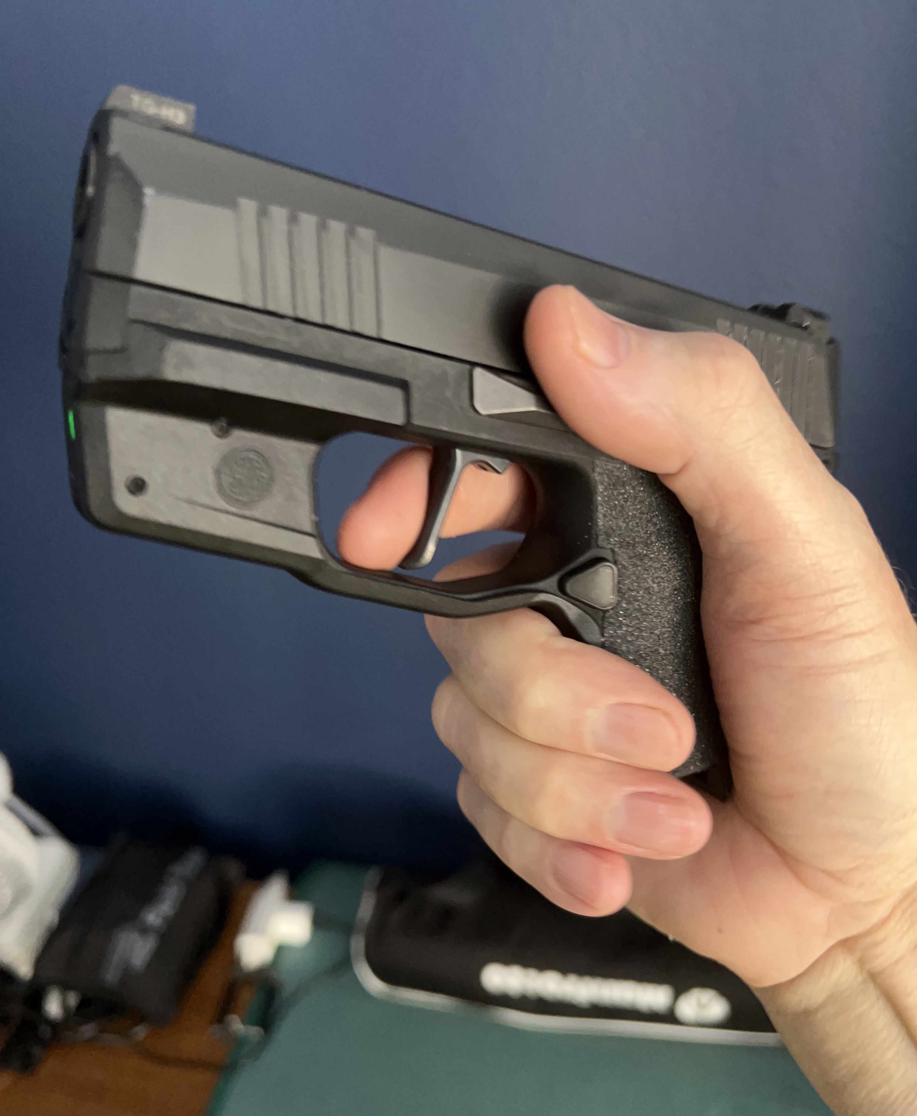

I'm new to shooting, and the Sig P365 is my first gun ever. I really like the gun overall, but I found the trigger to be a bit too stiff. I also have a Sig Lima365 aiming laser fitted, but it requires a fairly stiff press on the button to light the laser. That, added to a 72-year-old somewhat shaky grip and relatively long fingers have gjven me a pretty funky shooting situation. When I learned about MCarbo's trigger spring kit which promised a lighter pull, I jumped at the opportunity. The installation was quick and easy. I also installed MCarbo's CNC Flat Trigger at the same time, which I also like quite a bit. Though I'm still just starting to practice with the new setup, while dry firing to feel the new trigger pull, I tried pressing the laser light button at the same time to see how that felt. Of course, I'll try it at the range, but I'm finding that by shifting my grip back around a bit, I can use the stronger second bone of my middle finger to hold the light on, while I use the FIRST bone of my trigger finger to pull the lighter trigger. It's also a smoother, shorter throw.
