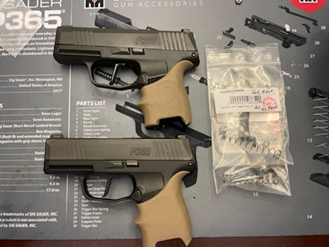

First time to get into the guts of a gun like this. I'm handy, but no gunsmith. The video was perfect. I have the new striker assembly, so I did need to look for a different video on how to take out the striker sleeve. The hardest part, for me, was holding the sear spring leg up while putting in the safety bar pin. That took a little patience and a bit of holding-the-tongue-the-right way. Definitely get the synthetic grease "gunsmith's glue". All in all, it took about 30 minutes.

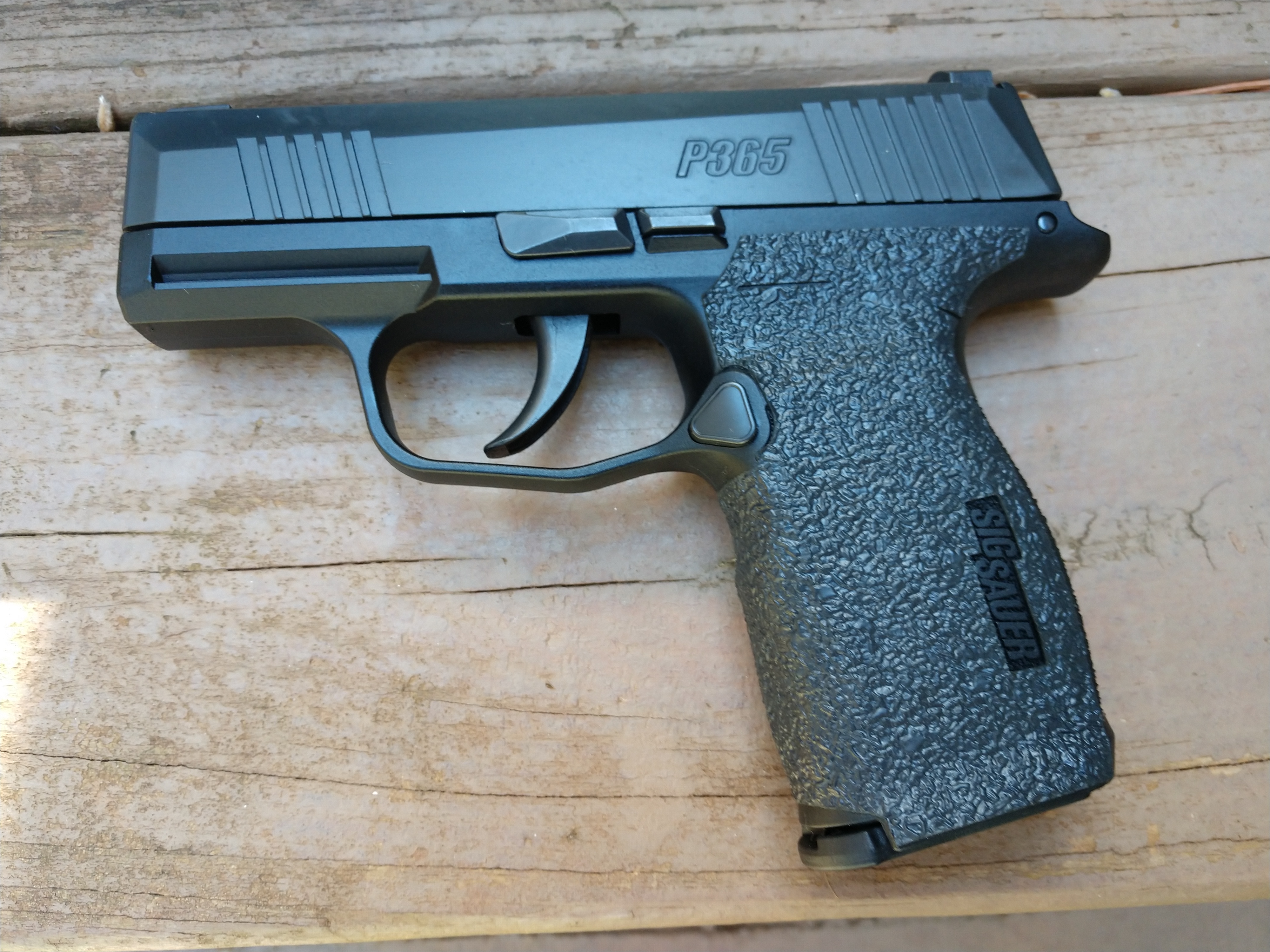

I was pretty unimpressed with the factory trigger pull on my Sig P365XL. It was long and mushy with an average pull weight of 4 lbs 6 oz. Not really that heavy compared to some pistols, but it was awful with that long mushy feel. I installed the M-CARBO spring kit and the "mush" went away and now has an average of 3 lbs 7.7 oz. IT's not just the reduced weight but the overall better feel.
I do wish the trigger pull still had a more defined wall before the break but it is still a great improvement over stock!
The install video M-CARBO has is great and makes the install pretty easy.

I have these kits in both my Sigs. I also have installed the flat triggers. Huge difference.
