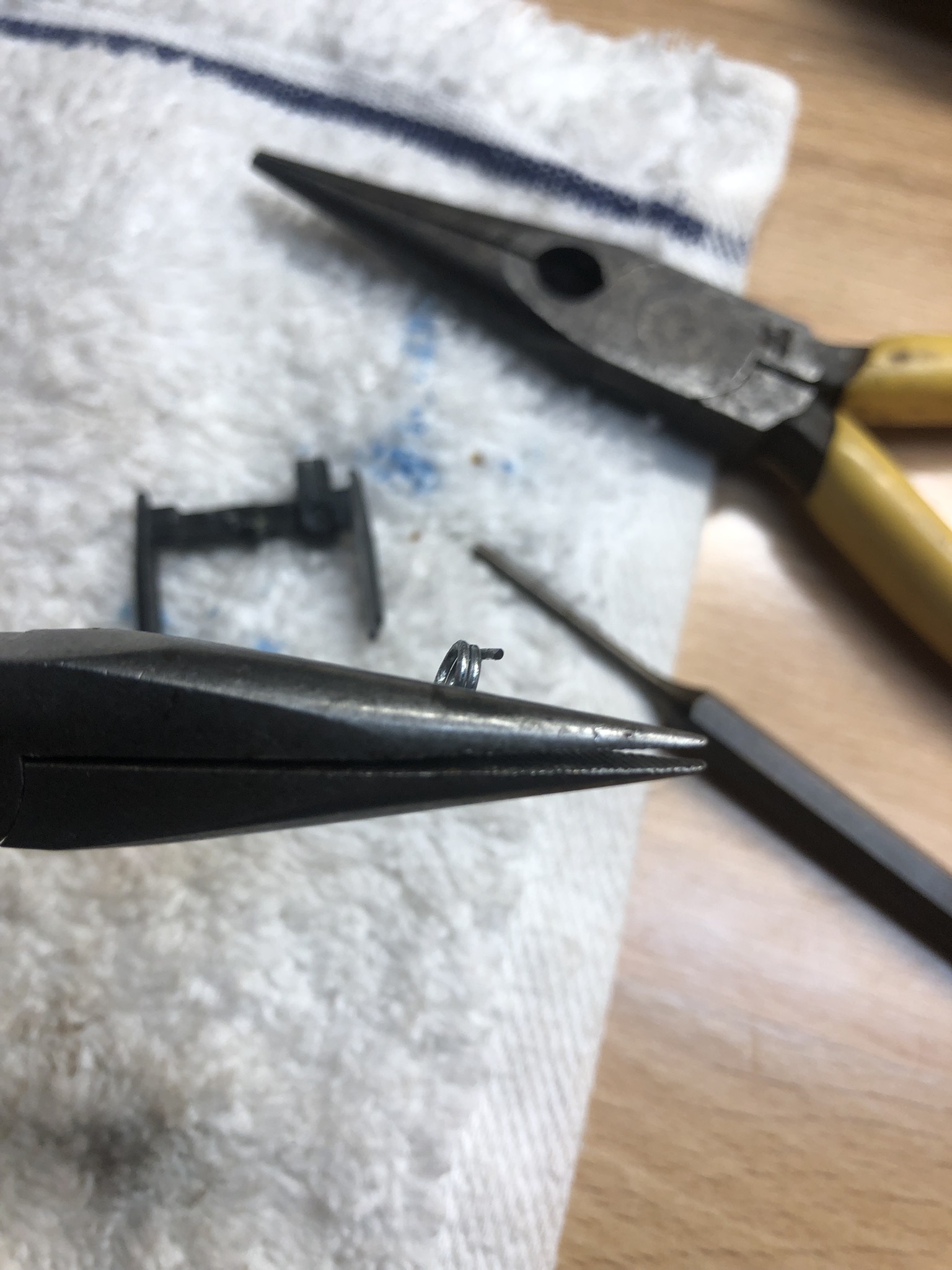

Then there is the sear spring. Should have been easy, but the spring had a twist putting it in the sear pocket was impossible until I used pliers to straighten it out, then it dropped right in.

This is a pic of the sear spring showing the defective twist.
