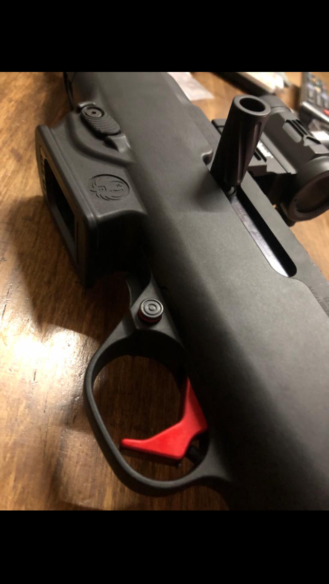

Ruger PC Carbine Flat Trigger Upgrade Close Up
Ruger PC Carbine/PC Charger Flat Trigger Upgrade MOD-2 (200044226601111)
