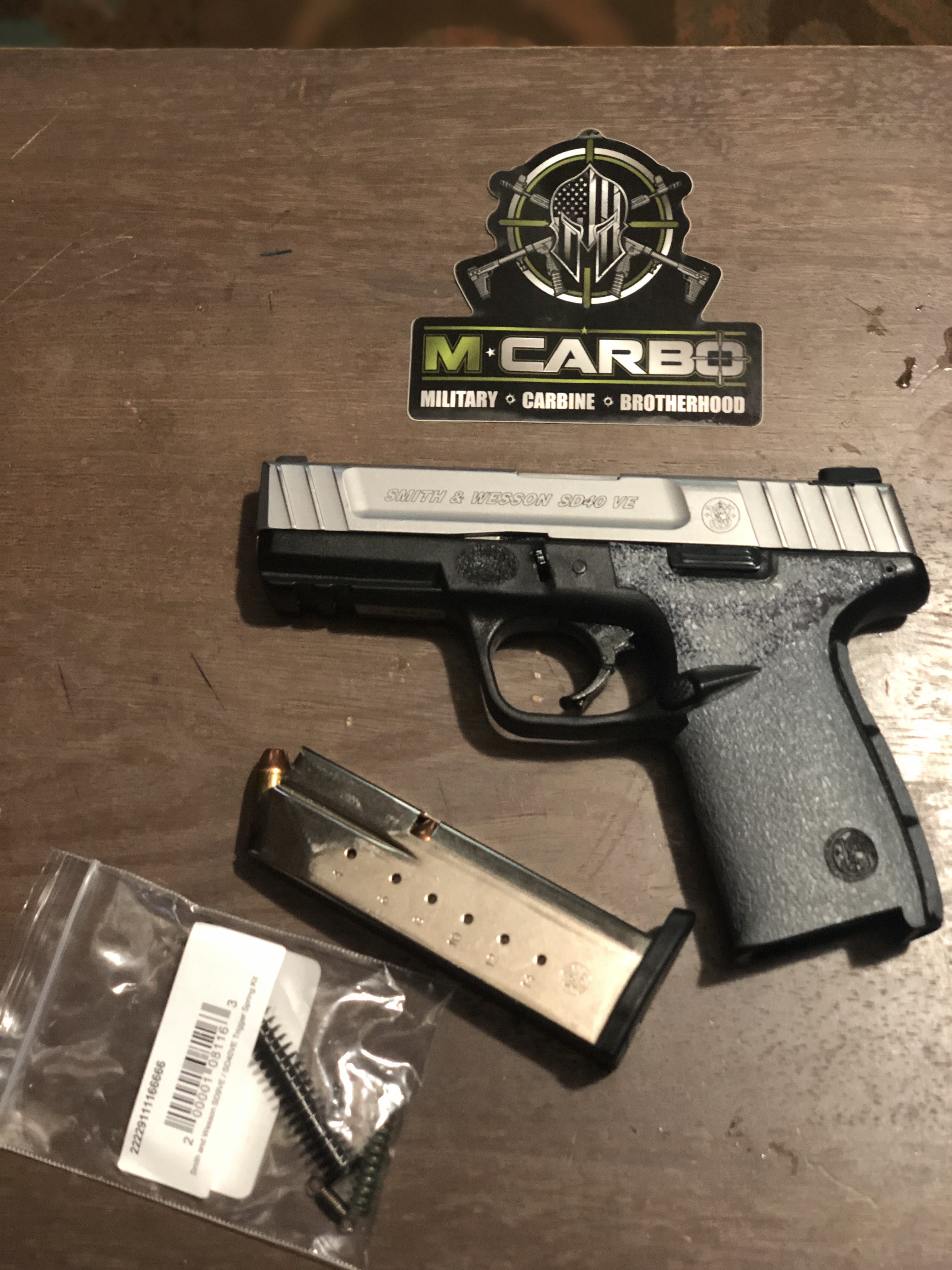

I ordered the trigger spring kit for my s and w sd40ve. I installed it over the weekend. Product was as advertised and high quality. I installed it with a new flat faced trigger, and my pistol is now a complete BEAST ! Reduced trigger travel and pull by almost 3 lbs. The difference is not only significant, but uncanny ! MCARBO gets an A+++ for product quality , as well as incredible customer service ! Shipped and arrived quickly. I feel as though I just had an early Christmas. Thank you MCARBO ! You are a class outfit !
