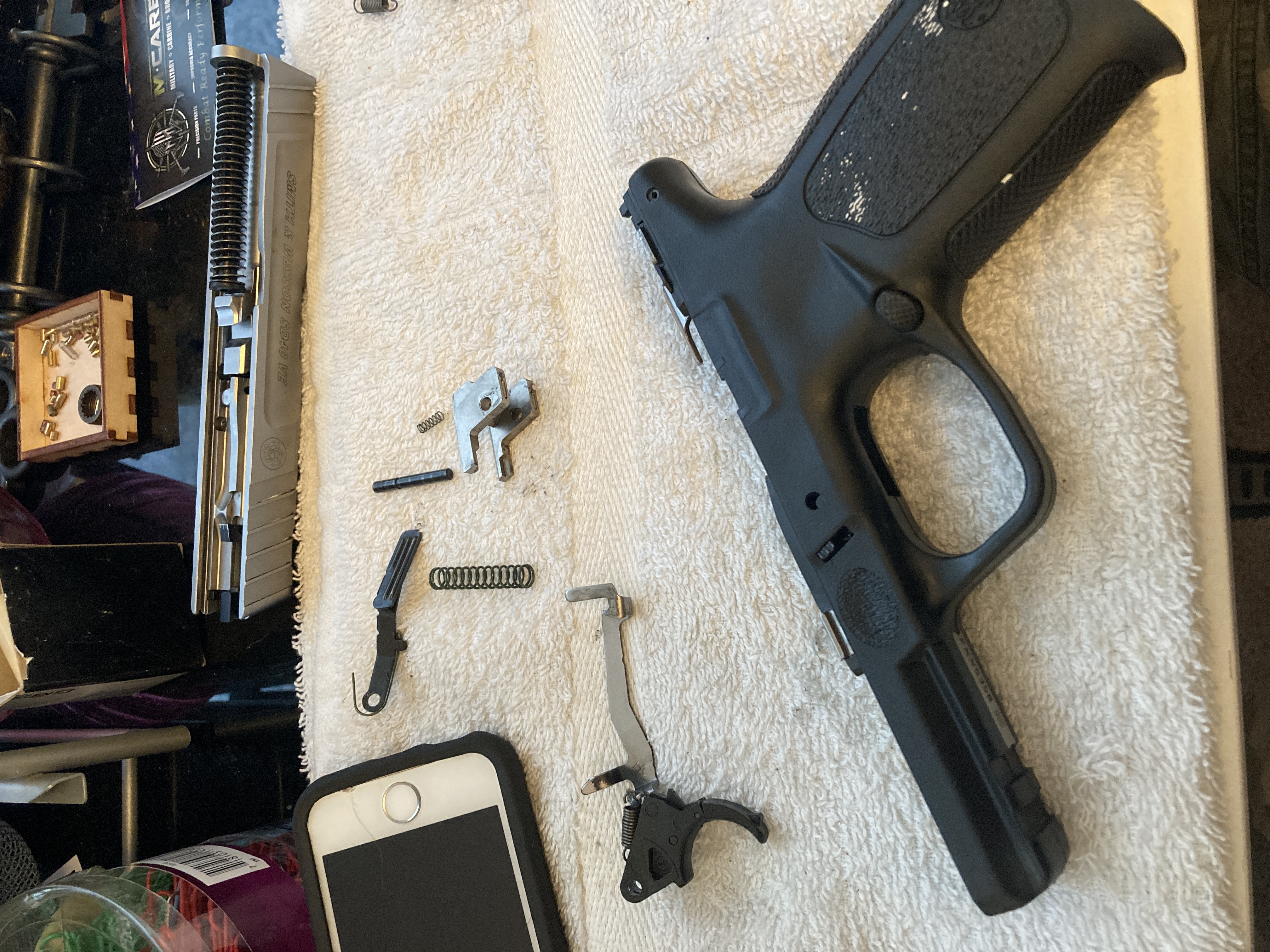

Just finished installing the SD9 VE spring kit following the detailed video. Of course it never goes as smoothly as it does for Chris. The trigger spring was a bit of a nightmare. He includes a little helper tool, but I could never get it to line up properly. This is my 4th kit, and I made a tool out of a large finishing nail that I ground the tip flat. It works as a great roll pin lead/following tool. Oh, and be careful with the 2 little plastic 1/2 circle spacers. I let one get away from me and spent 15 minutes trying to find it. ARGH!
Anyway, after using a lot of expletives, I finally got the springs in and reassembled the pistol. I was very pleased with the trigger pull reduction and improved smoothness in the pull. Before the kit, the trigger would reach a stopping point and you would have to keep applying pressure until it popped, which affected the aim. After installing the springs, the trigger has a nice smooth, continuous uptake to the release point. This is just what this pistol needs. Now if S&W would just make a better trigger.
