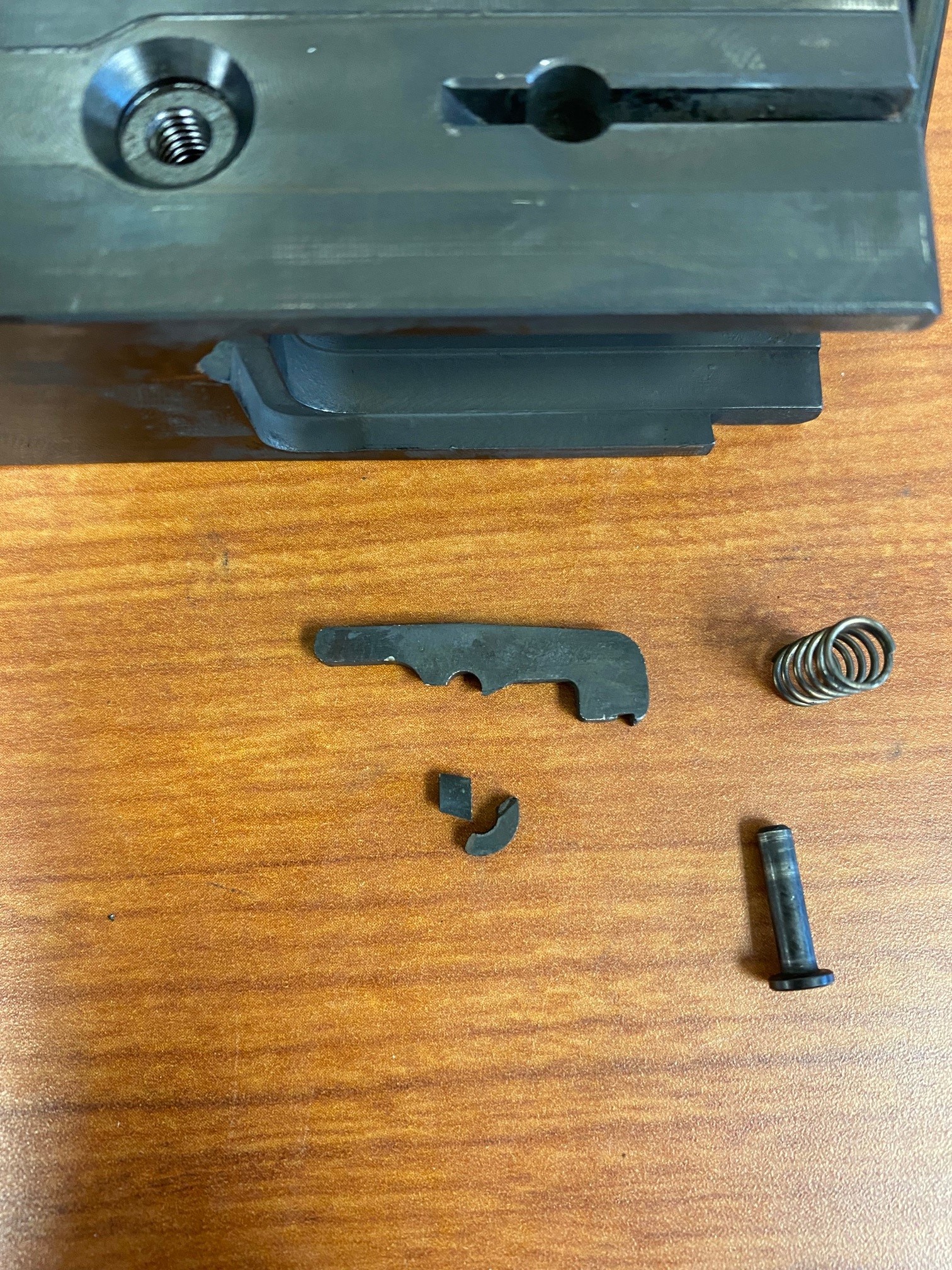

Update to my August review. I am now asking for a SECOND replacement. The original M Carbo extractor broke (the extractor pin retention hole) after about 200 rounds. The replacement has now broken after about 200 rounds (the same exact break). Hopefully the third time is the charm. I don't know if these parts are milled or if they are PIM metal, but having two break in the exact same manner with only a couple of hundred rounds is less than encouraging and doesn't instill a sense of confidence.
