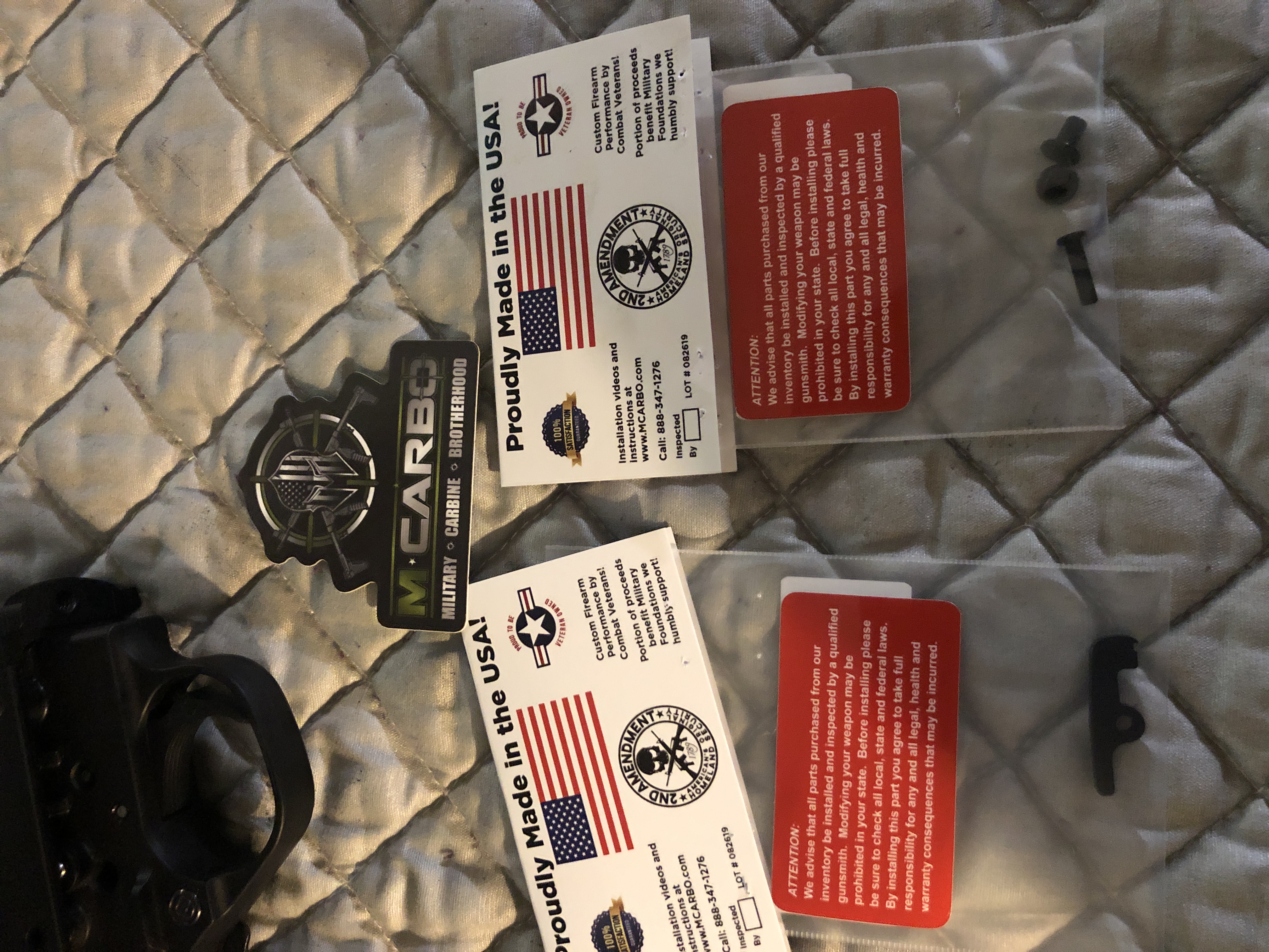

New to me Ruger PC Carbine 9mm. See my reviews of Muzzle brake and flat trigger also. EE Extractor installed as easy as watching the videos. Taking my weapon down/up before parts arrival gave me the confidence to install all nine of the parts with ease. Parts are quality, fit properly, and function as advertised. Videos are easy to understand and complete in content for each part I purchased.

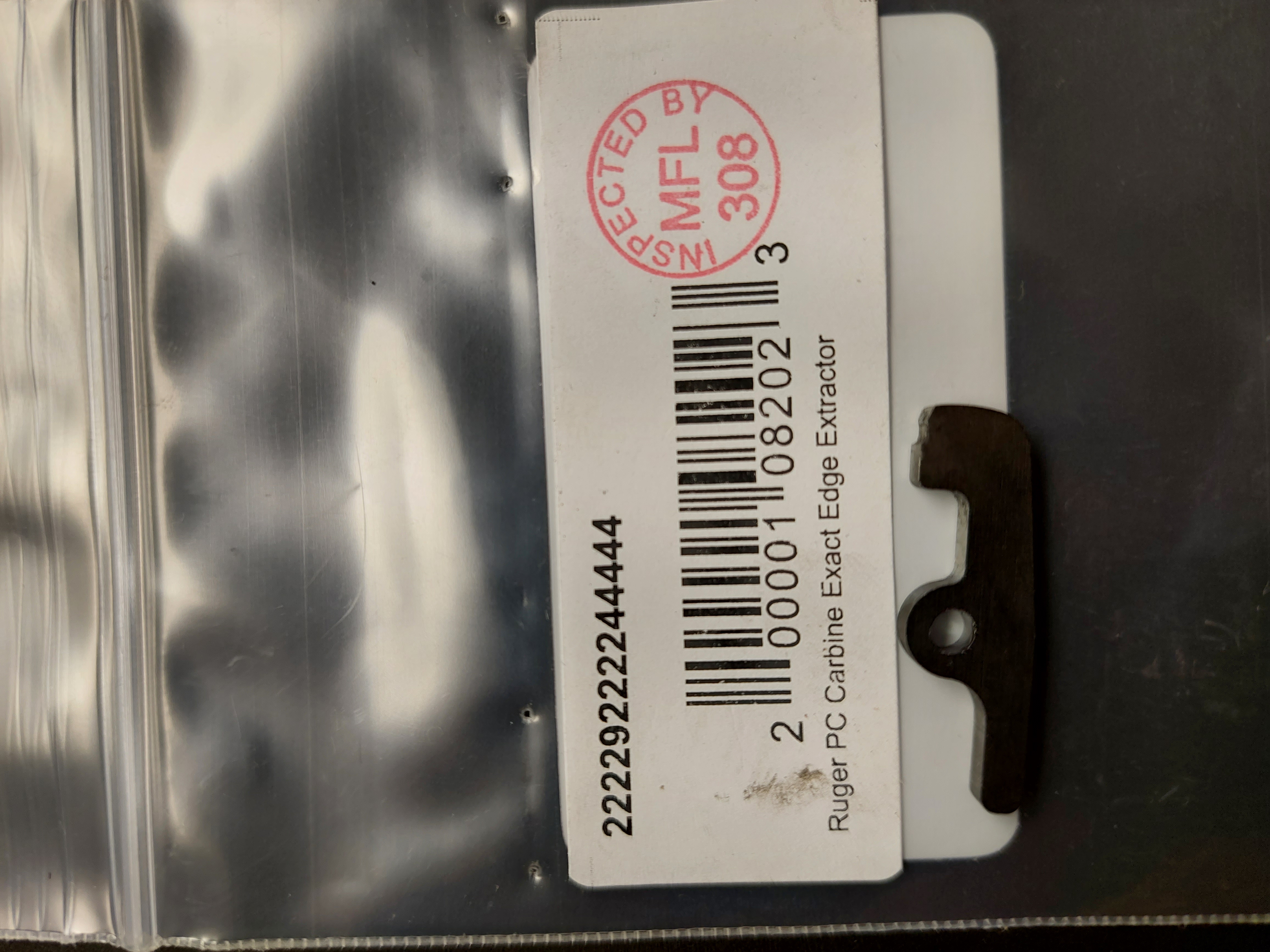

My PC 9 started stove piping rounds right out of the box on the first day on the range. Replaced with this extractor upgrade which was very simple to do with the video instructions provided by M*Cabro and after 150 round tests at the range, had no stove pipes! Looked at the extractor edge under a loop and saw the big quality difference in the sharpness of the edge that hooks on to the casing edge compared to the rounded edge on the stock. Very satisfied

The first one chipped at the claw after about 100 rounds and I started having random failures to extract. Mcarbo was quick to respond after about 36 hours and quickly sent me a new one in the mail. If this one breaks I’ll either try the competitor or just switch back to the oem.
