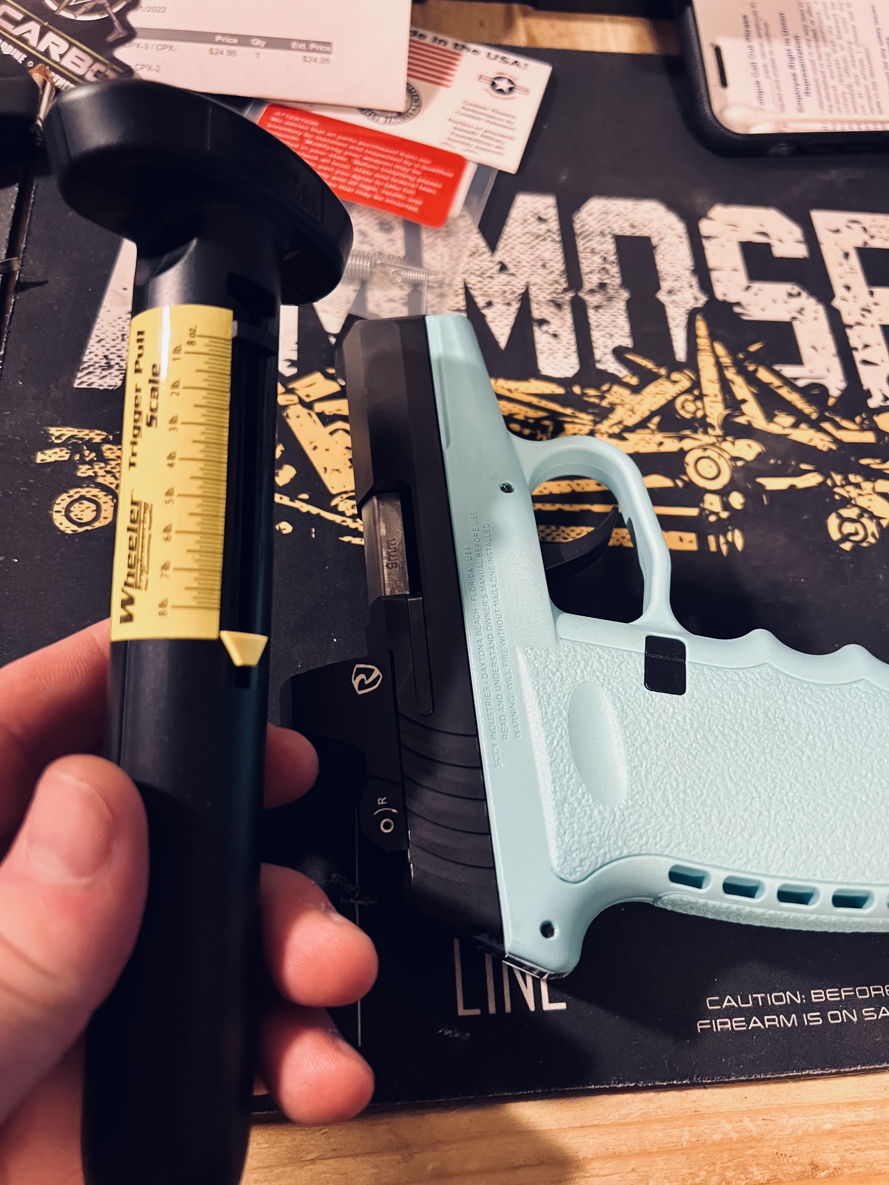

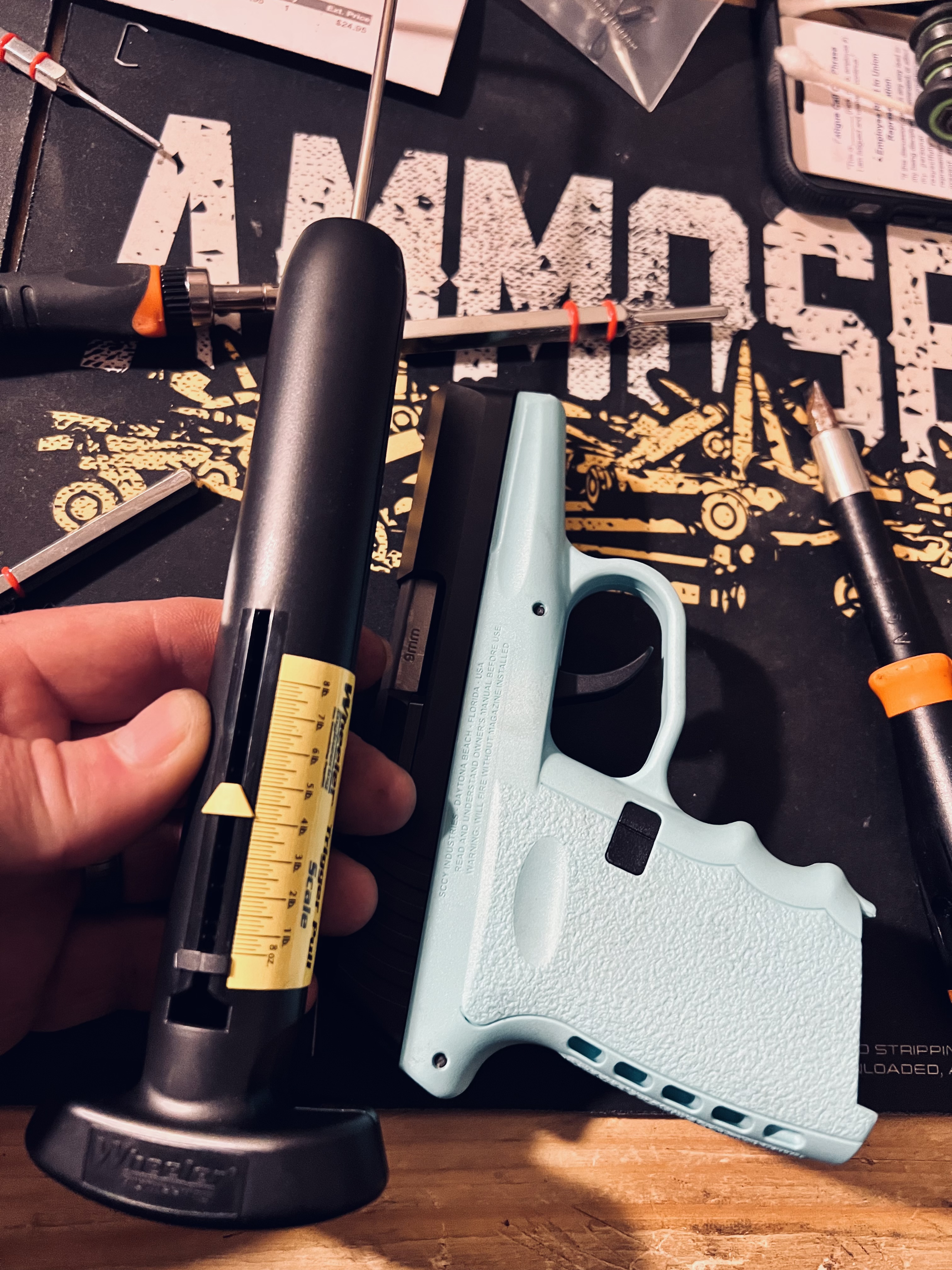

Before I installed this kit I took 5 measurements with my Wheeler digital trigger pull scale. The average was 8.0 lbs. After the kit went in the average of 5 measurements was 5.4 lbs. I will be ordering 2 more kits for my other CPX-2's
