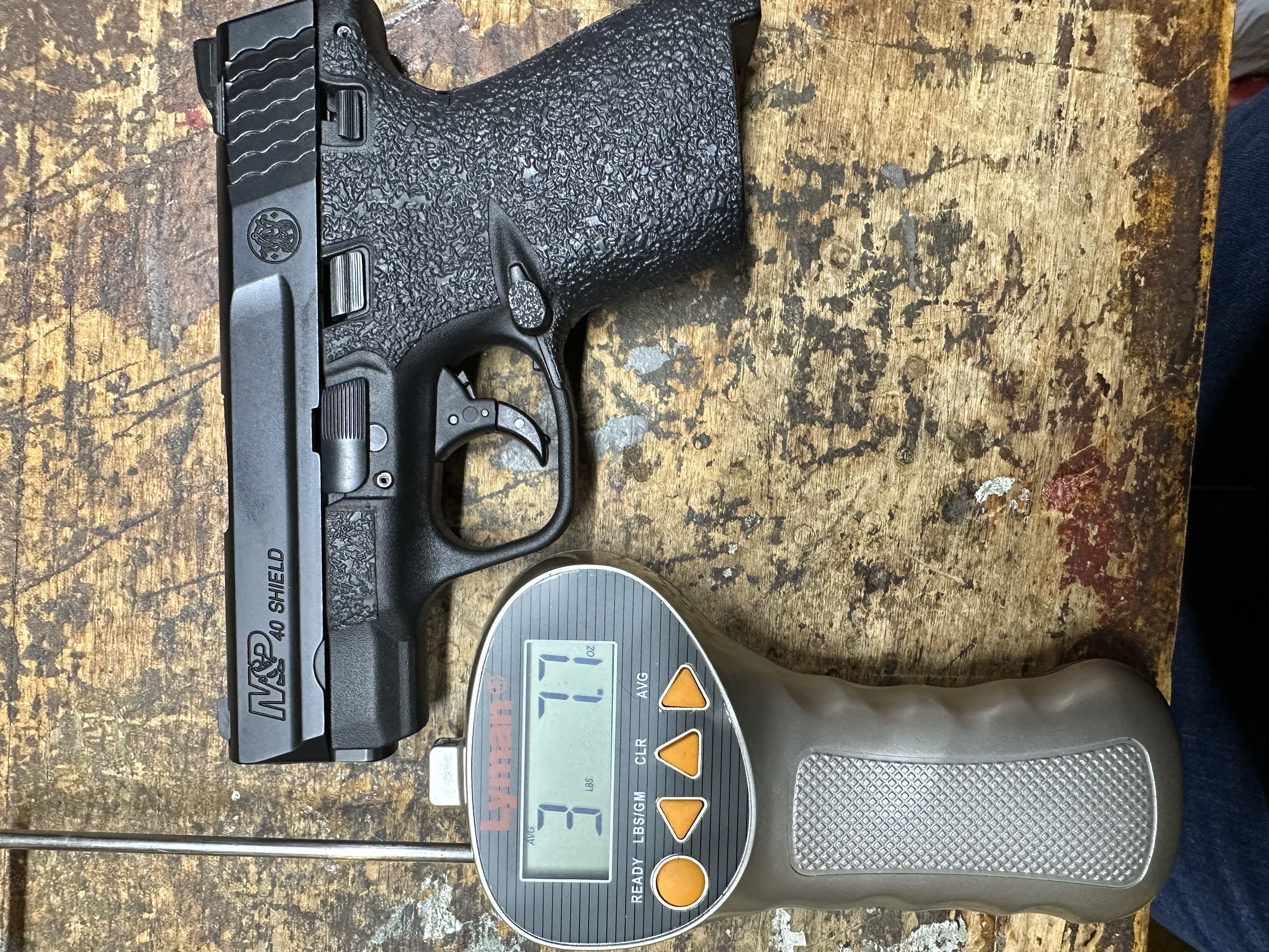

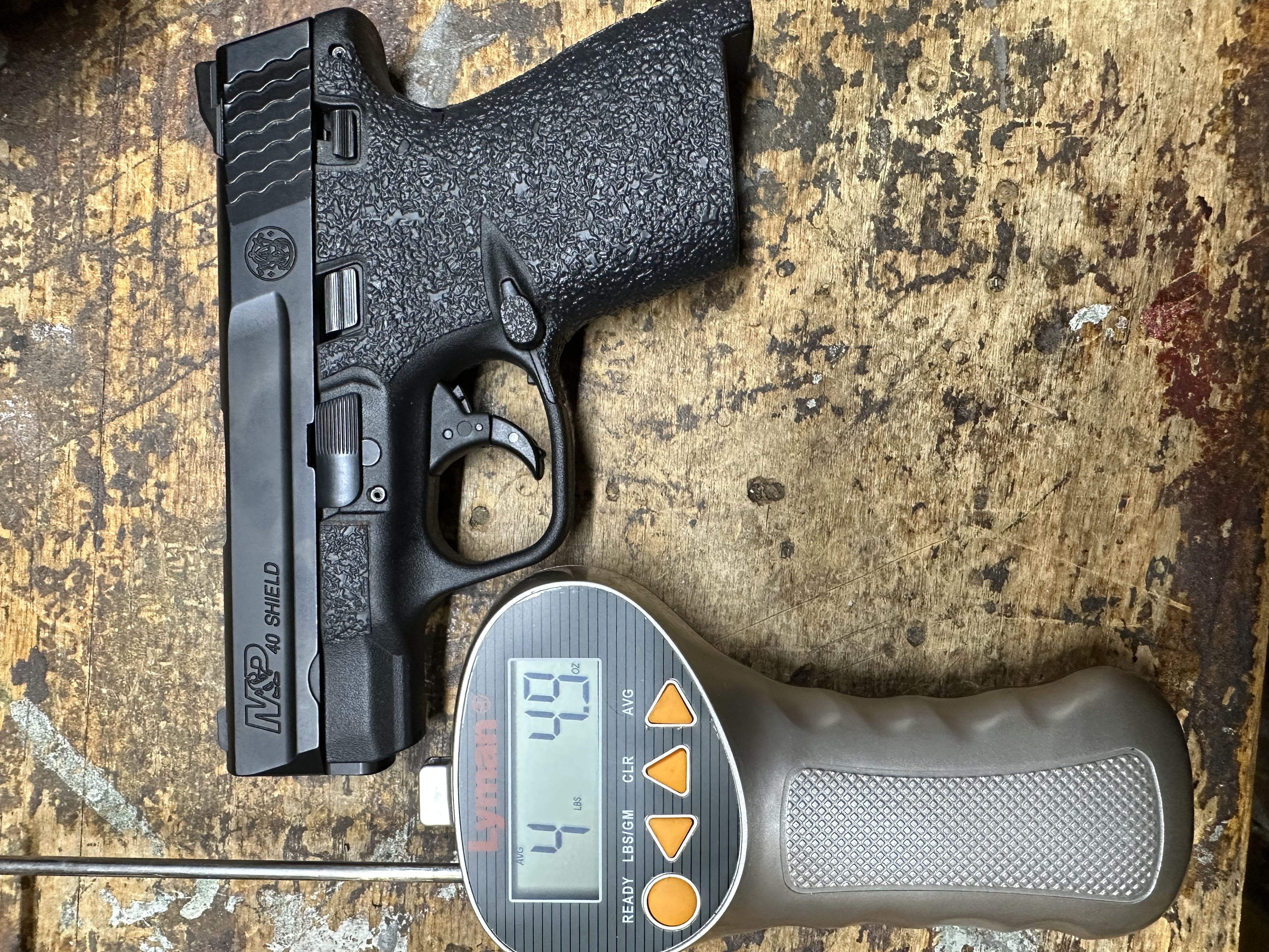

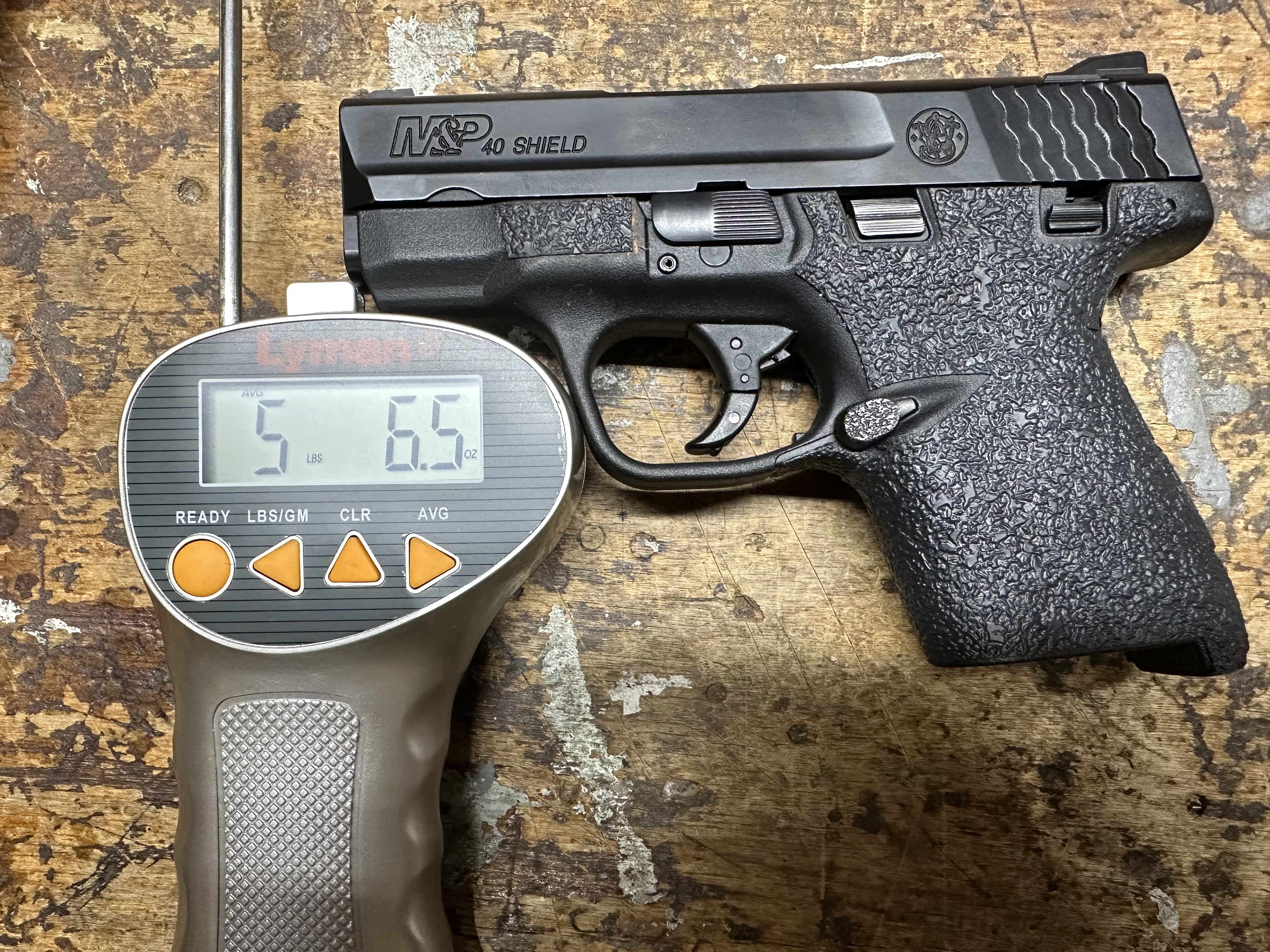

S&W S&P Shield 1.0 40S&W
Just installed the M-Carbo Trigger Spring Kit on my Shield 1.0 40S&W. Easy job. Did not install the striker block spring unfortunately. Could not get my sight to shift. Another day. Sanded all parts as in the vid. No polishing. Much cleaner and smoother trigger. Went from a 5.65lb average TP over 10 cycles to 4.49 average TP over 10 cycles. Much more consistent.
Thank you!!
S&W S&P Shield 1.0 40S&W (UPDATE)
Used a sight press and installed the Striker Block Spring.
Now down to 3.77lbs average TP over 10 cycles.
Amazing!!
Super clean and crisp.

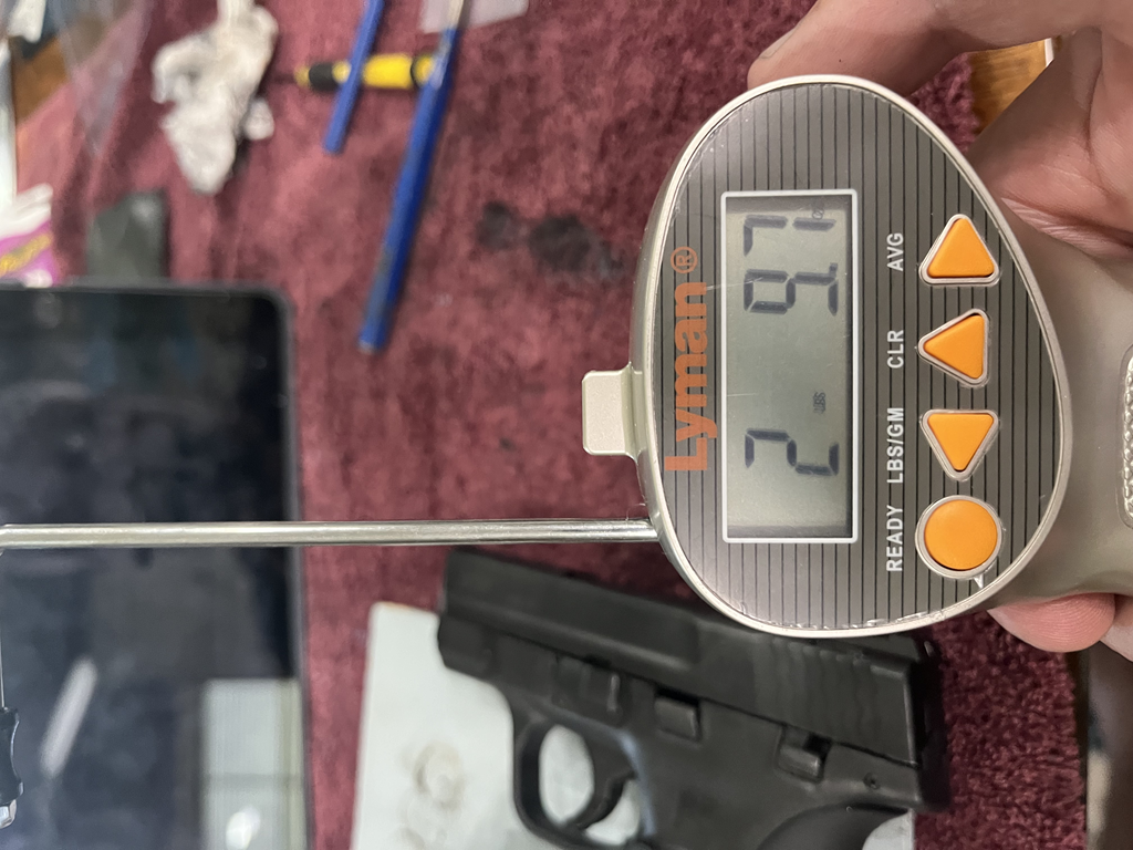

Installed the spring kit today and did the polishing. Watched the video a couple times prior over the past few weeks and did most from memory but did refer back a couple times. The video is excellent. The video shows a 2.0 Shield. Mine is a 1.0. I really didn’t see any difference between the two pistols other than mine had a thumb safety. The thumb safety proved not to be an issue and was easy to work around it leaving it in place. Night and day difference. Average trigger pull before was 5lbs 10oz’s. Average after the trigger job was 2lbs 9oz’s and it’s buttery smooth. More than pleased which is why I jumped on here to do a review. It’s well deserved. Fairly easy install. My right hand is about 50% crippled due to nerve damage and had no issues. The sights were a pain to remove (I removed front and back sight and replaced with XS sights along with this spring kit). Next hardest thing for me was getting the trigger pin back thru the frame and trigger. I kept fiddling with it then all the sudden it shot thru the holes and was in. Here are before & after pics.
S&W Shield (1.0) Spring Kit

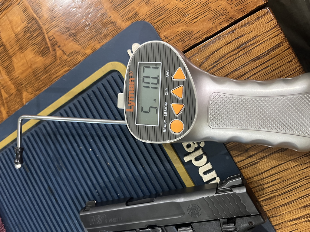

S&W Shield Trigger Kit
I have purchased many various kits from M CARBO.
My comments on the S&W Shield Trigger Kit.
Initial trigger pull 5lbs 6oz.
Cleaned and polished relevant parts per Chris's excellent video on the weapon.
Fitted the M CARBO trigger upgrade parts.
Final trigger pull 2lbs 12oz.
Very pleased. Excellent product once again by M CARBO.
Additional comments.
In the video' Chris advised putting the synthetic grease w/PTFE
all over the mechanism and various parts. In my humble opinion this is a mistake. After following this advice on a few of the various trigger mod kits from M CARBO i had to go back in and remove the grease and coat with CLP. Without doing so I could not achieve trigger pull as advertised.
Point in question, i followed the video and trigger pull was 4lbs 1oz. I cleaned away the grease and applied CLP and got 2lbs 12oz. This is not meant as a criticism, rather my experience on the builds so far.
