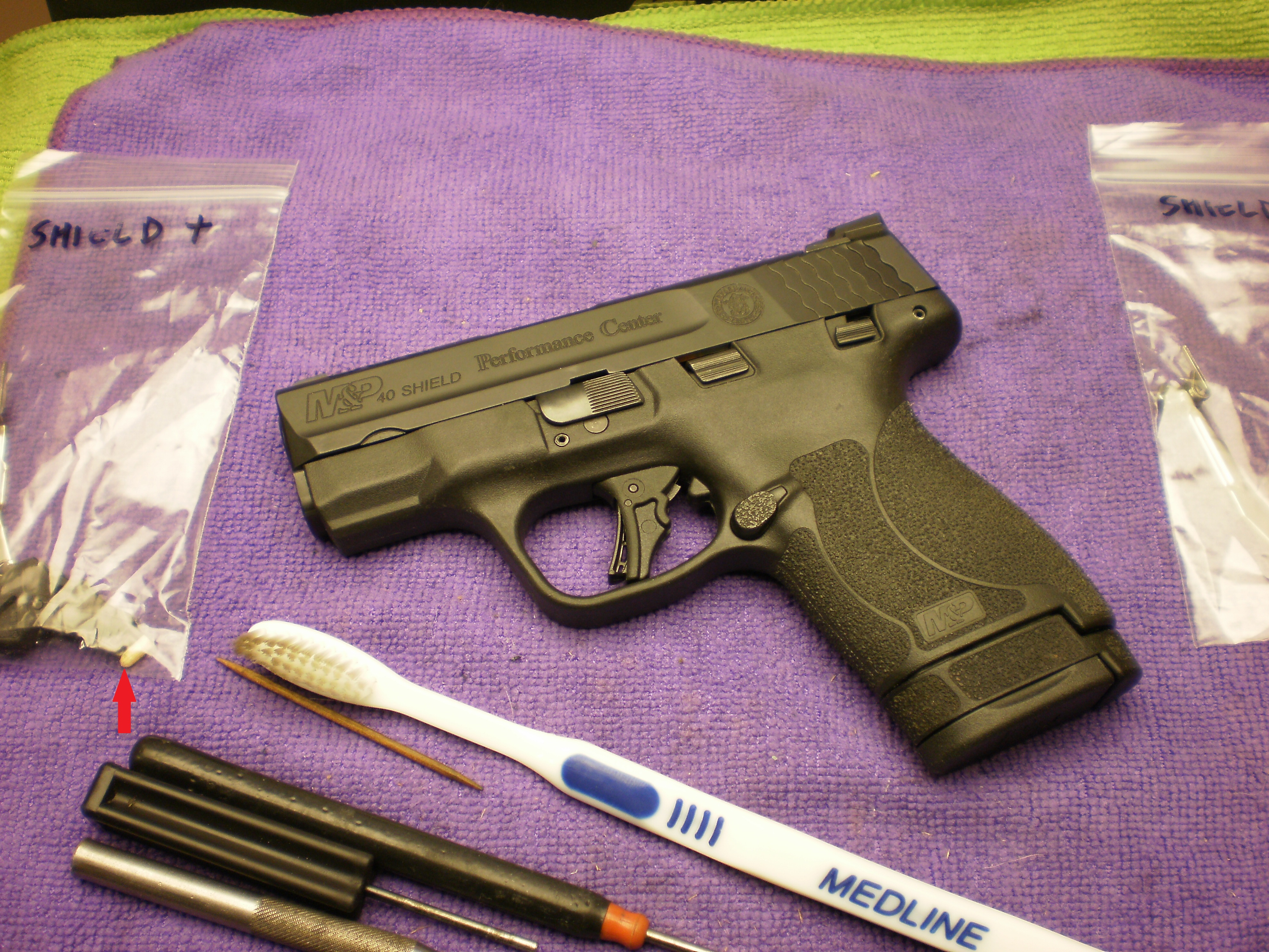

Performed installation of M&P Shield Trigger Spring Kit, very simple, spent about 45 min. polishing but the results were worth it. Trigger pull is much smoother, and has crystal break with little take up. Pull results recorded with a 3 pull average measured with a Wheeler Digital Trigger Pull Scale. Before Kit Pull was 4 lbs. 7.2 ounces After Kit Pull was reduced to 2 lbs. 4.7 Ounces. Highly recommend this kit it makes a not so good gun shoot a lot better. Thanks Again M*Carbo Great Job

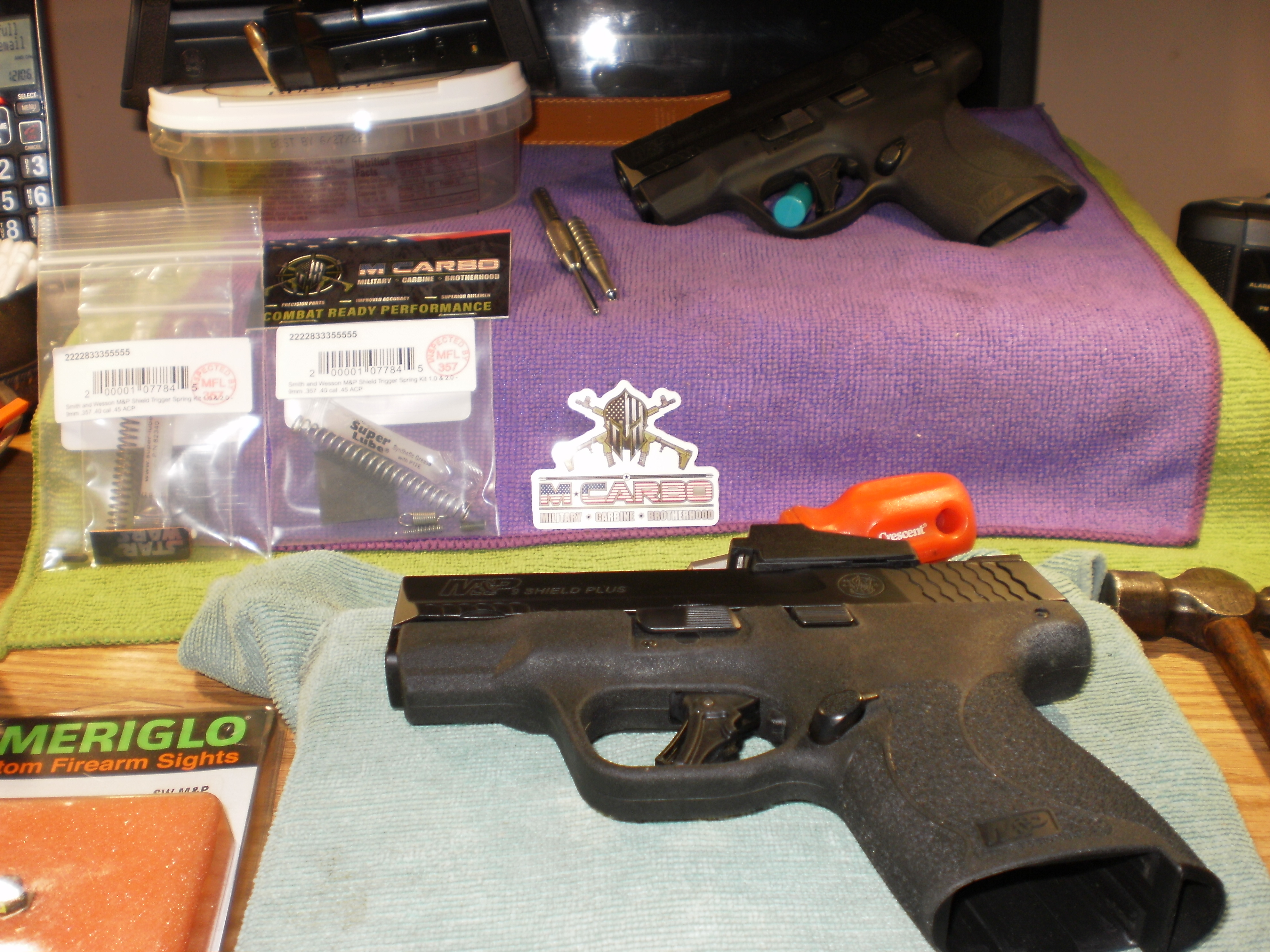

I just finished installing all the springs and cleaning up the machine marks on my first generation Shield. Previous to the upgrade I could not tactility feel the trigger reset. Afterwards it was definitely noticeable. The trigger pull was also greatly reduced. I did have some difficulty with the rear sight so make sure to use some PB Blaster or other penetrant prior to disassembly. The video was awesome and made this an easy job. Nice to get to know your gun intimately.

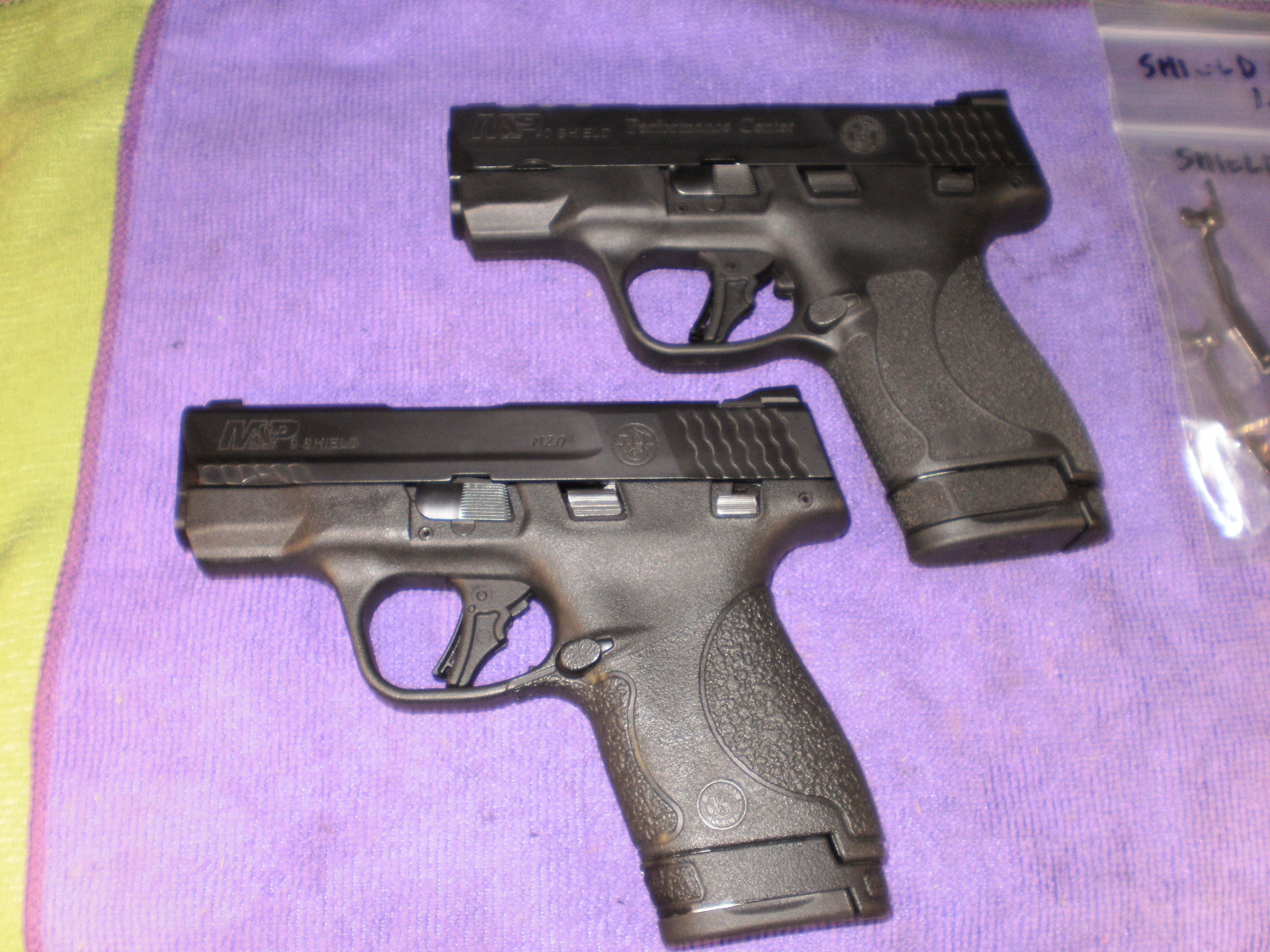

I have the 4” performance center shield and this kit fits flawlessly. The install was easy and straight forward. I didn’t have to do much polishing so it only took about 45 minutes with taking my time. I would like to note that I have the Hyve monarch trigger and the trigger pull is about the same spring pressure that is required for the Hyve trigger safety. If my finger is located correctly on the trigger there is not an issue, but if I’m choked up on the trigger or my pad isn’t perfectly flat the safety does not disengage before it hits the frame. Not a huge issue and it might even help me work on my trigger finger placement and control. So far I am glad I installed the kit.
Was a fun and great kit to do. Had few issues with the sight removal but got past that.. Project turned out nice and shiny and looks and feels great. Product and install video are fabulous. Thank you to MCARBO.

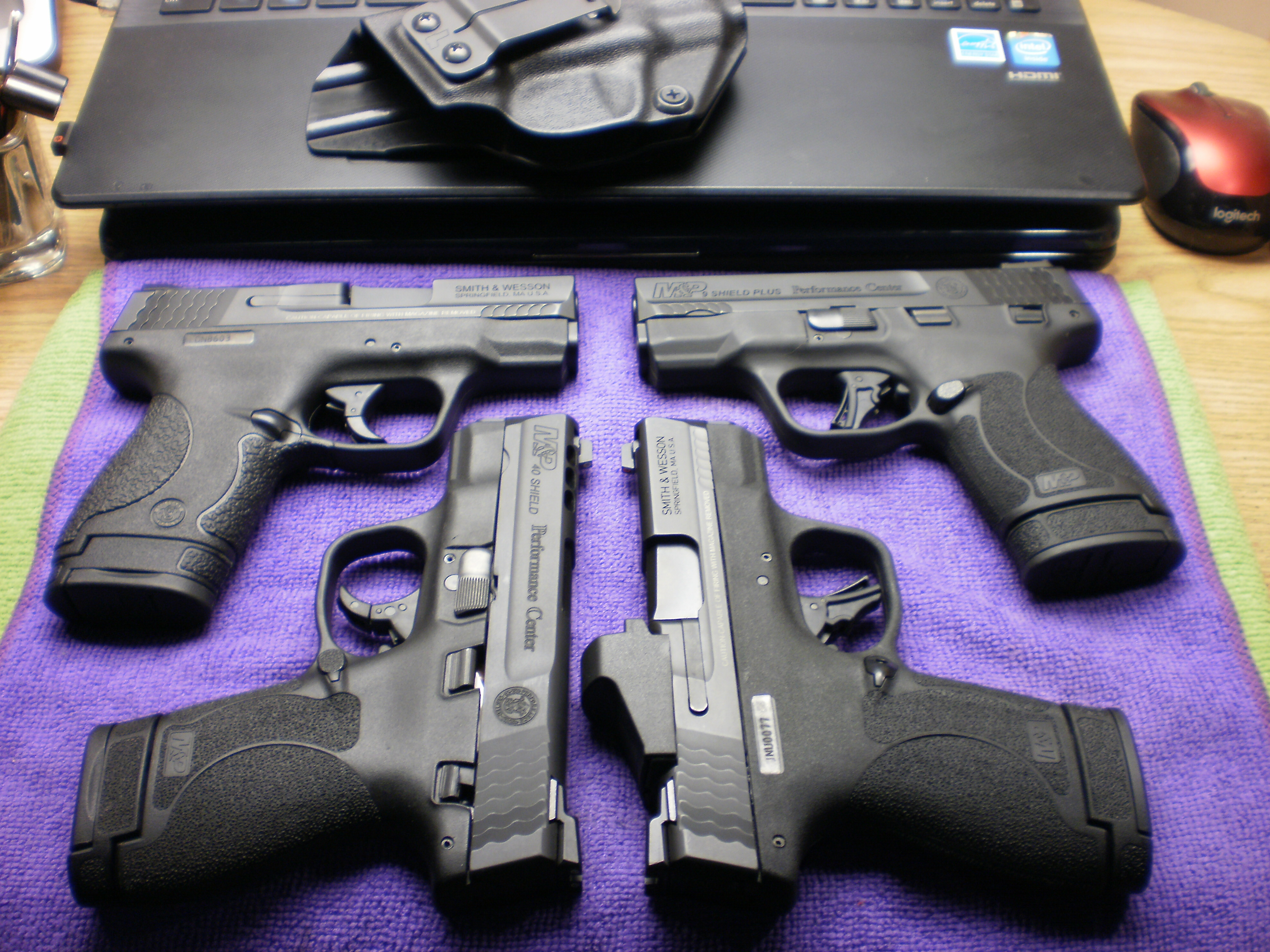

First off, this kit will also fit a Shield Plus & will fit a M1.0 & M2.0 Shield Too!! = Same Exact Springs JFYI It helped lighten the stroke on the trigger with the reduced power sear & striker springs & on the Performance Center pistols the factory return springs where lighter than the M*CARBO I ordered two kits for two of my four M&P Shields & should have ordered three total Have a bone stock M1.0 9mm that now is in need = Next Order
