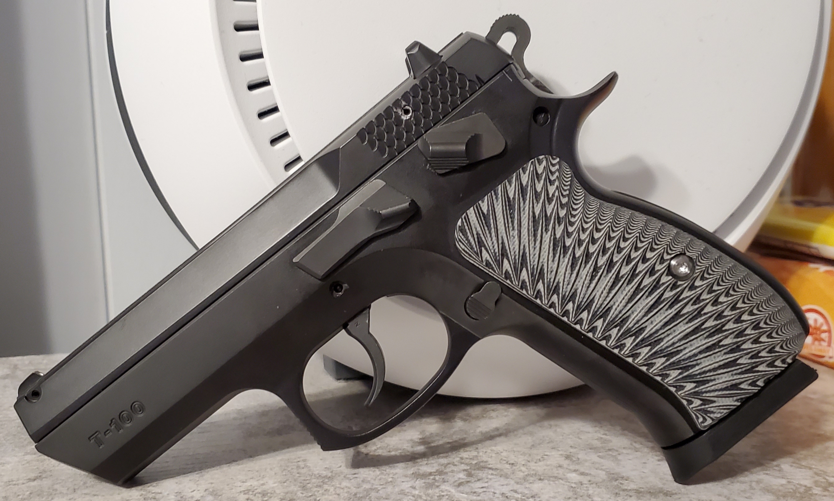

Tristan T-100
MCARBO Customer Service was just fantastic. Their product worked flawlessly. They directed me to get the CZ 75 Compact Spring Kit. I replaced everything but the Hammer Spring. This allowed me to keep the DA 10.5lbs and make the SA 2.25lbs. Just an amazing trigger. I can't thank MCARBO enough.
Tristar (Canik) C-100
This kit does work on a C-100 just fine with the exception of the firing pin retaining pin. The one in the kit is just slightly too big and will not fit so don't try and force it in...just reuse your existing pin. Otherwise this kit transformed the stock DA heavy pull to a very nice and usable pull as well as improving the SA pull weight noticeably.
Tristar C100 Spring Replacement
I put this kit in my Tristar C-100. I followed the directions on the video. It wasn’t too bad installing the kit. Take your time the process can’t be rushed.
After installation, the results was super awesome. I clipped a few coils off the hammer spring because it was binding up. I believe the missing coils made the trigger pull even sweeter. I totally recommend this upgrade for any CZ75 owner or CZ75 clone owners. Pistols trigger pull is like a dream.
TriStar T-100 100% Compatibility
First I'd like to say that this is the best upgrade you can purchase for your TriStar T-100! The video was perfect and extremely detailed. I was concerned, about fitment considering this spring kits was for a CZ 75 compact and the TriStar is a CZ 75 clone made by Canik with some minor manufacturing differences, but everything dropped in no problems. After installing the new springs, I decided to test out my handy work, by running 2x 32 rounds promags filled with Wolf steel cheap stuff and 15 rounds of more Wolf steel from a Mecgar magazine. I did two mag dumps in rapid fire with ZERO malfunctions! No light primer strikes, no failure to feed, no problems what so ever from installing these lighter springs. I think it safe to say that if eats wolf ammo and had no issues with the promag magazine this gun can be trusted with premium carry ammo and to work if your life depends on it. I love this kit, makes rapid fire or follow up shots easier and smoother. I was able to keep all my rounds in a tight pattern when compared to my friends stock TriStar T-100. So if you have a TriStar T-100 and wondering if it will fit the answer is yes!
