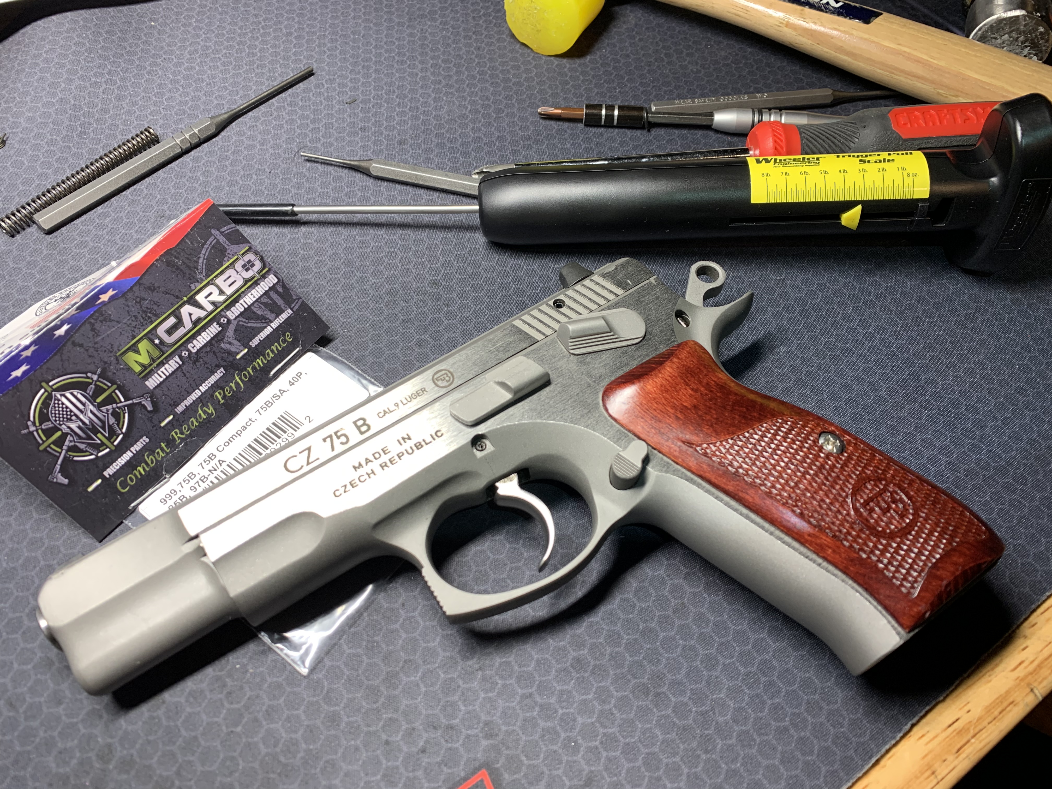

Trigger Butter...I’m back in love with my CZ75B
Trigger Deets for my CZ75B Limited Edition:
-Double Action Pull: Pre-10.5lbs; Post-7.2lbs
-Single Action Pull: Pre-5.5lbs; Post-3.2lbs
This spring set upgrade completed an otherwise amazing pistol. I love the solid steel of the CZ but the trigger was always a little heavy. Additionally, I found the video very easy to follow with the only variation being, I have a ambi-safety and the video only showed a left side safety. This was a quick pivot to another video but an easy disassembly/reassembly overall. Don’t hesitate to buy this and allot probably an hour for hobbyist-level gun modifying skills. Less for someone more familiar with this particular platform. Way to go MCARBO! I’ll be back...
