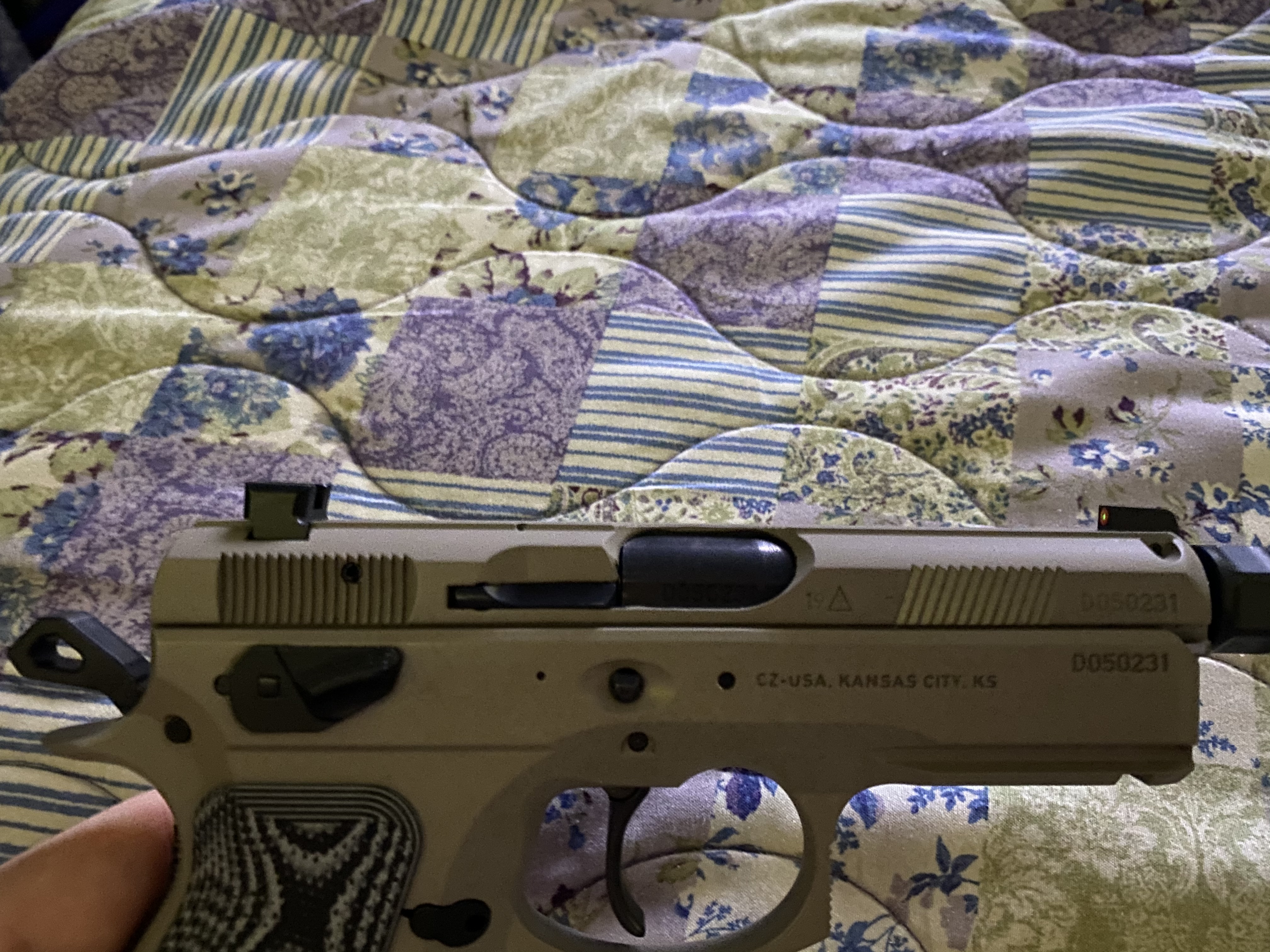

SP-01
Just finished installing the kit on my SP-01 Tactical. As good as the kit is the MCARBO videos are the best on the internet as they are clear, concise and 100% accurate especially on the search cage. The only thing that they cannot help with is how tight some of the pins can be. Great products in every way. Customer service is outstanding.
