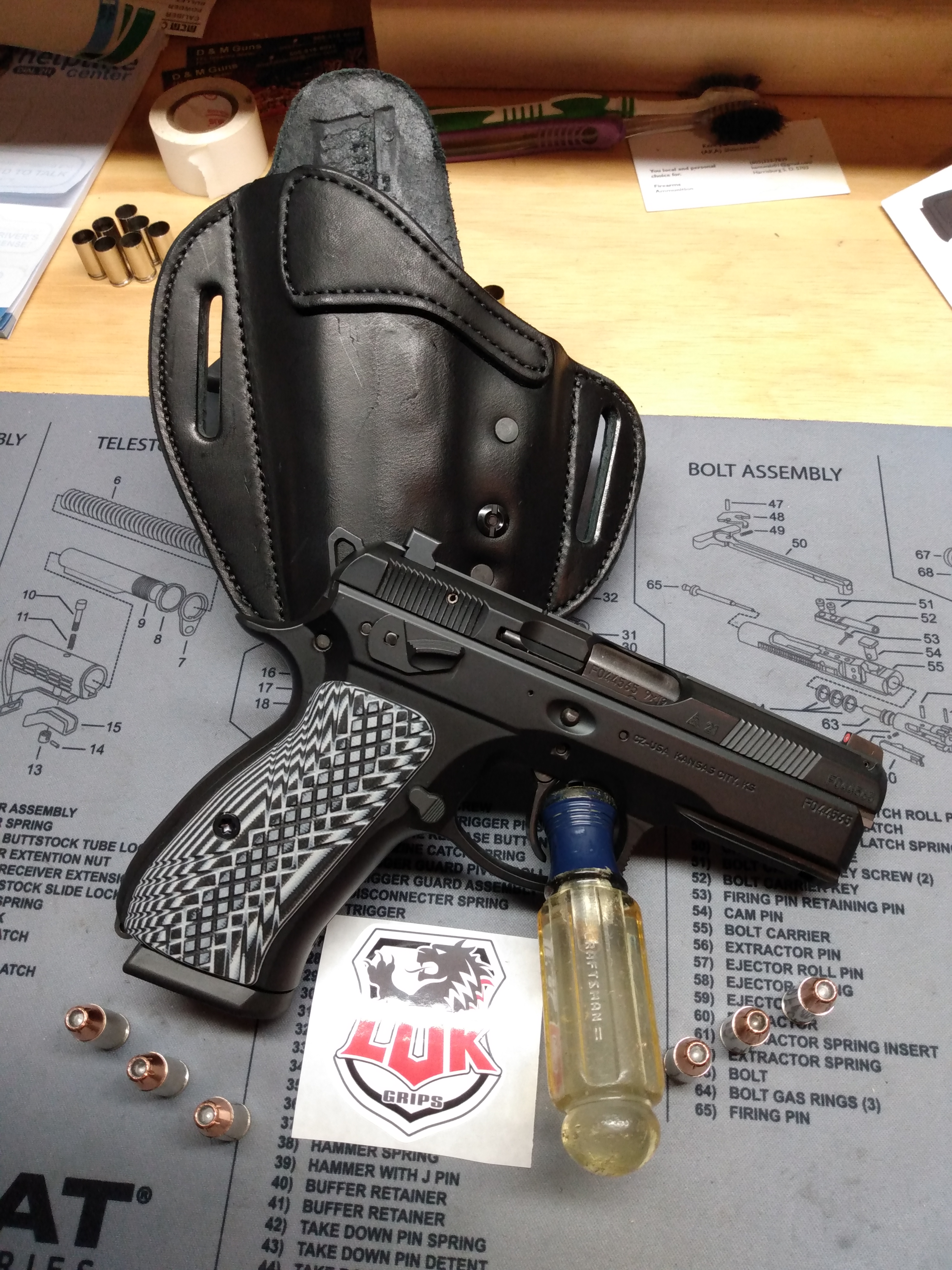

I got this for my sp01 that I love way way more than my glock 17 sorry glock lovers 😬😬 but in all seriousness yes it did just what the YouTube video said. This was my first gunsmithing and I have to say that it didn’t go as smooth as the video. I had a little trouble on the trigger spring. I couldn’t get it to align right to put the pin in.maybe because the hammer was pulled back and I couldn’t get it to release because the trigger was loose but after carefully inspecting and learning the functions I got it to release and then I got the pin in. Everything else that I thought would be hard like the sear went pretty smooth. After about an hour later I got everything installed and my sp01 feel like a totally different gun. I don’t have a measuring device so I don’t know the pounds difference but I don’t need to measure because I can definitely feel the difference..Love this upgrade and really appreciate the prompt response on email from these guys at Mcarbo.. customer service on the phone was really helpful and they were very nice. I do recommend to others.
One last thing I would like to fix is that there’s like a little wiggle or travel on the trigger before you feel the stop and see movement on the hammer. I don’t know if there’s a way to fix this but I will definitely be calling Mcarbo for some ideas.
