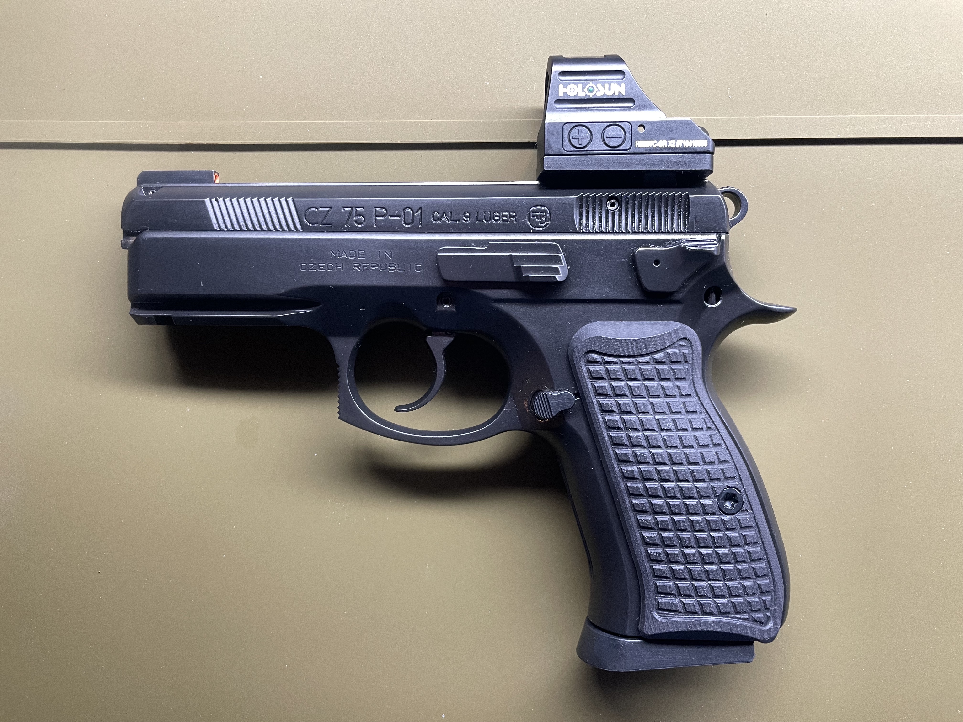

Just for fun posting picture of one of my P01s that I put a red dot on, its kind of fun I use this P01 most of the time its like 12 years old. I did not have the heart to have the gun milled, kind of wanted to keep it "Stock". So the mount goes into the dovetail, go it on amazon. Took a little adjusting but works great. Red dots are nice, fun but not something you want to holster, so my other P01 is plain Jane
