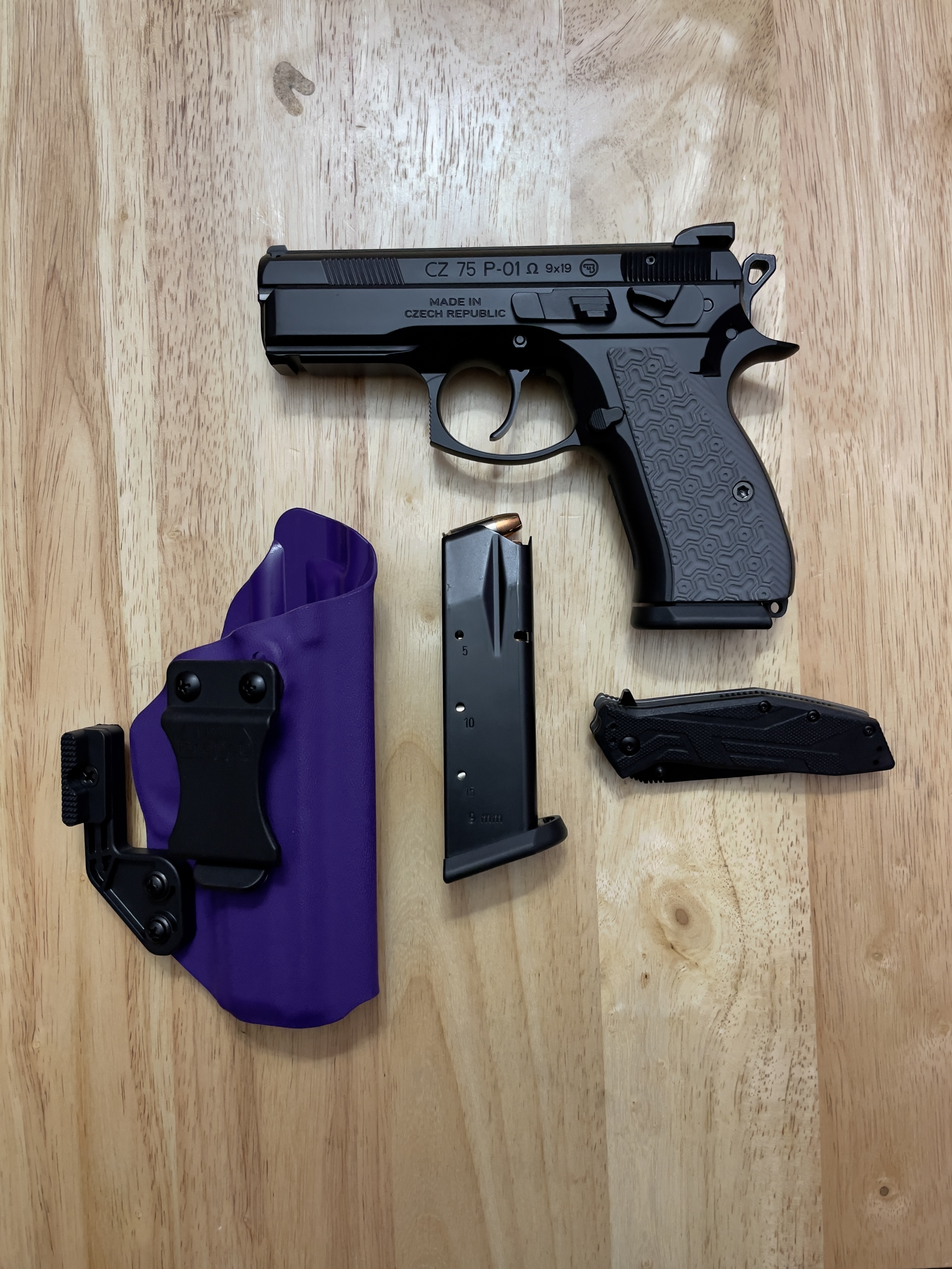

I install this trigger kit on my CZ 75 P01 Omega and fit perfect and the communication between me and MCARBO was very nice so thank you for everything

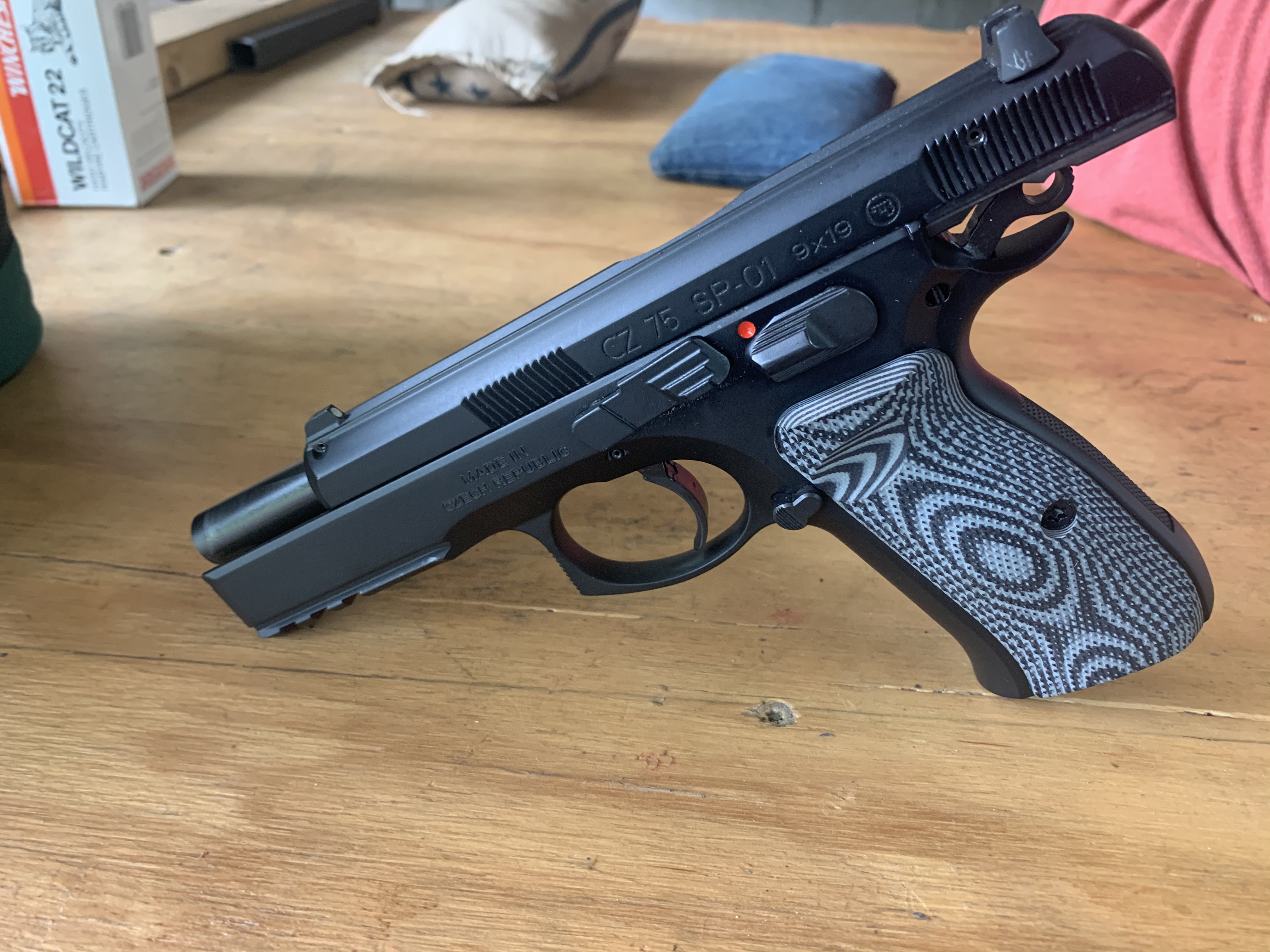

Ordered the spring kit for the SP-01 and the experience was great. I was well informed on product info and I got the correct parts by entering my gun info into the online ordering process... shipping was fast and again well informed as I got a tracking number very quickly... Fit and finish was awesome... great drop in parts...

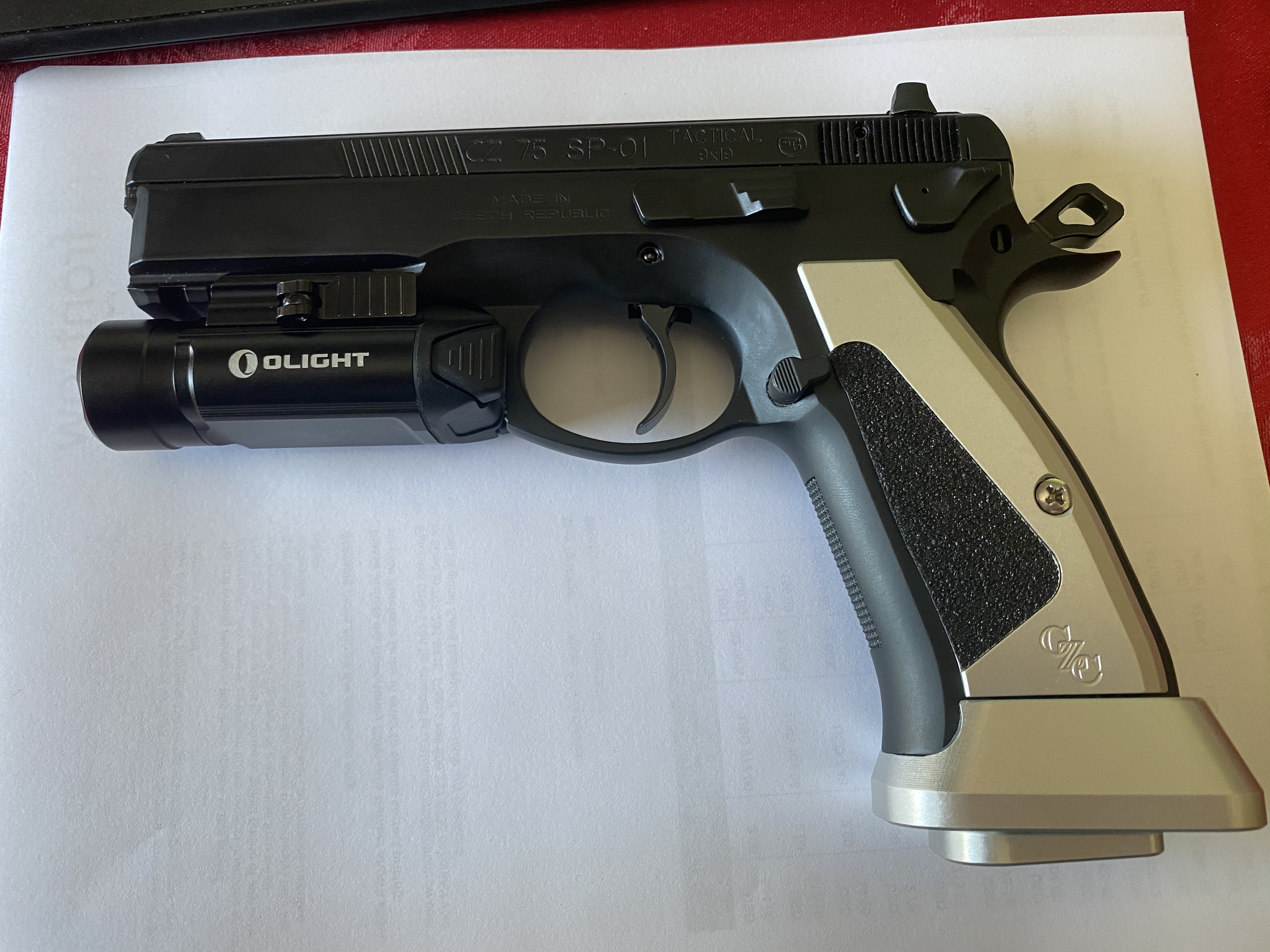

First let say that i love your company and what you make. I have a 2006 CZ Sp01. I installed one of your trigger kits. It went very well and smoothly, but after install i had to do a trigger adjustment on the trigger. The long pull would not fire the hammer. I still have long trigger reset but i only have one adjustment screw on my trigger. It works great now but still has a long reset. If you have any suggestions i would love hear from you. I do, hover know that some folks out there would install your kit be very Upset that gun would not know that the trigger would need to be readjusted. Maybe it needs to be said on videos. Thanks and have a great d
