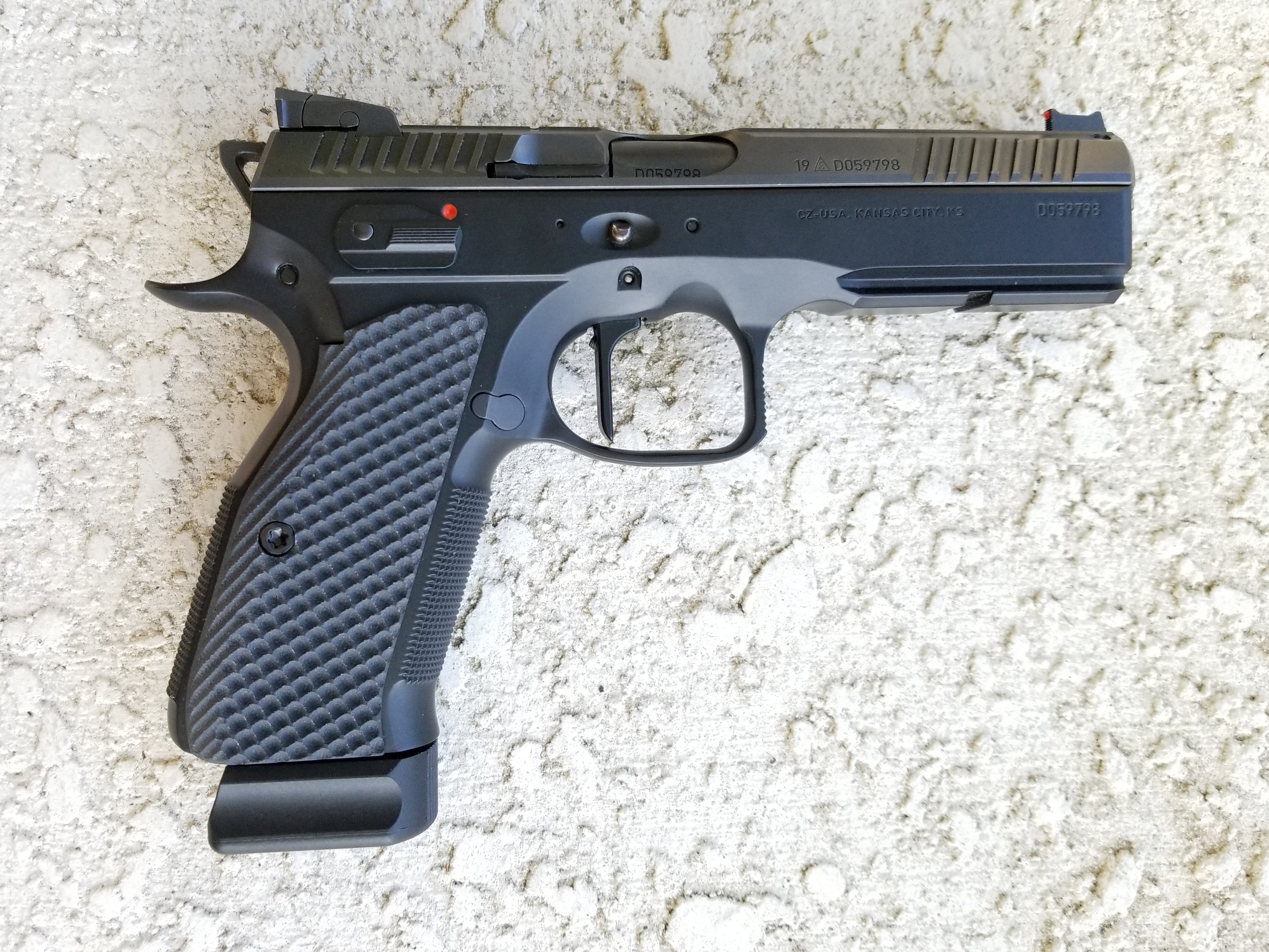

I installed the trigger kit on Tuesday and went to the range on Wednesday and Thursday.
I ordered two kits, one for my plain Jane CZ75b and one for my polished stainless CZ75b. The installation video helped a lot since I never installed a custom spring kit before, and everything went well, but it took a bit longer to complete. I haven't installed the second kit yet, that will be next week.
After completing the installation and functional check, I was really surprised how nice the trigger felt in single and double action. My homemade digital trigger pull gauge read ~2.7lbs in SA and ~7lbs in DA, great improvement over the factory trigger.
I went to the range the following two days to make sure there wasn't any ignition failures on known hard primer factory ammo. Four hundred rounds later, not one light strike.
This MCARBO trigger kit transformed my CZ75b, and the trigger is now very similar to my Shadow 2's and Shadow Orange. I might be exaggerating a bit, but you get the picture.
