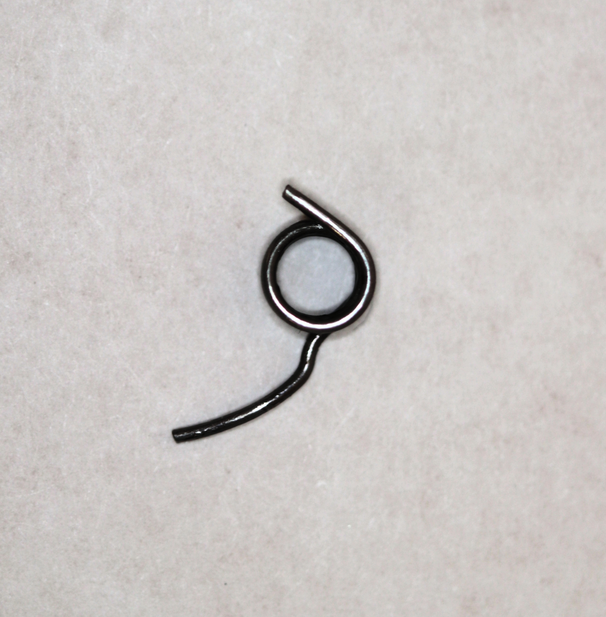

Ended up having to do it twice, because the MCARBO supplied sear spring was out of spec (the short leg of the spring was a little too short to stay engaged on the sear. The coil diameter was a bit larger than factory, as well).
Reinstalled the factory sear spring. The other springs still reduced the DA pull from over 12#+(!) to 10.5, and brought the SA down to 3.2#.
