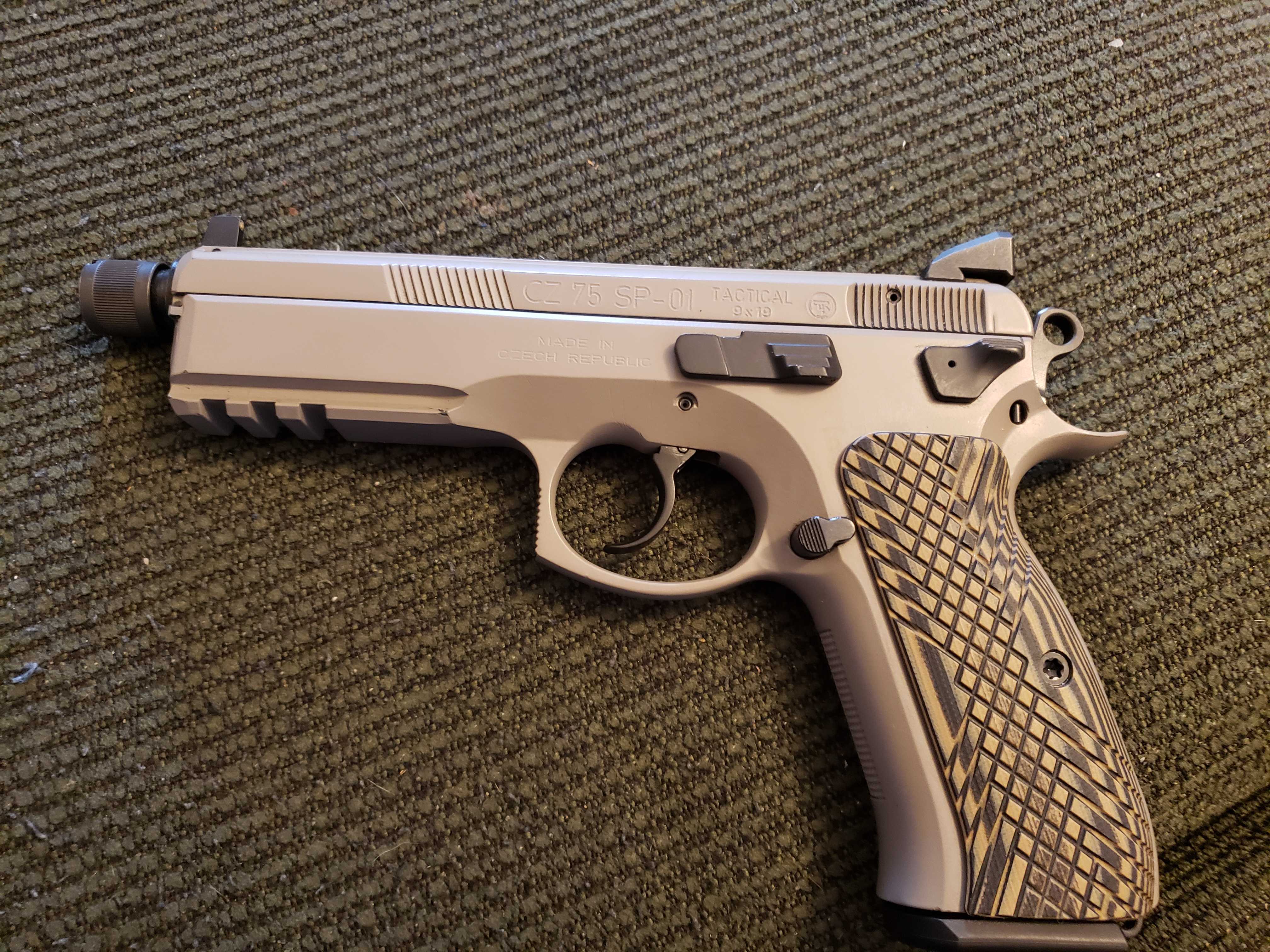

Thanking mcarbo for putting up such a good install video, first of all. I bought a set of better punches than I had, even found a metric set which was nice. And a block to hammer on. With those things and the instructional video, installation was pretty straight forward. I took it out today and put 500 rounds thru my SP-01 safety model. Boy what a pleasure to shoot! So much nicer than factory! And for such a great price.
