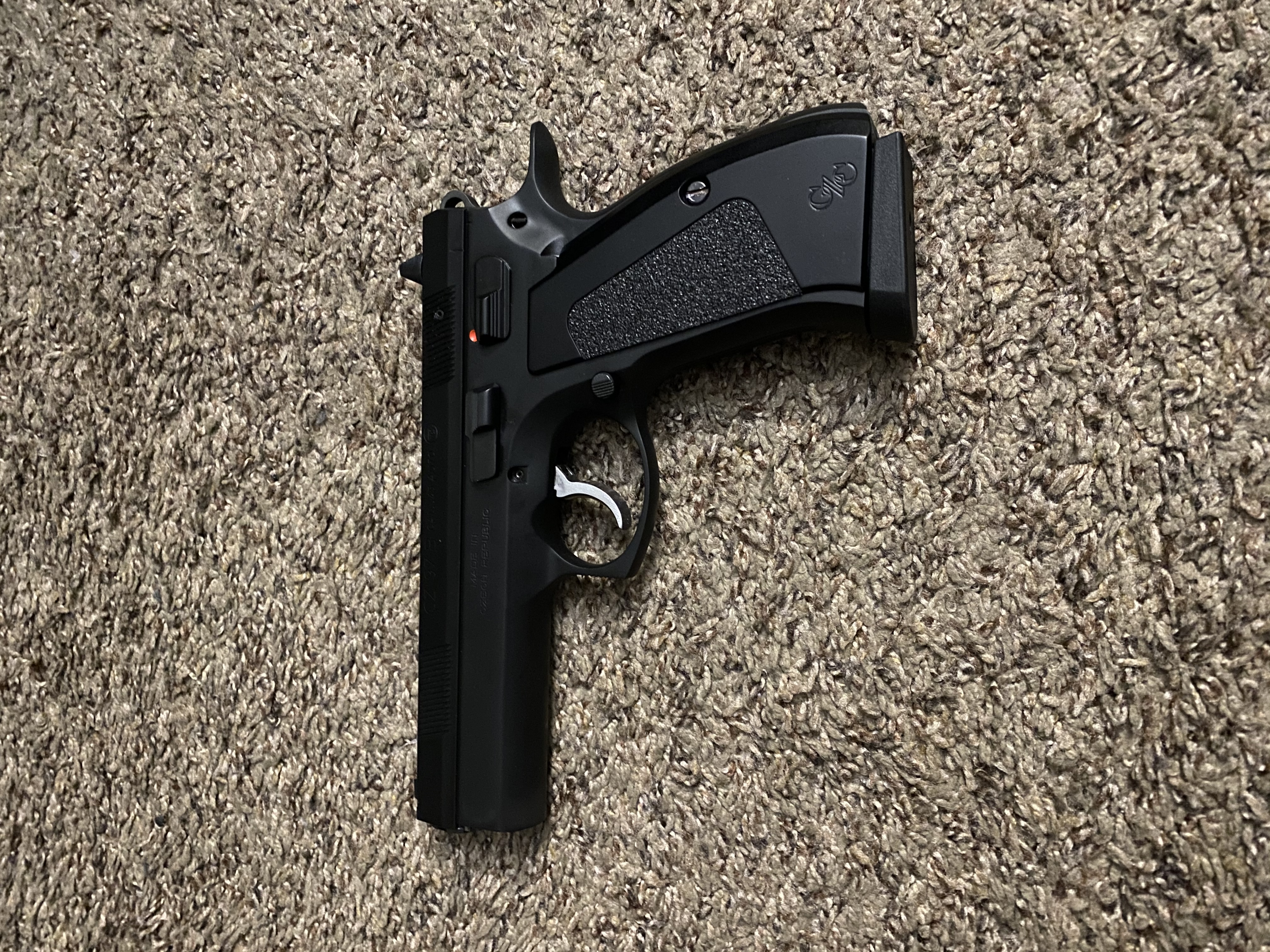

Cz75 spring kit installed in an SP01
I received my spring in about 4 days from day of order.
Installation went well, took about 35 minutes. My CZ went from an 11lb double action to a 7.5/8lb trigger pull and 4.5lb to a 3.5lb single action trigger pull. As my CZ only has about a hundred rounds through it, I'm confident it will only get better as parts wear in. In my opinion, the CZ spring kit is well worth the price
and more.
If you have a CZ and want a better trigger, check it out.
