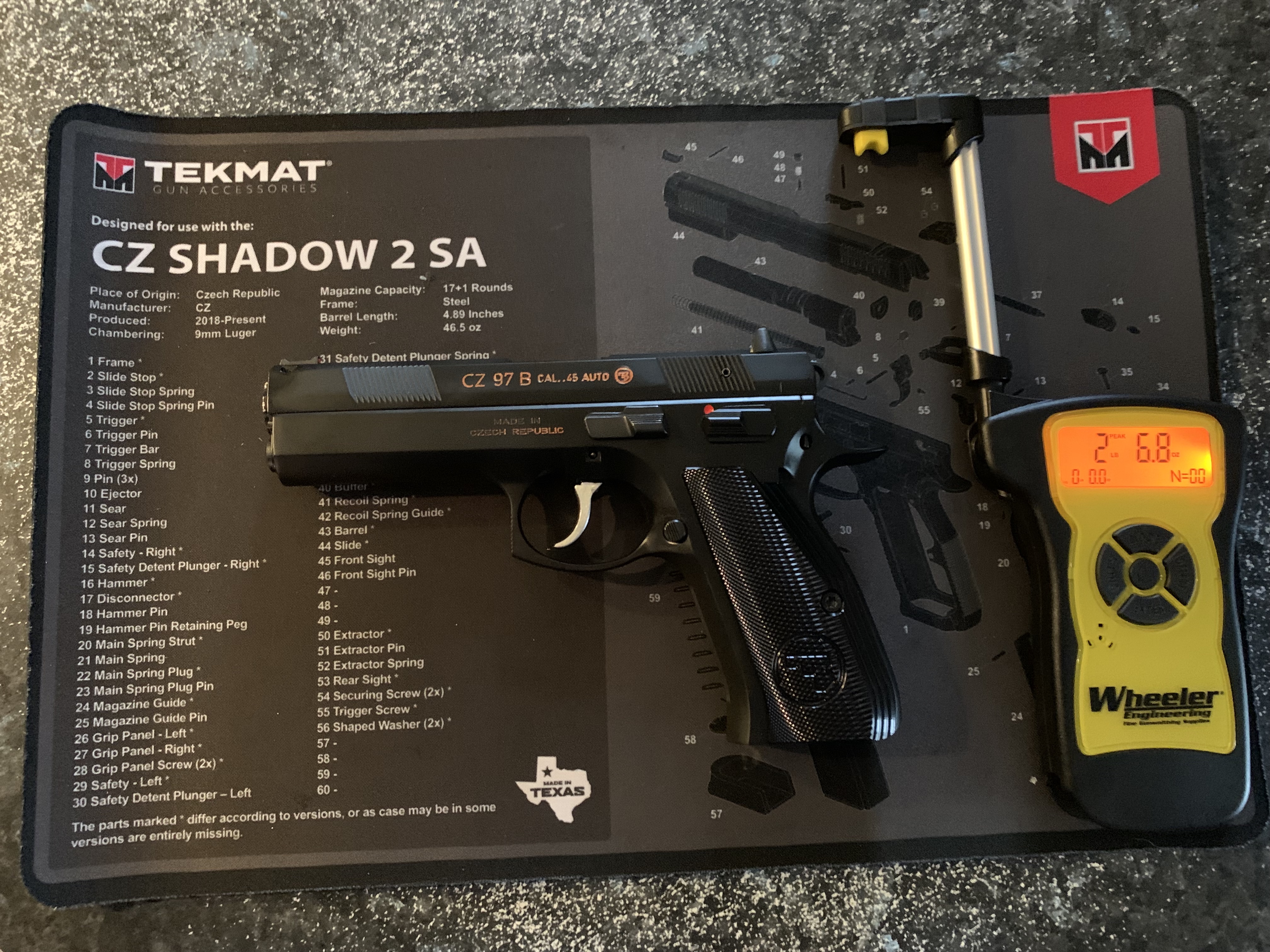

CZ 97B SA Pull 10.5 ounces - DA Pull 2.5 pounds
I ordered this kit and the floating pin, given I wanted to changed the clothes out on my "Barbie Gun" (Shadow 2) and figured it was an opportune time for an upgrade. As shallow as it sounds I decided to try MCarbo solely based on a few reviews and Chris' Rockwell 50 statement of OVERKILL...hard as axe head. A la Tool Time grunt worthy. Once I did the Shadow 2 I had to do the 97B as well, just seemed the right thing to do.

Check pull pics attached, I was amazed how light the pull got, so I checked and triple-checked and took the highest readings. Wicked reduction and still shoots fantastic.
