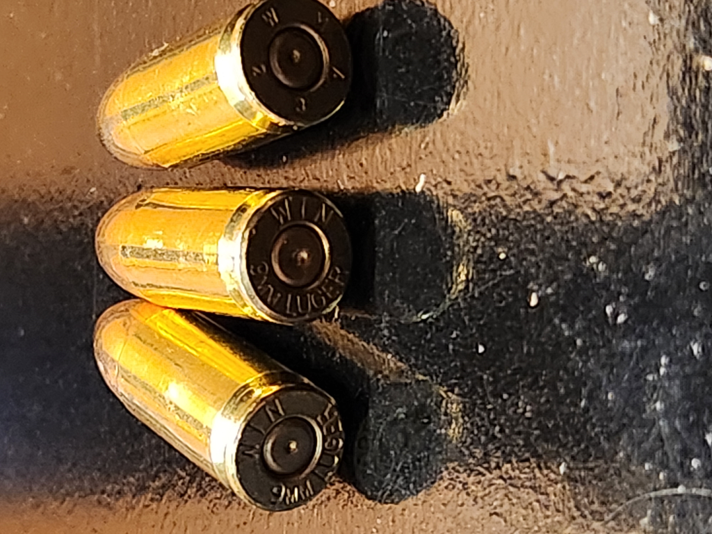

I had an issue at the range though with several failures to fire. Was using good ammo, checked all the standard issues, firing pin cavity, and cleaned spring and pin well, but 2-4 rounds from almost every magazine had light strikes. I even replaced factory springs in the slide with no effect. I saw someone else mentioned an extended firing pin from Cajun Gun Works. Their part #61050 Extended Firing Pin, its currently $25.00 They say with the lighter springs and hammer spring, you may need this for reliable ignition. This did the trick, after installing this I have had 0 issues. I love the end results......would have been a perfect "5" stars if Mcarbo sold an extended firing pin
