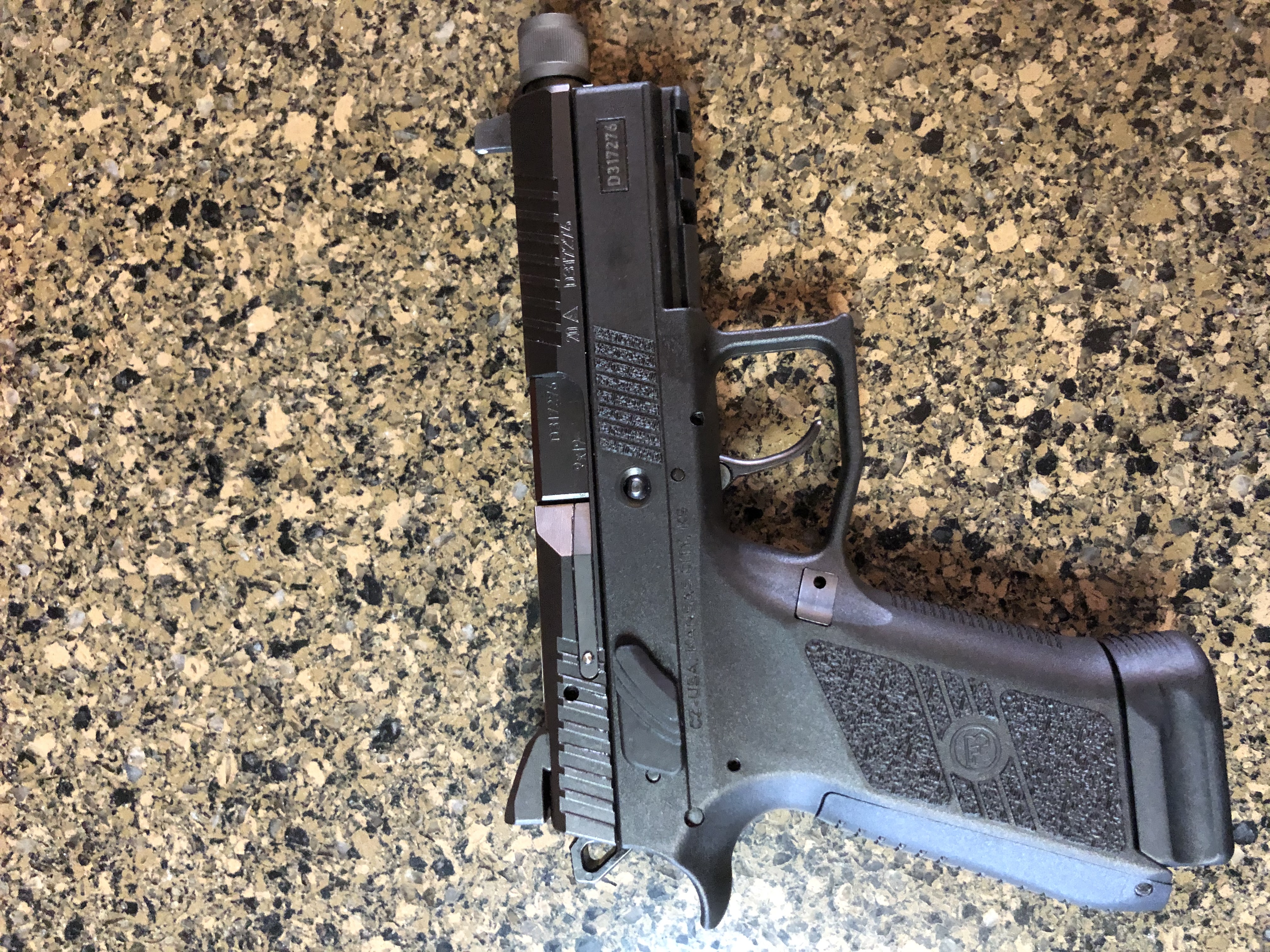

My CZ P09
Been carrying my P09 for about 2 years got about 2500 rounds on it. Installed the kit today took about 1 hour and change. The change was chasing down the spring under the ejector. Other than that piece of cake. The results is most definitely worth price and effort. Don't have a trigger gauge but I can feel the difference. Much , much better. Got the kit Friday June 19th did it today along with battery change for my RMR. Done and done.
