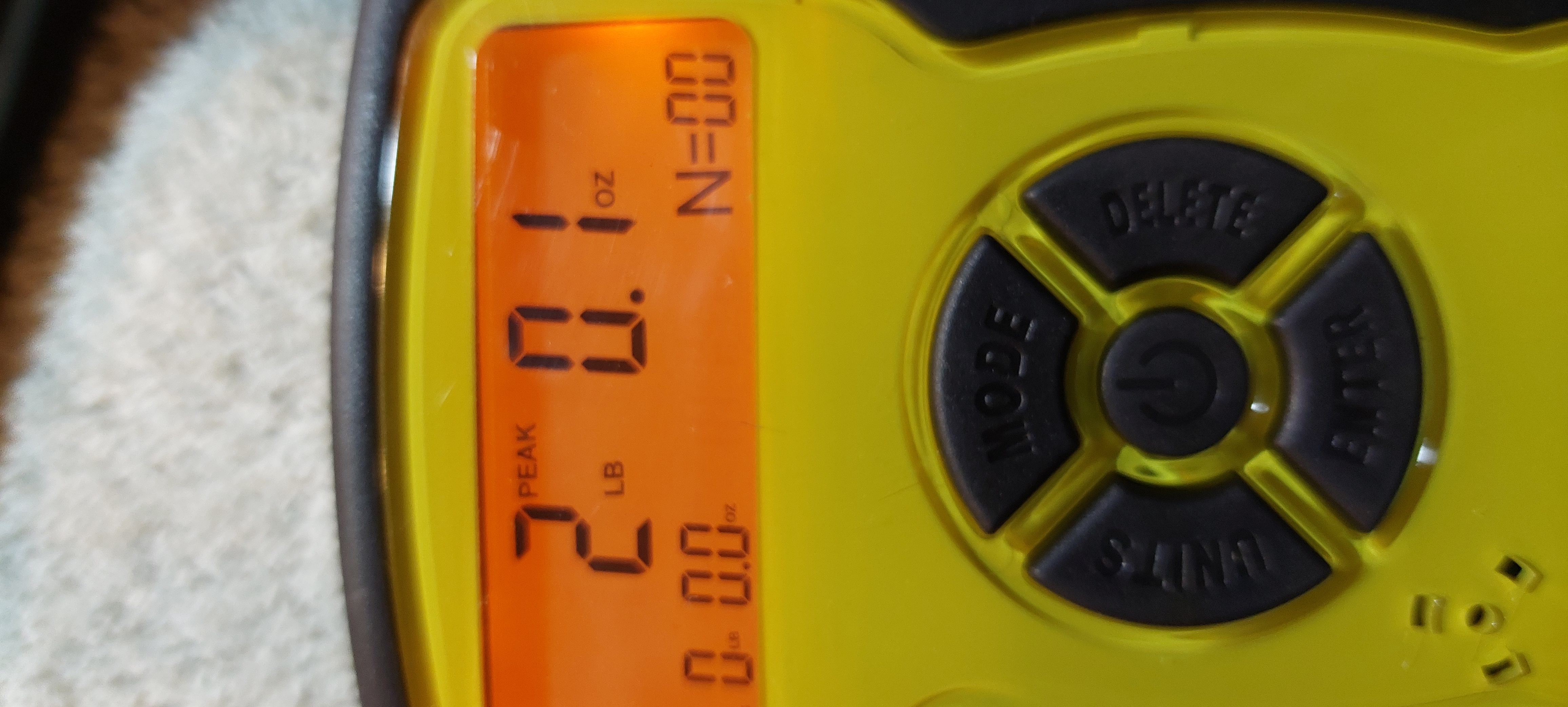

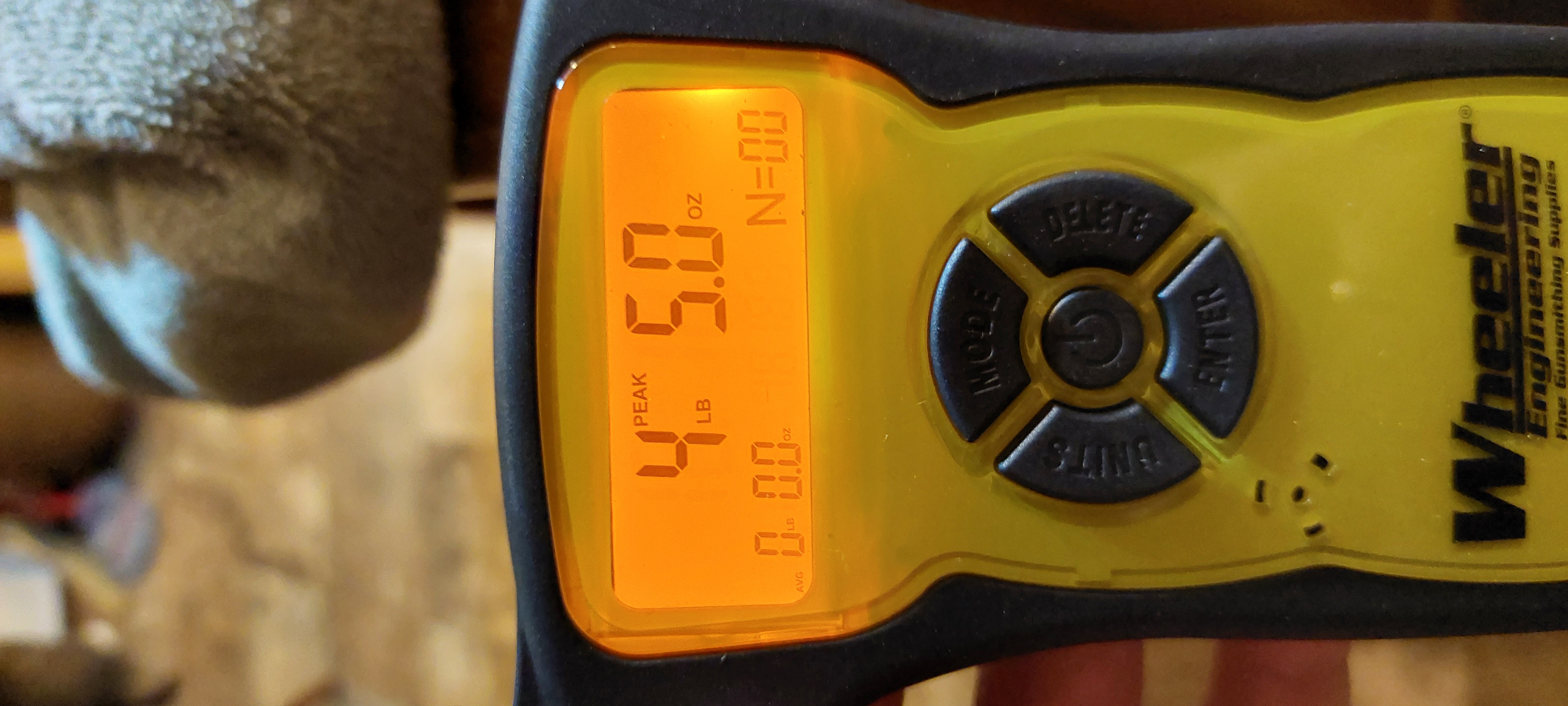

The trigger in my 917 was pretty stiff at 4.5 oz. After changing the spring,(super quick and easy), the weight registered 2.01 oz. What a difference! I will be changing more trigger springs in the future. Order, you won't be disappointed!
