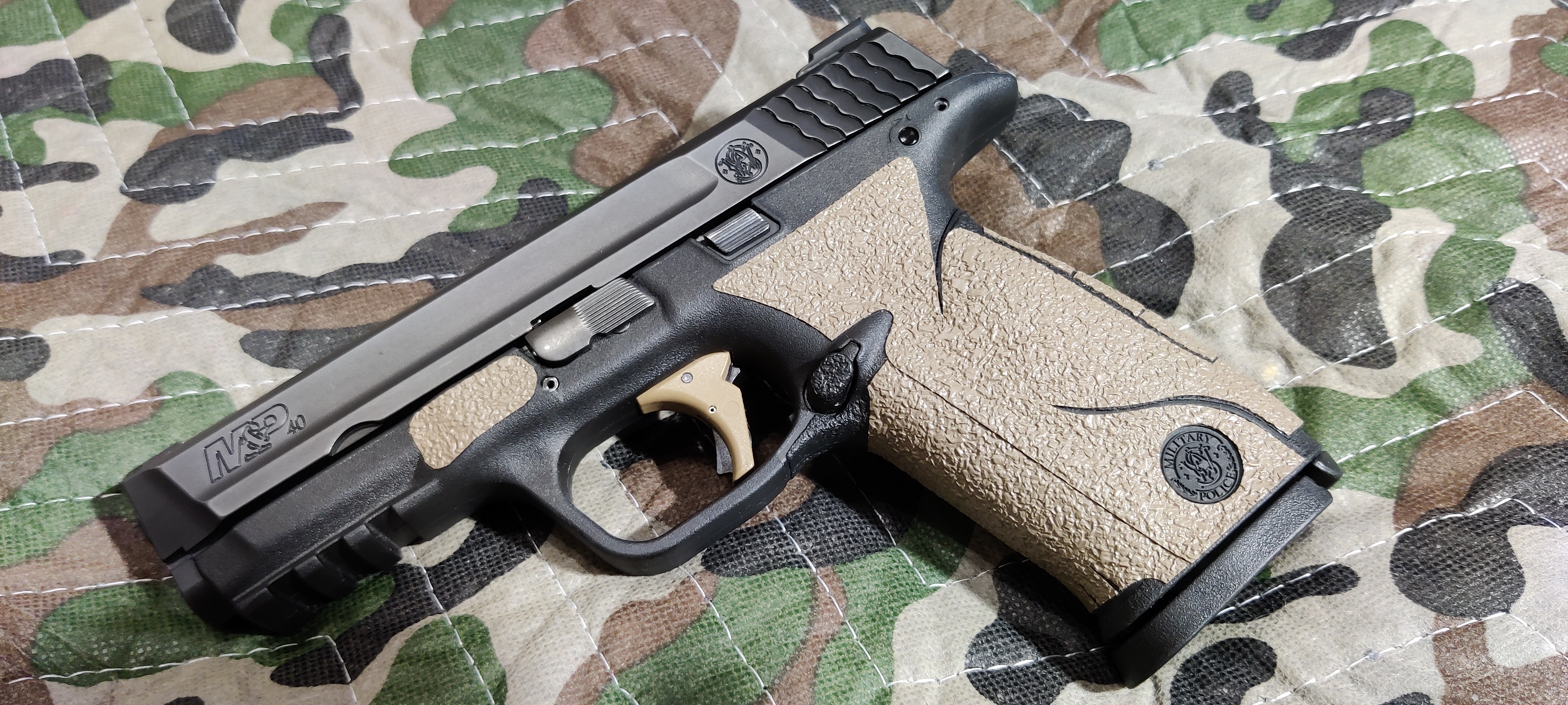

Ahh, Feel So Good.
This trigger feels so good now. I was ordering an M-CARBO trigger kit for the wife's SCCY CPX2, and looking for more pandemic projects I decided to throw one in the basket for my M&P.40 1.0. I am so glad I did. No more squishy trigger feel. Breaks clean and crisp in the same spot every time now. You can't beat the price either. When I did the install I changed the actual trigger itself in the process, and looking around for it I found the M-CARBO trigger spring kits to be the best value out there. Also, the instructional videos on the M-CARBO YouTube cannot be beat, top notch. I also had the pleasure of getting to deal with customer service, and again top notch "Jamie". The CPX2 was also an amazing upgrade, and I will do a seperate review for it. I did a little review video and will include a link. thank you for your service M-CARBO, and keep doing what you do brothers and sisters.
https://youtu.be/B_N3F3Fihqo

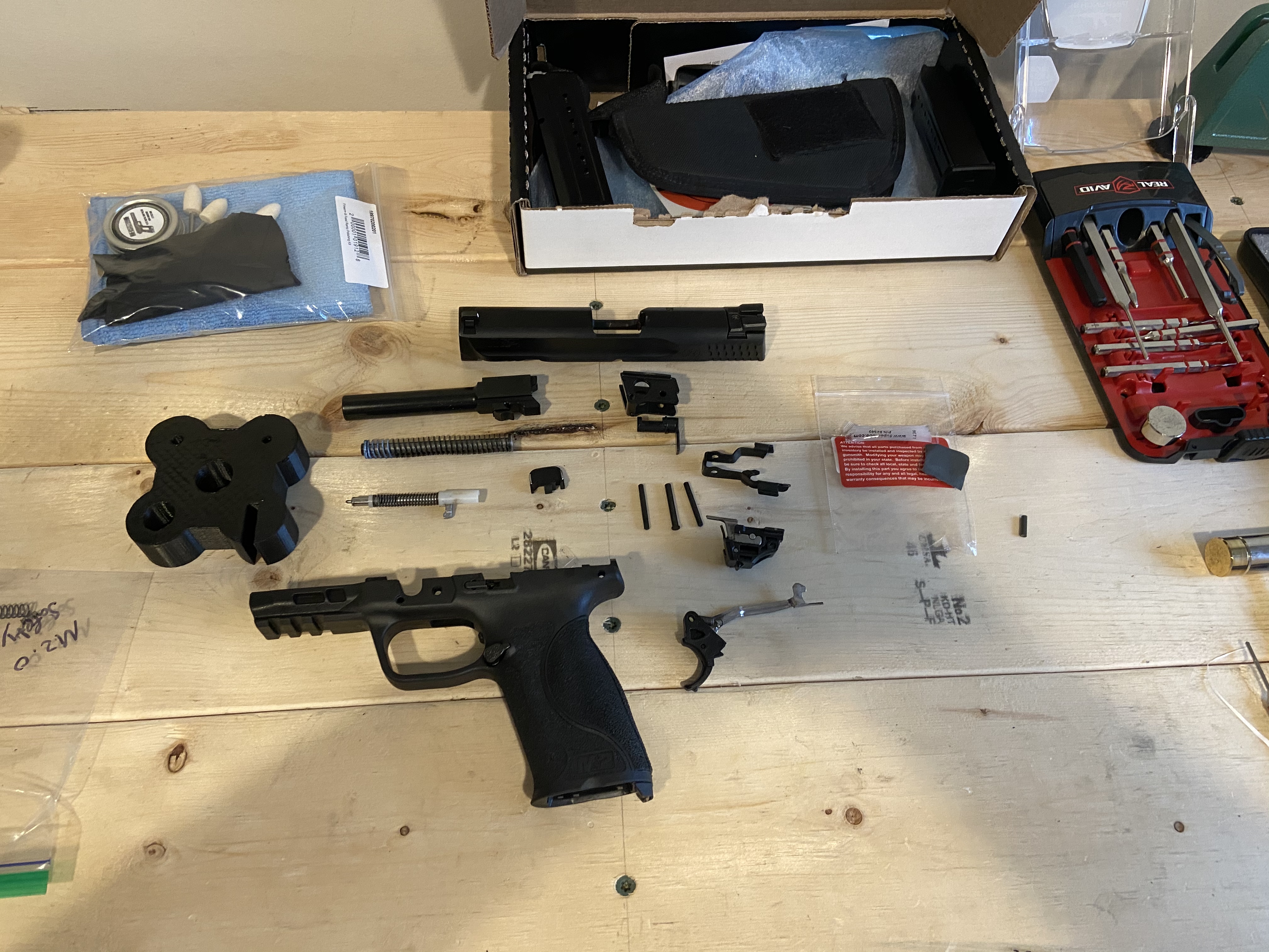

Bang for the buck
Got this trigger kit for a my m&p 2.0 in 9mm, got the polish kit as well followed the video instructions on how to do the work, removing the rear sight was the biggest chore, all the parts fit perfect, wasn’t any modification need to make anything fit, I do recommend to go ahead and get their nice bench block and the polish kit. This kit got my pistol down to a little over 4lbs. After the sanding and the polish work was done, the trigger feels 100% smoother than factory, it’s not an apex, but it’s also not $160 either. This is the best trigger you will find for $25 and some of your time, I use this gun for IDPA and feel this setup will add accuracy and hopefully shave some time. Thank you MCARBO for your products and most of all your service to the greatest country on earth! GOD BLESS!!!!
