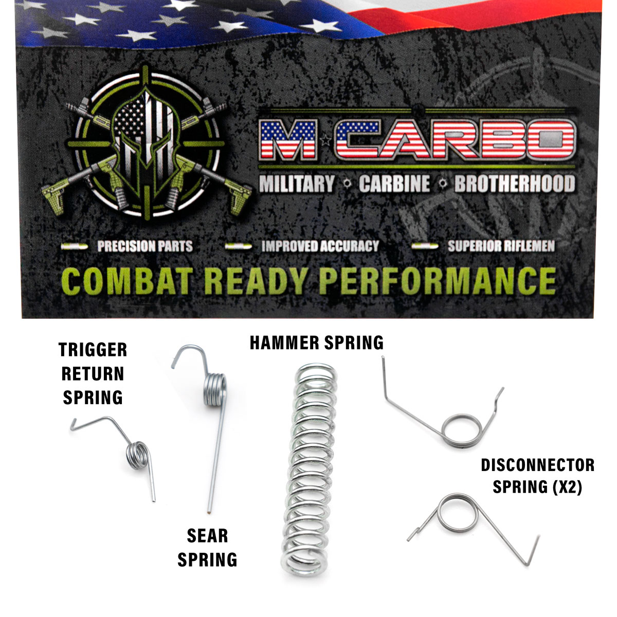

Labeled Marlin 60 Trigger Spring Kit - Hammer Spring, Sear Spring, Two Disconnector Springs and Trigger Return Spring
Marlin 60 Trigger Spring Kit (19962213434)
4.81 stars, based on 367 reviews
Marlin 60 Trigger Spring Kit Upgrade your Marlin 60 rifle with the Marlin 60 Trigger Spring Kit and experience a significant reduction in trigger pull weight from a factory weight of ~5.75lbs to a modified weight of ~3.75lbs. This trigger kit is...

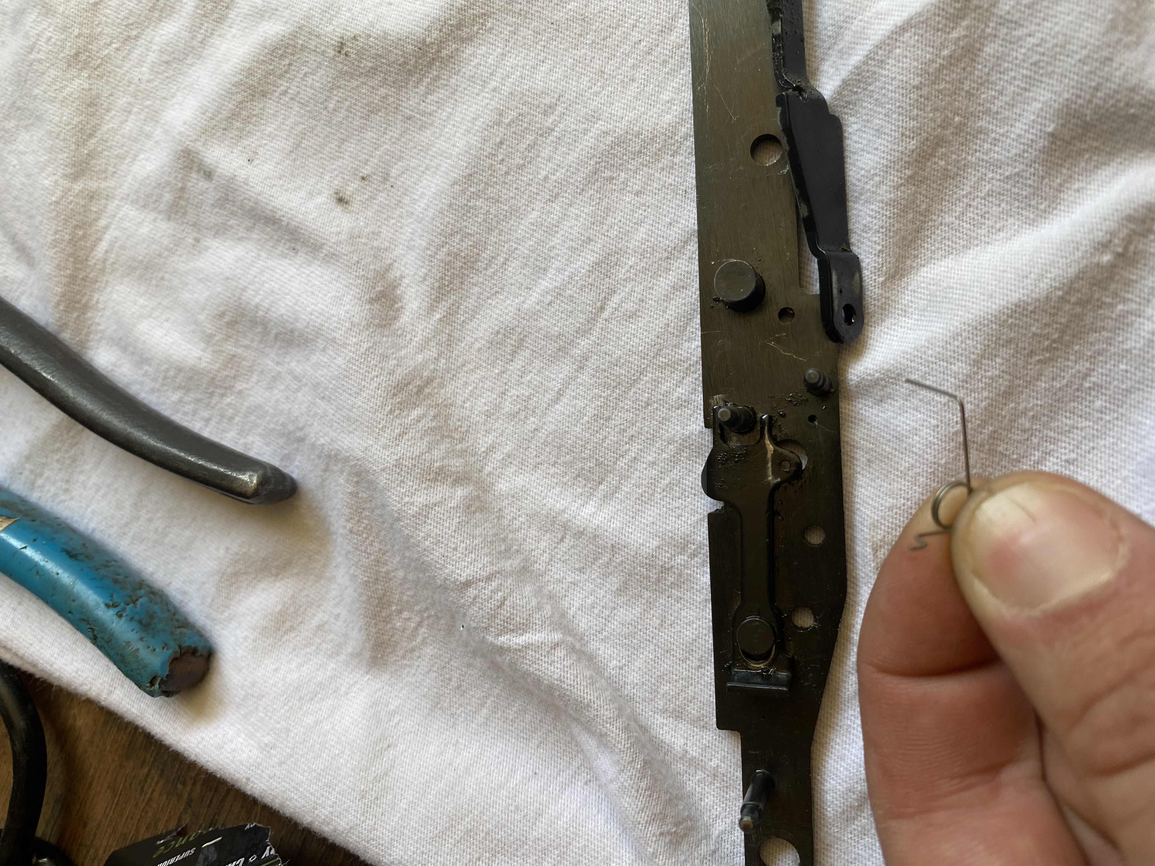

Bought this product because my old disconnector spring fell out of my gun bought this because I couldn’t buy another stock spring, after months of waiting and poor customer service finally got my package and the disconnector springs are bent in the wrong direction, tried to fix it and the first one snapped,very disappointed waste of my money
