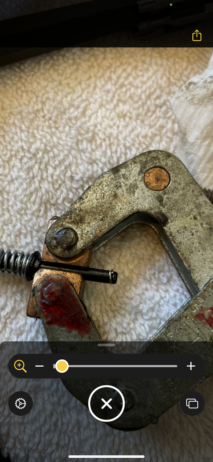

Now if you guys could just do something about that damn wire loop. I found clamping the spring down with a small set of needle nose vise grips, padded or pad rod. It allows you to work on it with both hands instead of trying to figure out how to hold a spring with one and pry a wire with the other

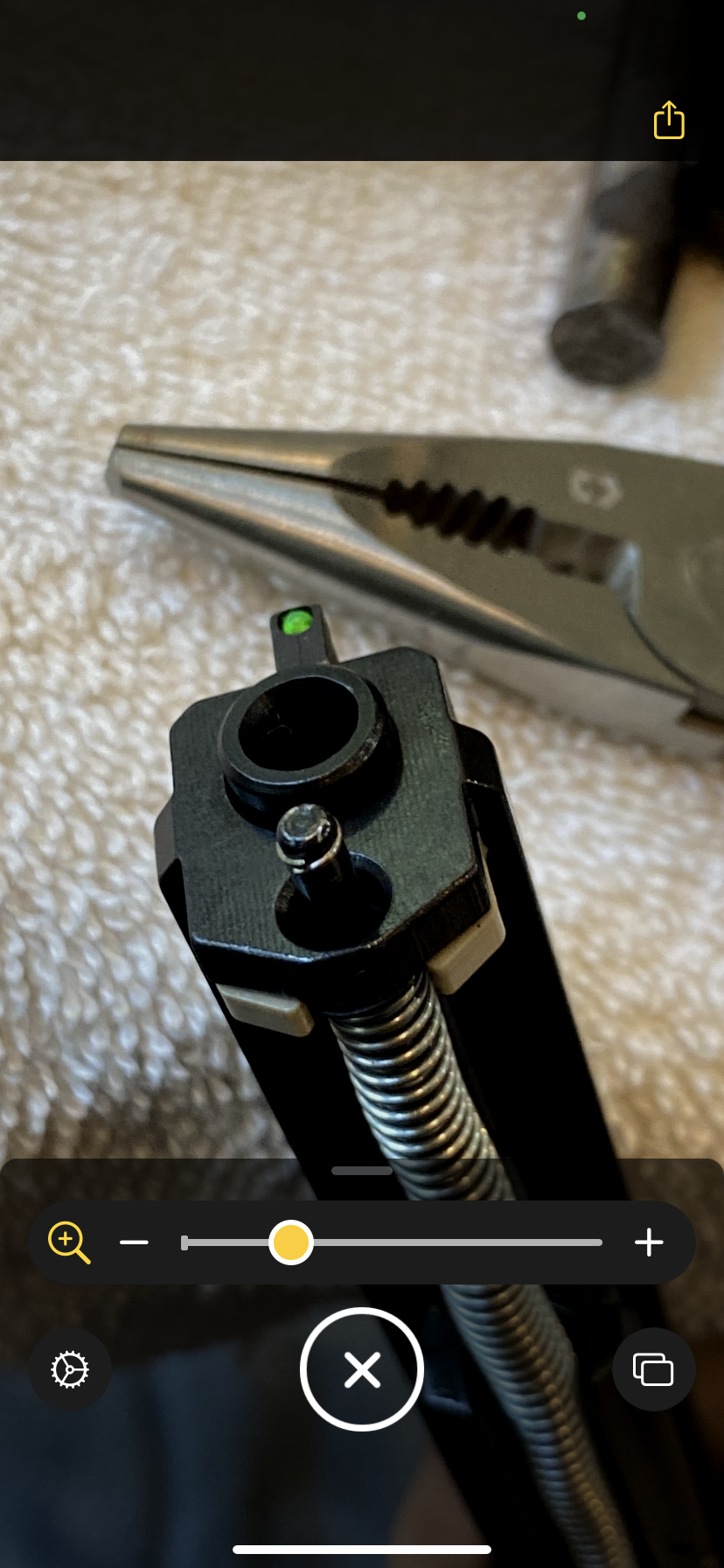

Warning if you dont have excellent hand strength, you might want to use a small vise or something else to hold onto the spring. That little damn ring is a pain also to get open and off. After that I ended up reusing the factory ring because the new one supplied with the new springs seemed very tiny and thin.

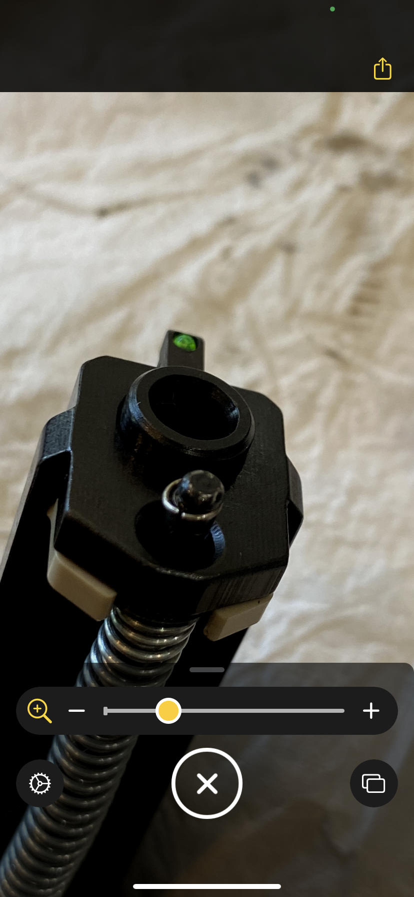

Guide lock ring too big had to cut it down
I received my spring and guide lock ring with the complete kit. Watching the installation video and following along with the install got to the point of applying the guide ring. Mine slide on with finger pressure as a complete circle. When I released the pressure on the new springs they pushed up on the retaining cap and lodged canted. With the spring half in the recess and half out. Since I ruined the factory ring in preparing for the new install I had to overlap the new ring in the recess and cut the excess with a slow rpm thin Dremel cutoff wheel. It wasn’t just a little oversized, it was nearly big enough to slide completely over the rod.
